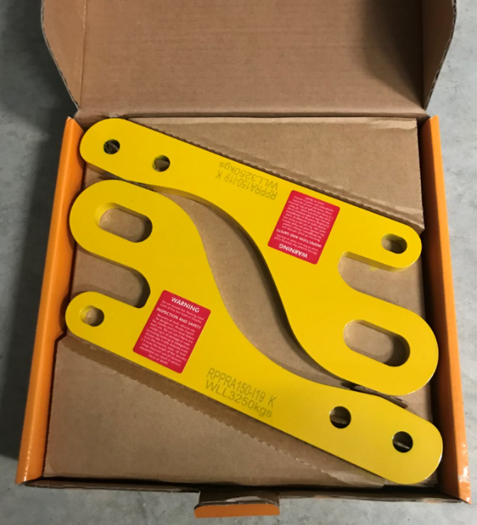

              Roadsafe recovery points arrived today...
              Hope to get time this weekend to install...
                Good job, a very economical solution as well as quick and easy to install

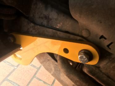

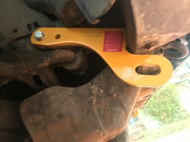

                  Mine on an ARB Deluxe Bar.
ID:	749030Click image for larger version
                    Nice. I have the same bar, and was thinking I'll be needing to cut the side plates to fit, but looks like the recovery points fit around it...
                    Thanks for pics...
                      Yep, they fit like a glove, you just have to be careful with which chassis holes you use, it's easy to get tricked but if you follow the pics you won't have any probs. It was almost too easy.

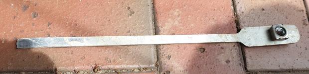

                        I went to install these the other night when I had an hour free, but when I loosened the top bolt, it rattled loosely like it would fall into the chassis once the bolt was out? Is the top nut captive enough to stay there whilst I take bolt out, fit rec pt and then put bolt back in..
                        I didn’t want to remove the bolt completely and have the nut fall into chassis meaning I have to remove bull bar to be able to get into chassis to bolt it in again?
                        especually when I needed to have the car mobile again a few hours later..
                          No, the top nut is not captive (the bottom is captive and attached to the chassis).

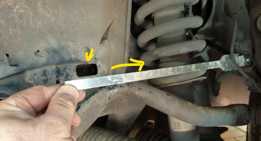

                          On my ARB bullbar, the top nut was attached to a long metal bar as shown in the first photo below. It drops into the chassis when you undo it.
                          I used a magnetic pick up tool purchased on Ebay (see link) to pick up the metal bar after it fell into the chassis. I then brought it up to the hole in the chassis (see Photo 2) and grabbed it with a pair of needle nose pliers.
                          I couldn't get the nut-end out of the hole (couldn't get enough twist) so I used a 2nd pair of needle-nose pliers to slowly feed the metal bar up the chassis (towards the back of the car as per the 2nd photo yellow arrow) until the other end of the bar (without the nut) was at the hole in the chassis. I was then able to leverage the smaller end out of the chassis and pull the rod out. (My photo illustrates how far back you need to feed the bar - of course, in practice, the bar is INSIDE the chassis rail when you're trying this!)
                          Definitely get the magnetic pick-up tool and two pairs of pliers first - it was reasonably easy once I worked out how to do the first one - about 30 minutes per side to fit each recovery point.

                            Cool. Thanks for the detailed instructions. Might give it another try on the weekend
