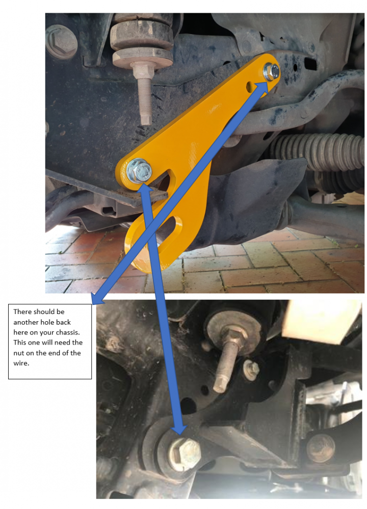

        Thanks Prado the 2nd - I attach a couple of photos - one showing the bar and the other showing where the bar attaches to the chasis

          I don't think you need to remove the bar. I don't have a photo of my drivers side recovery point. My photo is of the passenger side (ie: mirror image) but from memory both sides were near identical. I am fairly sure you will find that the front mounting point that you need is the lower bolt on your Toyota bar (see image below). That hole is threaded so you can just remove the bolt. Do one side at a time so the bullbar doesn't move. Replace this bolt with the longer ones supplied with your recovery point.
          The 2nd mounting hole is further back on the chassis rail, which is not shown on your photo, but will be just off your photo at the top left. I've tried to indicate this in my diagram. This hole is not threaded, so you will need to use the "nut on the wire" which comes with the recovery points. You feed the nut through the slot which is a little further back on the chassis rail (which you can see in my photo just to the right of the rear bolt).
          One issue you will probably encounter, however, is the recovery point won't sit flush. This is because the front section sits on top of your bullbar mount. I encountered this issue with my brother's FJ Cruiser with factory nudge bar. My solution was to go down to Bunnings and buy a few (for each side) of these square washers which I used to pack-out the rear mounting point.

                      I think those road safe ones will fit, you my just need basic creativity to adapt them.
                      I installed the same ones with my arb bar. Slight trimming of the bash plate was needed.
                      Prado the 2nd has given you some pretty decent instructions.
                      Those factory mounting brackets are not identical to the arb ones, but I think it will still work. The best thing about the recovery points is not necessarily the section you attach the shackle too, but the way it completes the triangle and braces the points back to the chassis.
                      For $150 I’d think it’s worth the chance trying.
