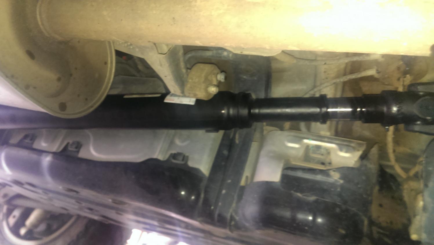

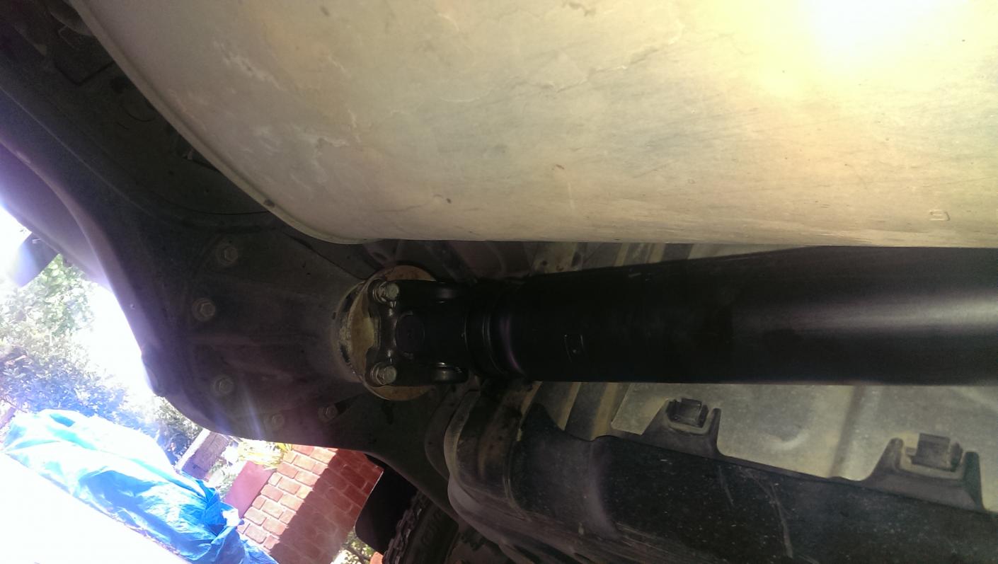

                        • New Shaft in, no clunking and can notice the difference....
ID:	645597Click image for larger version
                          Bernie
                          • Nice work bernie you will not have a problem with the clunk again!
