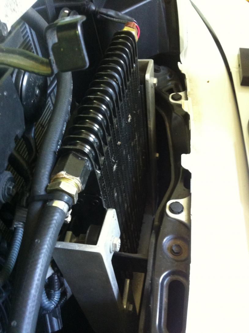

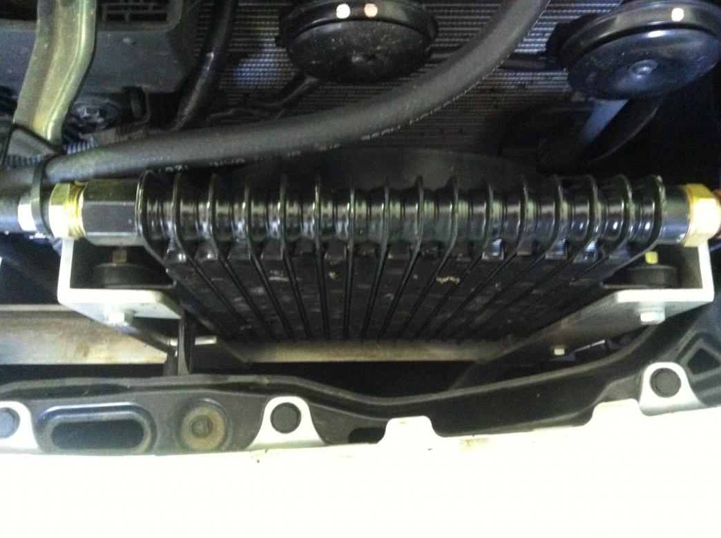

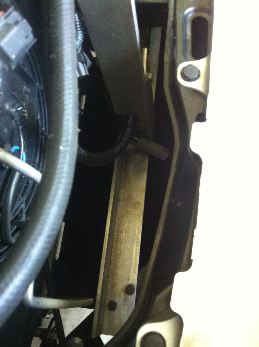

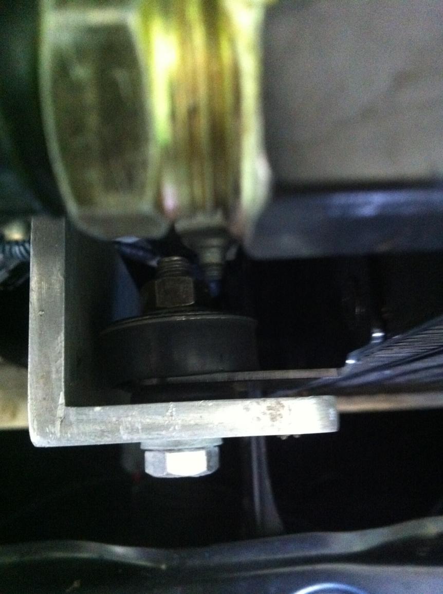

    I had my wagon on the hoist today so I thought I would show everyone how I fitted the B&M oil cooler to it.
    The mounting is bolted to the bullbar supports and is made out of 50/50/6 aluminium angle. The mount holding the cooler are valve cover isolators off "C" series Cat engines.
    I plumbed it from the trans then back to the radiator cooler. The cooler has a thermostatic switch set to turn the fan on the cooler on at 95C and off at 90c. With this set up we are seeing around 15/20c lower temps
    Sean

      What model of B&M cooler did you use?
        Here is a to link to Summit racing.
        http://www.summitracing.com/parts/BMM-70297/
        I changed the temperature switch to a 95dc on and 90dc off. If you want to change the switch the instructions state the wrong thread size. The cooler is actually 18X1.5mm threaded
        Sean
