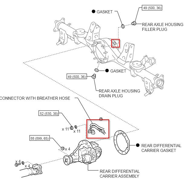

                Hi all,
                Sorry, newbie here, but interested in this thread as I am in the process of extending the breathers in my Prado.

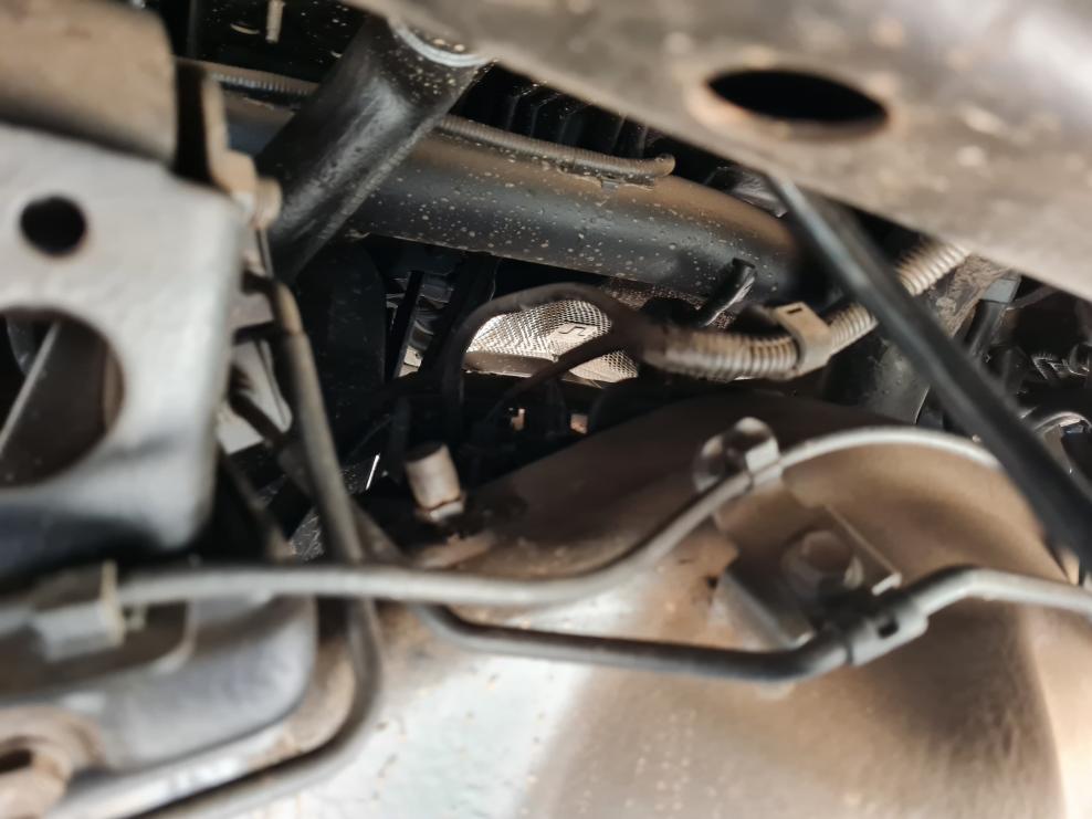

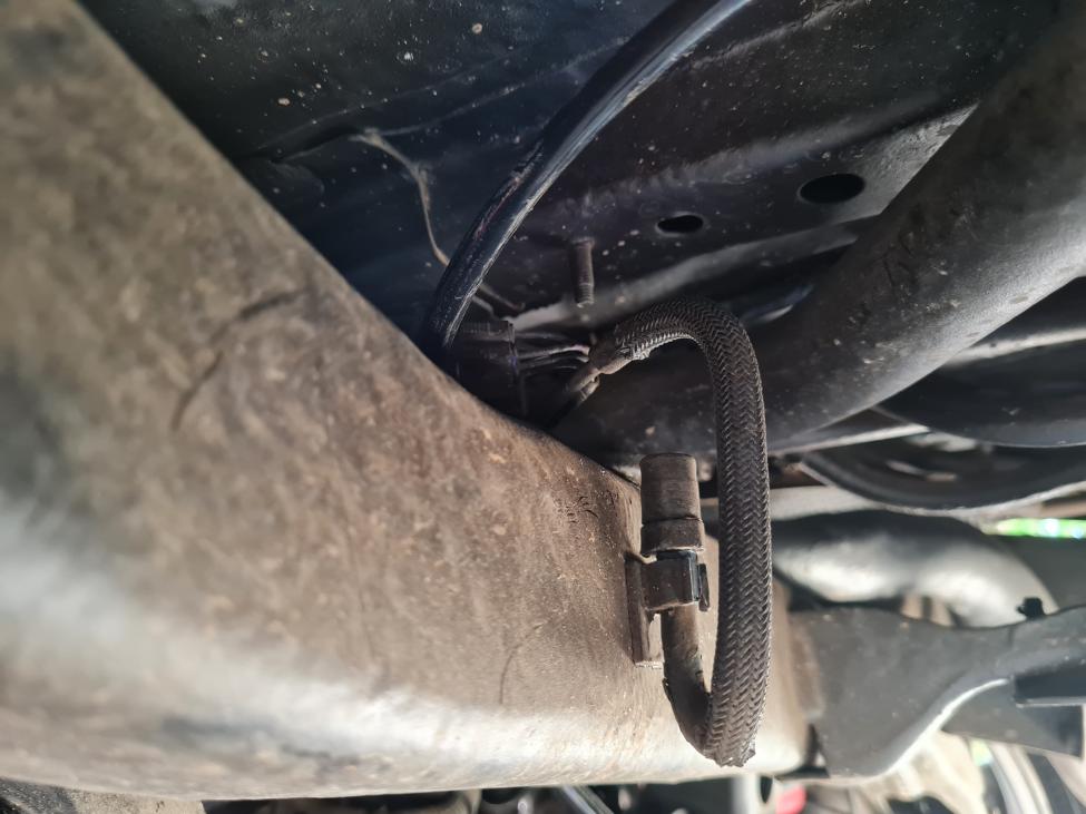

                Re the rear differential, I can see 2 breathers. 1 is mentioned directly in the service manual (see picture - lower red box), but the second (the breather mounted directly to the diff housing) is not mentioned in the service manual at all that I can see.
                I take it that the breather mounted directly on the diff housing needs to be extended (I plan to run it into the chamber where the jack is housed), but does anyone know the purpose of the second breather (that has been extended away from the diff assembly by a hose mounted to a cross member, but not really raised much at all).
                Any advice appreciated.
