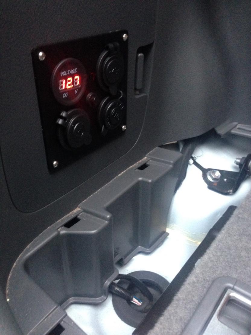

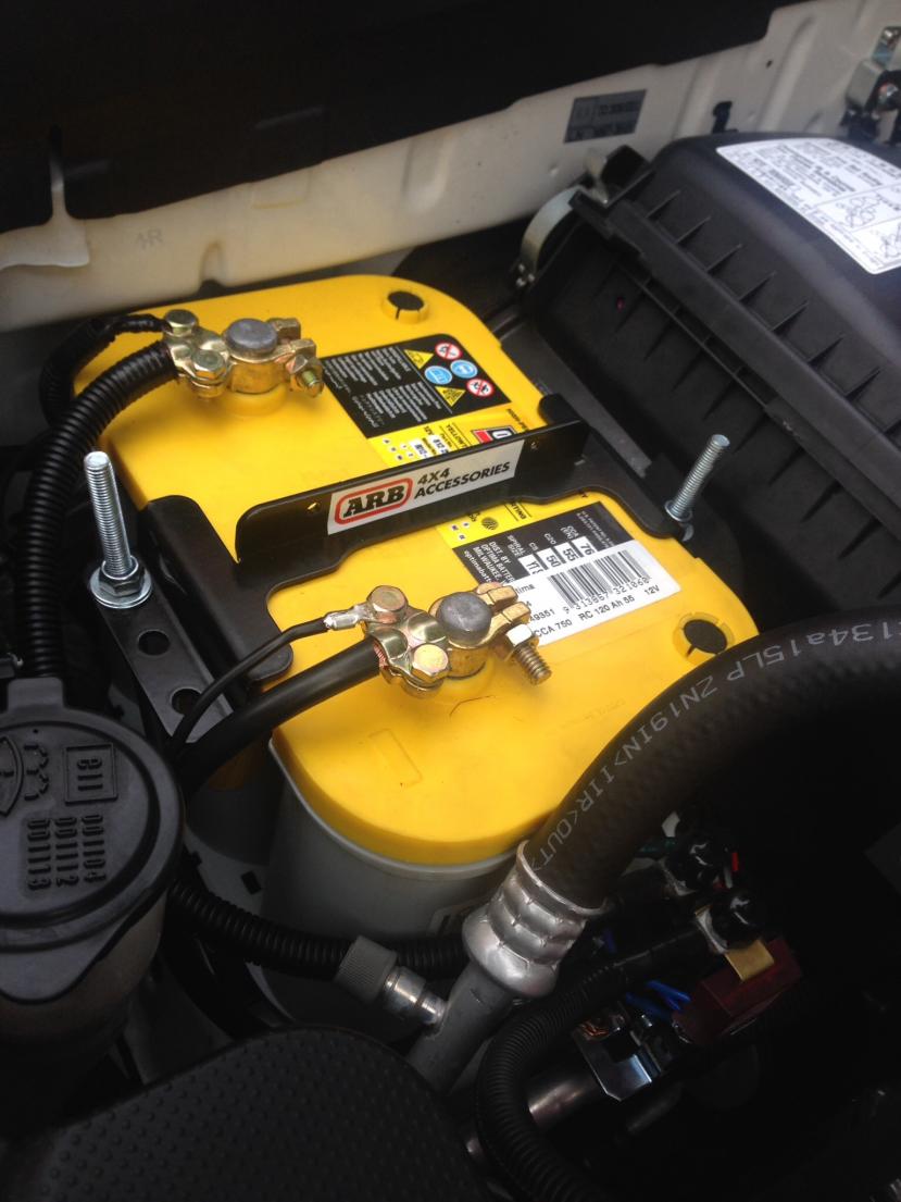

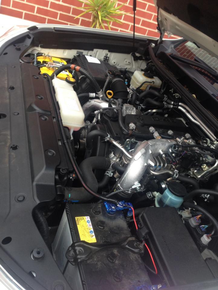

Thanks for all the info available on Pradopoint. I have just had my dual battery sytem installed. Supplied and fitted myself Optima D34 (tight fit but misses AC hose), ARB battery tray. Bought from Home of 12 volt in Adelaide Redarc SBI12 & power point plate $59 (12 volt battery gauge, dual sub, cig and engel plug for fridge). Don't like mucking with auto electrics so got local guys who've been around for 50 years to do the install. Connected batteries across the top of radiator as per Euro prados, wiring down lhs chassis rail to rear tow bar, fitted Anderson plug and everything else. Did a great job, neat, easy to see where everything is, total cost $1226. ARB quoted me $1500 with no Anderson plug. Got a Lightforce LED lightbar installed at same time, the 20 inch single row combi, fitted to OEM nudge bar. Don't need original high beam the light bar is so bright. All up, very happy. Couldn't have done it without info from Pradopoint.2012 Crystal Pearl Prado Altitude 150 Diesel Auto. Toyota mats and rear rubber mat. Toyo Open Country AT2's 265 65 R17 LT. OEM nudge bar. dual battery set up with Optima D34, rear power points front and rear Anderson plugs. Lightforce LED combi light bar. Kingsley side steps. Outback Ideas recovery points. Dr Air Pro 150 ltr air compressor. ARB 60 ltr fridge. GME 3550s UHF radio. Hema HX1.

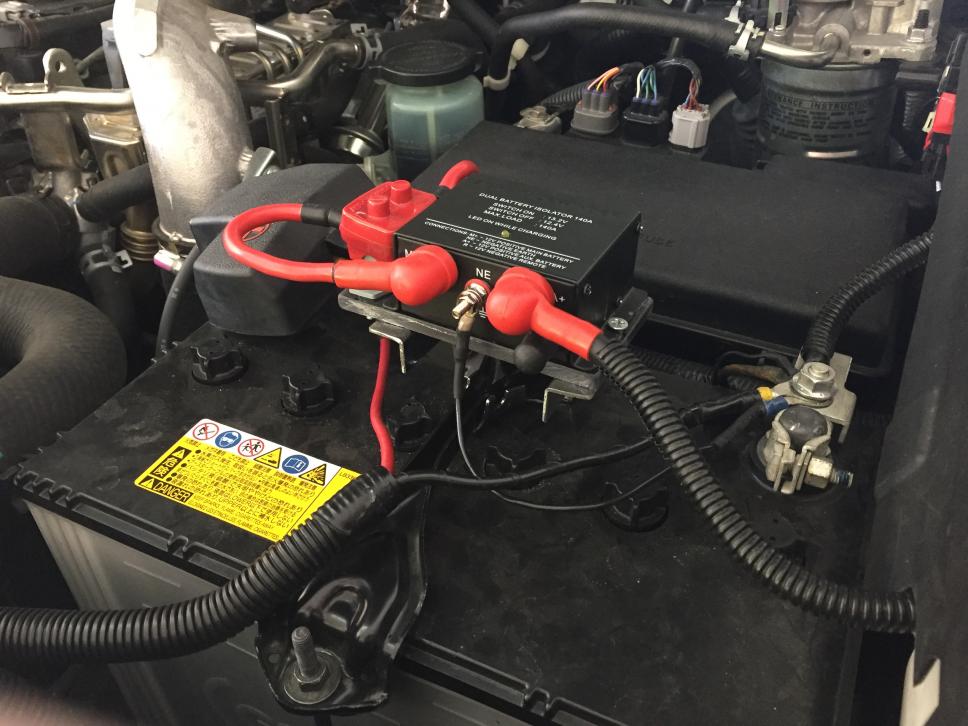

I have installed the ABR sidewinder isolator to charge an aux AGM battery in the cargo bay and note it gets fairly hot (think cup of coffee) when the car is turned off but the led is still on, Derek has confirmed this is normal but I am a little concerned. Has anyone used a heat sink or anything to dissipate this heat?
I have installed it on a stainless bracket with a 6mm Perspex plate that is fixed to the tie down strap for the main battery so it is sitting just above the battery.2012 D4D GX White
Heat is wasted energy, I would buy another isolator.HKB Electronics, manufacturer of the Alternator Voltage Booster, Silver 2008 D4D,Lifted,Underbody protection, Alternator Voltage Booster, Tiger Z winch, Lightforce DL, Air Horns, Tanami Drawers, Drop down fridge slide, Outback cargo barriers, Rotronics dual Battery system, Polaris GPS, HF/UHF/VHF, Radio speaker combiner, Long ranger water tank, Diff breathers, Inverter, Snorkel and others
