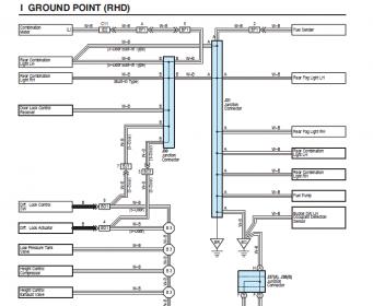

                      Hmmmm..... We're on a Prado forum, so I'll use a 1KD 150 as an example. The tail lights and rear electrical accessories are run to a body earth point in the rear, there are two body earth points under the bonnet and the dash loom goes too body earth point behind the kick panels. There is two wires coming off the factory negative terminal, one going to a body earth point (which no other wires are bolted to) and the other goes to the engine block (once again with no other wires). Every factory electrical component either uses a portion of the body or engine as their earth return or negative circuit.
                      Copper does cost money, it also adds weight so why wouldn't you want to use the smallest amount that remains effective? This goes for both the factory and any professional installer.
                      As for corrosion, it is an insufficient earth return circuit that causes that in most cases, that is why it is important to upgrade the cabling from the body to the batteries to a suitable size. Electrolysis is what causes the corrosion that you are referring to (as you know) and it is from current travelling through the cooling system, caused by a potential difference between the cooling system components (attached to the body and the engine). Adequate earths to both the body and engine will prevent this from happening.
                      I would love to know how much current you are drawing to melt a fuel or brake pipe? What battery can supply this current without overheating itself? What charging system can keep up with this current draw? How is the current directed through the brake pipe (was the earth cable lug bolted to the brake pipe clamp)? Electrons flow through the path of least resistance, you would have to have to be flowing a lot of electrons before that became the path of least resistance to the alternator.

                        You'll also note if you look at the wiring schematics they show all electrical devices being connected to their appropriate earth points in the earth loom. You'll find if you look at that earth point in the rear that it will also have the earth loom connected to it.
                        https://www.hkbelect.com/uploads/pro...th%20point.gif
                        Brake lines, fuel lines are tubes, not solid copper and your assuming there is another earth return to share the current. In the cases quoted devices were grounded to metal work that was only grounded through the lines, it was assumed the body work would make a good conductor, it didn't!
                        Yes corrosion caused by stray currents, stray currents are usually caused by people
                        using the chassis/body work as an earth return!
                        The body is earthed to prevent difference of potentials and stray currents occurring, not to allow it to be used as an earth return. Earthing the body also allows it to act as an earth screen to reduce RF problems.
                        As I wrote if it was ok to use the body as a conductor you wouldn't have the earth loom!

                              You are talking about manufacturer's earth points designed to carry no more than about 10 amps.
                              This thread is about an auxiliary battery set up where currents can easily exceed 60+ amps.
