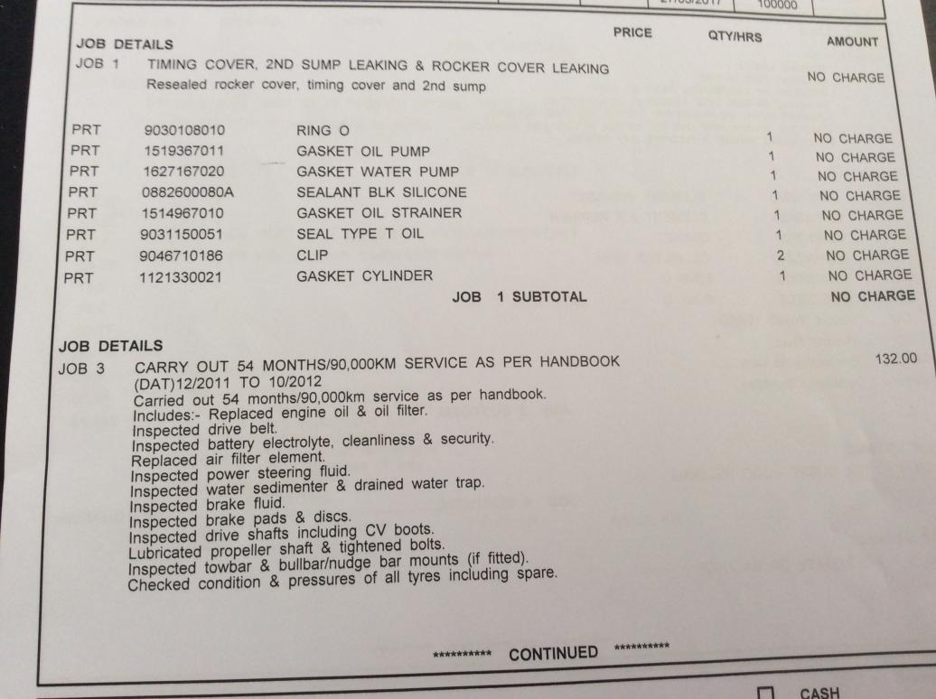

        Guys, just had the oil leaks done. Leaks on rocker cover, timing cover and 2nd sump. Have only done 57000 km with no had work. Regularly serviced as I am under extended 5 year warranty. Dealer has just done 54 month service, 1 day for service 2 days to fix leaks. They told me they allow 14 workshop hours and would've cost me $2000. They actually have to lift the engine out to do the work!
        Lucky there was no charge under the warranty. Dealer has been pretty good, no arguments or hassles. Details attached.
        This is leaving me pretty concerned that there is a problem with my engine. Do others think this might be the case?
        Is this a known problem with the 150 series 3.0 Diesel engine? Have heard from others with older prados that they had had this issue. $1200 extended warranty has paid for itself.

          What the hell is the "2nd sump" never heard that before. I also find it hard to believe that they lifted the engine out to do the work, may be wrong but that is a hell of a lot of work if they actually had to.

              Maybe they'll disconnect the engine from the transmission because they're going to replace every gasket on the engine just incase some more are about to let go.
              Never heard of a second sump unless they meant transmission sump. There will be no long term probs from small rocker cover oil leaks, or larger ones so long as you keep the oil up to it if it chews through it. There will just be a little bit of a mess from the leaks but the dealership should degrease it all during the repair anyway.
