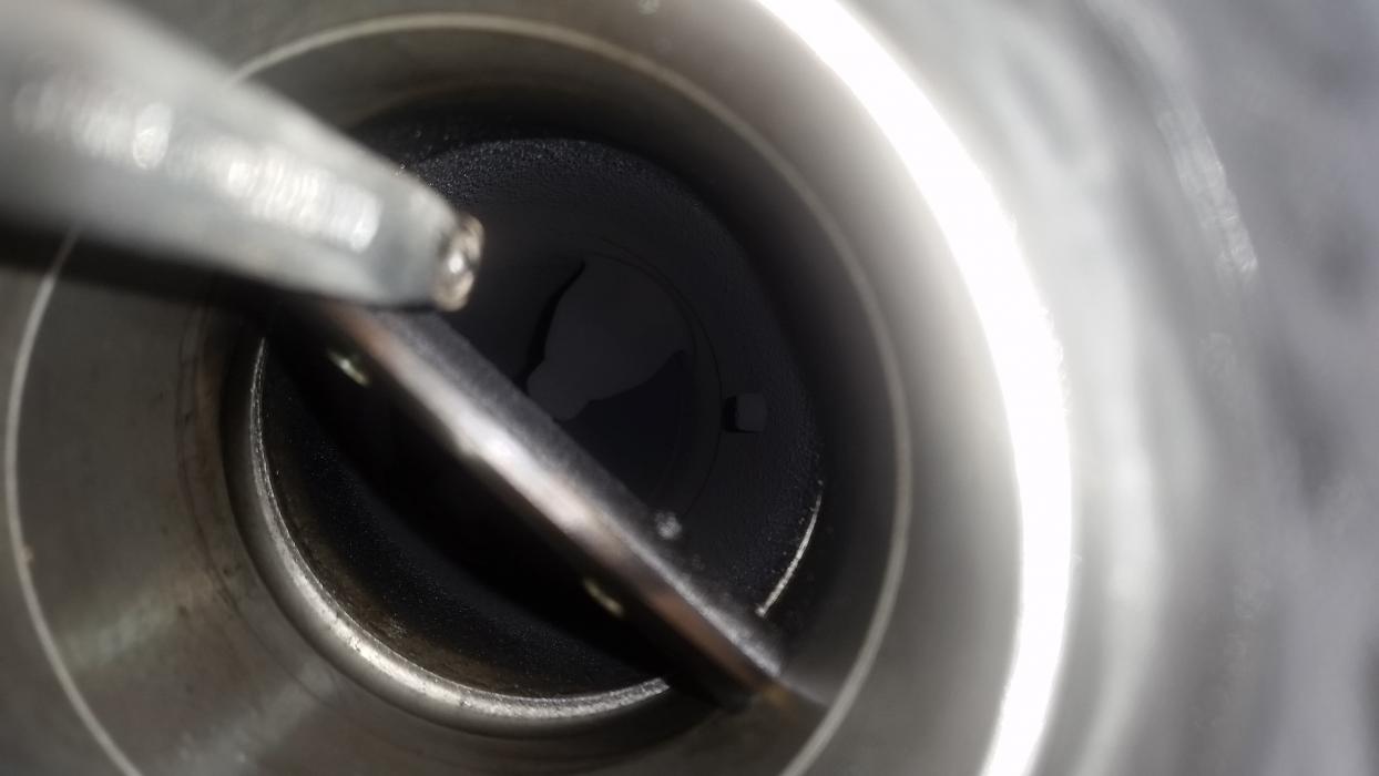

    As I said earlier, I had already had a look inside the throttle body and noted that there was allot of oil and carbon build up.
    From the front - https://i.imgur.com/NspmBKy.jpg
    From the back - https://i.imgur.com/2Sazda3.jpg

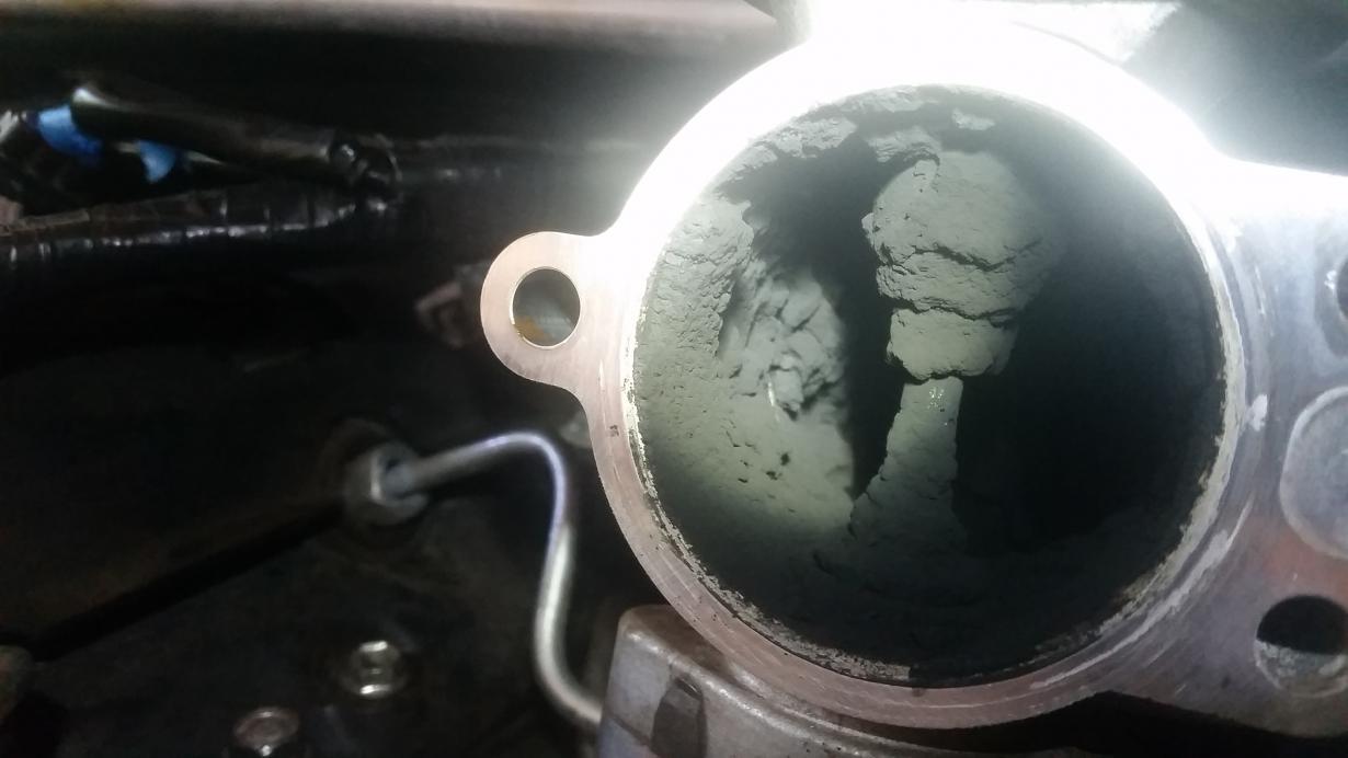

    This is where most of the articles I read stopped. I can see why, but it's only half a job. Yes this is where it gets allot more complex, but still, half a job is half a job.
    I had seen a few manifolds in different articles so I was expecting something bad. I was still shocked though.
    It's not as bad as i had read about, but still. :-x
    The Clean
    It was caked full of carbon and toward cylinders one and two there was this thick oily grunge that was the equivalent of diarrhea and grease having a love child during a bad acid trip. Most ports were about 15-20% blocked into the head. There were large clumps of carbon built up and number one port was about 25% blocked but that oily mess was something else. It felt like super glue that was about to go off and stuck to everything leaving black residue that was next to impossible to get off.

                      So it's been 30k km's since i did the clean. I took a few bits of the intake apart this morning and took a photo down past the throttle body.
                      It's blackened and there is a slight trace of oil still with a very minor layer of soot over the EGR valve.
                      When you consider what it looked like before and now. I'd be pretty confident to say that the catch oil is preventing build up.
                      Hope that helps.
