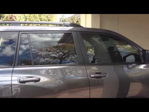

              Show them this video. My gxl must have a malfunction
              this is an april built / july delivered 2012 GXL d4d
              Vk3bq
                Great idea!
