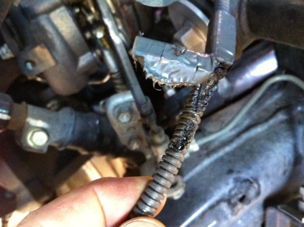

    I had the Turbo unit replaced under warranty back in June. Had code P0048 come up in September.... why? because whoever did the work didn’t clip the VNT motor cables back into place, causing the cable to sit on the exhaust/dump pipe..... eventually melted the cable shield and insulation and shorted the wires out. I found this two hours West of Charters Towers, luckily I was able to access it through the driver side wheel arch, cut all the burnt crap off and re insulate with tape and cable tie it back up. Also found a bolt missing from a bracket on the intercooling piping, that holds a bracket on for the wiring harness to clip into.

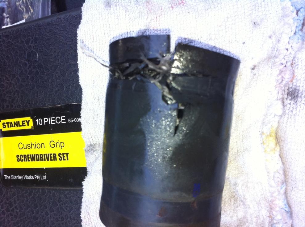

    Drive back from the NT (got back Tuesday 13th) and on Monday afternoon nearing Townsville I can hear a slight whooshing noise on acceleration. I baby it home (I have an idea it’s a boost leak) and this morning get a competent mechanic to look and take the turbo to intercooler pipe off and find the coupling is stuffed. Looking at it I am of the firm belief it was damaged when the turbo was replaced, why else would it fail?
