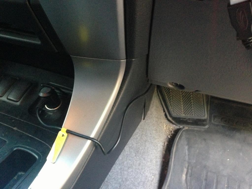

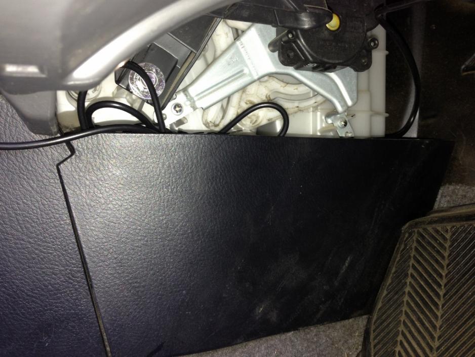

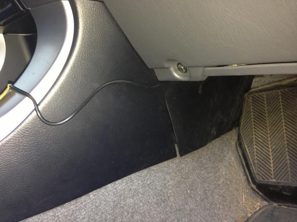

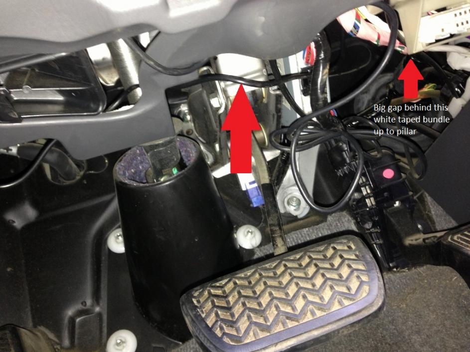

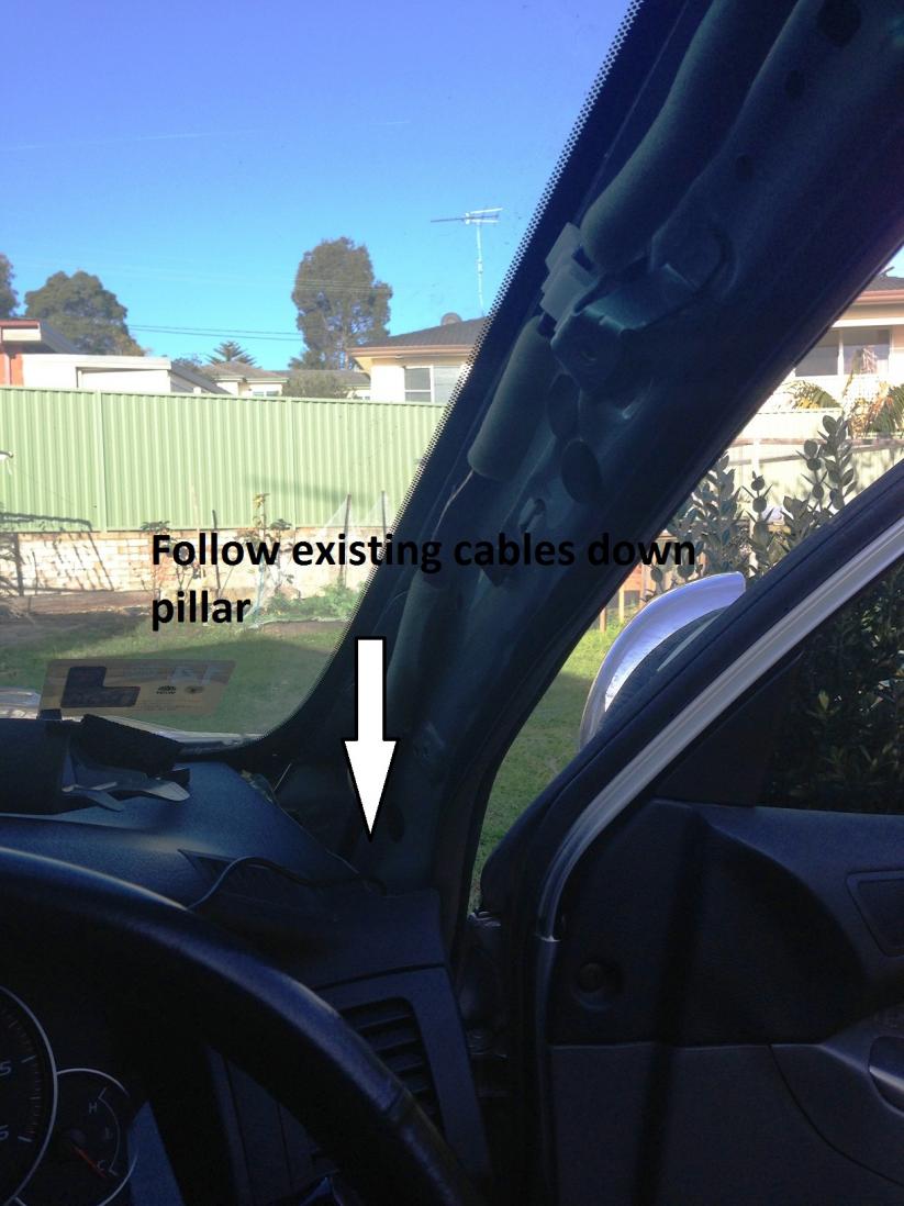

          I went down the pillar into the footwell. Just follow the existing cable path. You can get your hand up toward the pillar when feeding the cable through. I found it easier to double the cable over and push the loop down, then pull the adaptor through from the top, leaving the camera plug up top. I first tried to feed the cig adaptor down and it got trapped for a few heart stopping minutes, but it came loose with some judicious jiggling.
          Come out near the accelerator pedal and feed it along behind the trim in the footwell to the centre console.
Name:	IMG_0567 (1024x768).jpg
          Then cable tied the excess tucked up behind the drivers footwell panel
Name:	IMG_0556 (1024x768).jpg
          Just looping around the front into the power socket because eventually I'll follow Stevejau's example, and go through the bulkhead into the engine bay and connect to my Aux battery. I couldn't be bothered fiddling with the trim at this point.
Name:	IMG_0527 (1024x768).jpg
