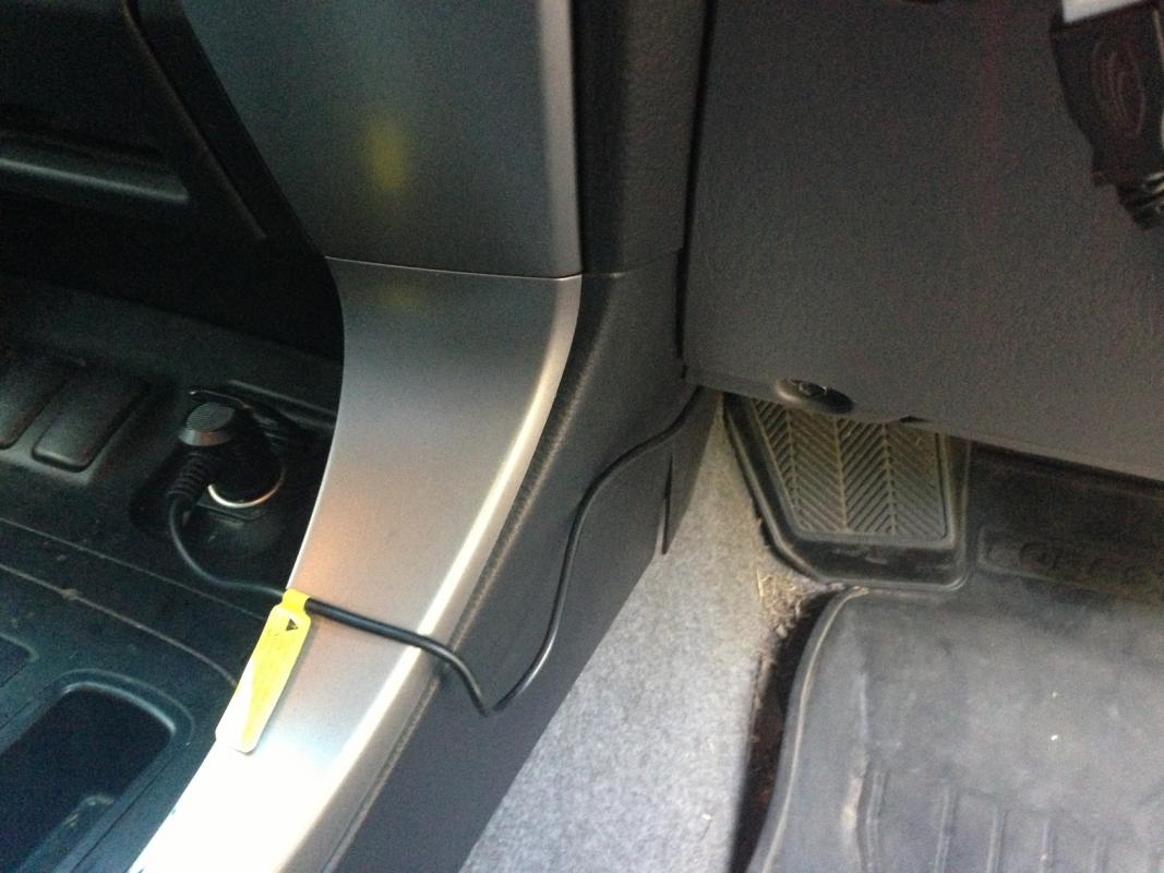

                      I copied SteveM's install (mostly) Let me know if you want some photos, not sure if yours is the same. Mine's a 120.? Run cable along roof lining, down behind drivers pillar trim (two bolts to remove it), pass cable through gap into footwell (unlike SteveM I didn't remove the footwell trim, I found if I doubled the cable over I could thread it through the gap and then pulled the cig adaptor through. ) I ran it behind the trim to the power outlet, and just cable tied the excess and hid it behind the drivers kick panel.
                      At some point I'll run it to the aux battery for permanent power so I've left the final section exposed - Steve ran his behind the trim.
