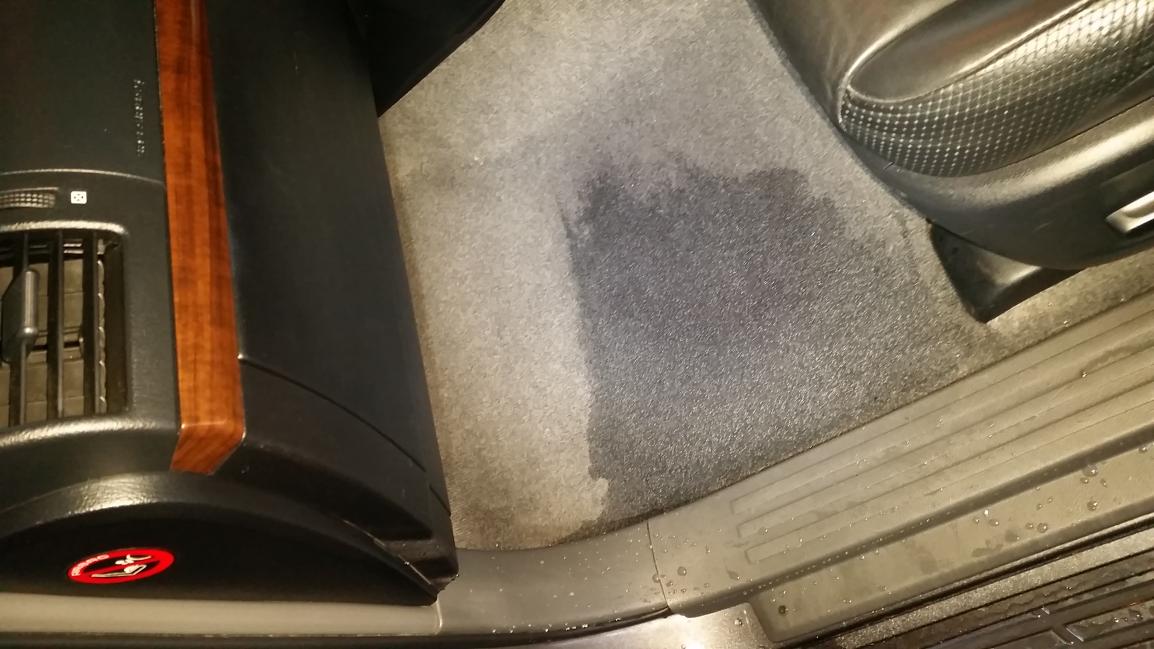

Okay, so it's been pretty wet up here is Brisbane, and after the Kaka sat out in the rain for 8hrs while I was at work (heavy rain all day) I returned to find the front passenger floor soaking , with water still dripping down over the speaker!!

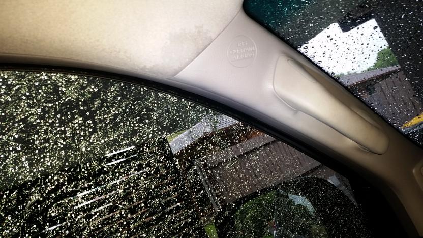

At first I thought maybe a dodgy door seal, nope all good, then I looked further and found that the roof lining was wet near visor and along A-piller!! MOONROOF!!! So, as it was still pouring, I had to drive home to investigate further,, It seemed to stop dripping when driving.
