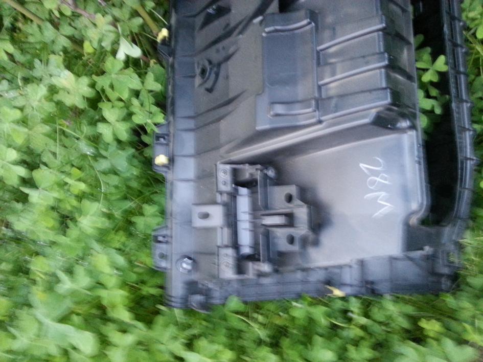

              Thought I'd share the answer to save anyone else trying to do this some time. You have to remove the plastic glove box shroud because the card holder is screwed in from behind.
              Pretty simple 20 minute job. Sorry for the blurry photos.

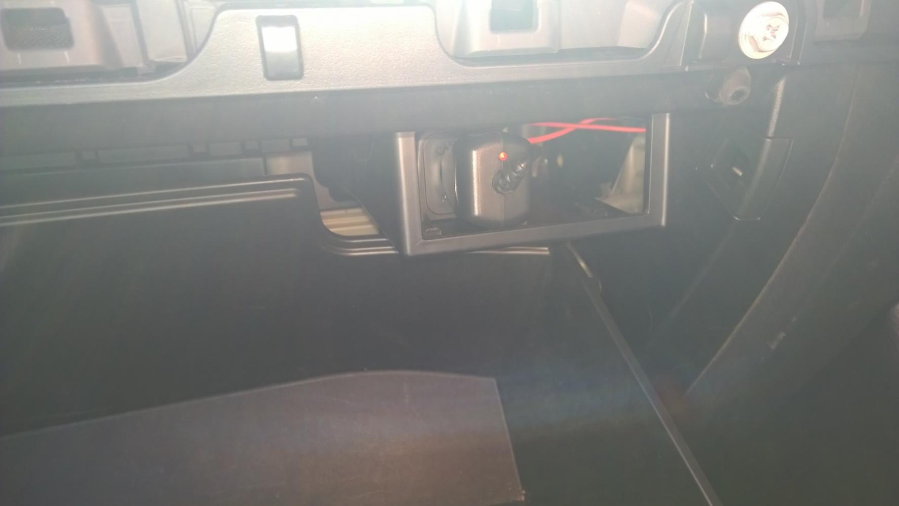

                      I removed my card holder and installed a 12V socket, into which I have plugged my dashcam. No more cables in the cabin!!!!

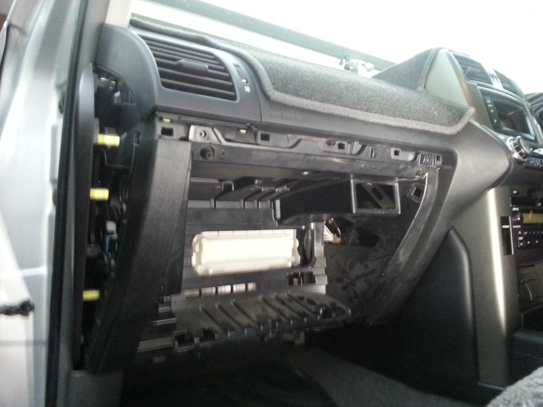

                      To remove the card holder and get access to the area, you need to remove the glovebox. I have posted instructions on how to do this in another post:
                      http://www.pradopoint.com/showthread...l=1#post485802
                      There are quite a few resources here explaining how to wire up new 12V sockets. For just a dashcam, easy enough to just tap off one of the existing ones. The one on the REAR of the centre console (in the 2nd row) is easy to access.
                      In my case, I ran a new relay circuit, because I also installed another new socket on the centre console (near the 4wd controls). I trigger the relay from the ignition, which I picked up from the 12V socket on the rear of the console. Happy to provide more details if anyone wants to know how.
                      For the dashcam cable itself, I ran this up the windscreen and just pushed in under the roof trim. I then removed the left-hand A-Pillar cover (by undoing the two bolts on the grab handle), and ran the cable carefully down the A-Pillar, well away from the airbag. With the cover removed, there is a big gap behind the dash to run the cable. It then goes behind the glovebox and plugs into the new 12V socket in the Glovebox.

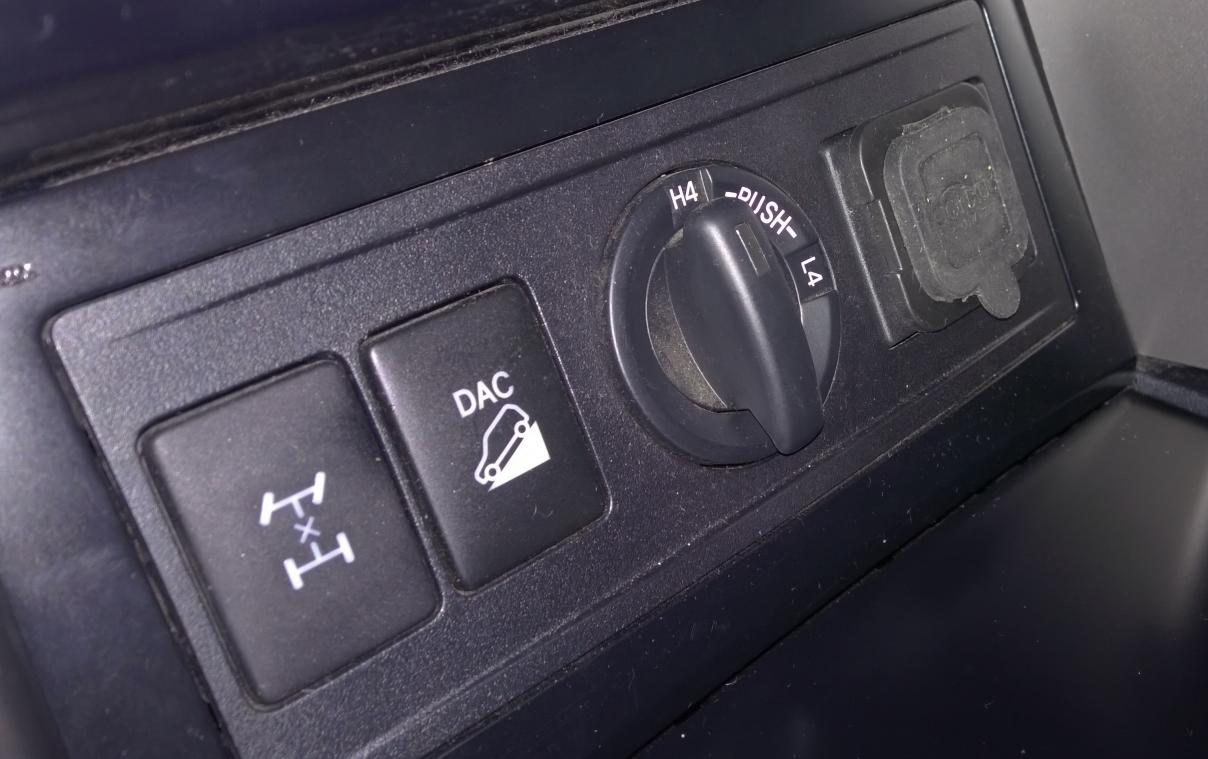

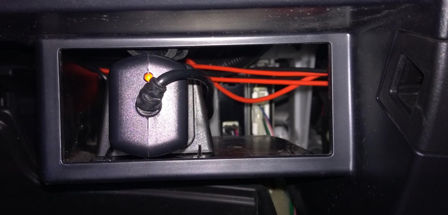

                                The socket is not very OEM like - perhaps just my tricky camera angle to make it look good. I've attached a couple more photos - one of the card holder socket, the other of a socket I added to the centre console. I picked up both parts at one of the 4x4 shows - something similar to this: http://www.12volt.com.au/redirect.ht...03/plugs2.html (scroll down to the Cigarette Socket Surface Mount section). I can try finding more details if you want.
                                In terms of the space for the Uniden UH8060, will fit without any issues. The fascia of the card holder is 40x98, but the space behind the fascia is considerably wider and over 150mm deep (up to about 180mm). You can probably see this in the photo. Don't forget to also calculate the clearance for the MIC cable - you might need to set the unit back a little more (but there is plenty of room).
