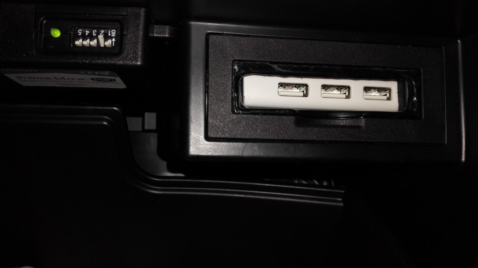

    I know this is older thread, but hope this might be helpful to others.
    I managed to modify the card holder and added a simple USB hub to enable multi usb input to the entertainment system. Now I can utilize the 2 USB sources to play music. I used the Belkin usb hub with some modifications to the card holder. I did not remove the card holder completely, but instead used it to hold the usb in place. I used this mainly to replace the usb from center console.

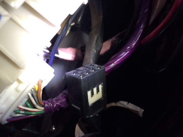

      Interesting...Japanese E Toll system..maybe this plug under the steering columnClick image for larger version
ID:	652378 is for that then?

                  electronic toll gathering framework/box/gadget. A few autos have them worked in, however most have them included a short time later. By and large these ETC boxes can be expelled with no evil consequences for the auto.
