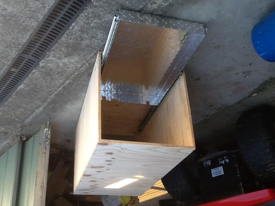

            Here is a photo of the fridge storage compartment I have made. Aluminium frame for the fridge on heavy duty slides. I like the idea of having my fridge in an enclosure rather than on an open slide so the I can pull the fridge out without having to worry about things falling behind the fridge. I'll eventually build up a full draw set like my next post will show. My challenge is to work out how to secure the rear of storage units so they don't tilt up when I slide out the drawers.

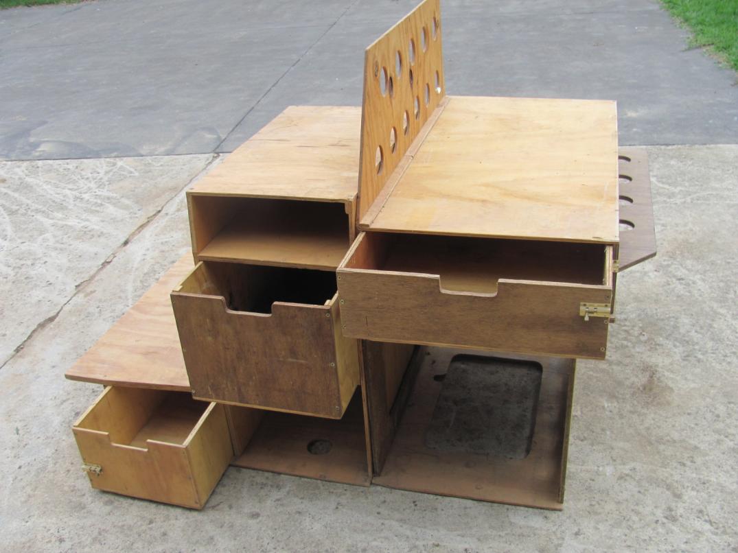

              rear drawers
              This set of drawers was from my 80 series Landcruiser. Took me about three days to make but I wanted to maximise storage. It had drawers for recov gear on left. Centre from bottom upwards was open area for stretchers and chairs, drawer for chainsaw, open area for stove. Right was open area for fridge and drawer for food. I was more than happy with the set up.
              Because the 80 had a drop down tail gate, I never needed to worry about a fridge slide and I just slid the fridge out on to the tail gate.
              The unit was in two halves. I could just install the right half if I was using the fridge and still have a large open section on the left of cargo area.
                Good looking box Rob. I've got a Drifta one (same as yours but carpeted) and is great for the exact reasons you said.
                Trev
