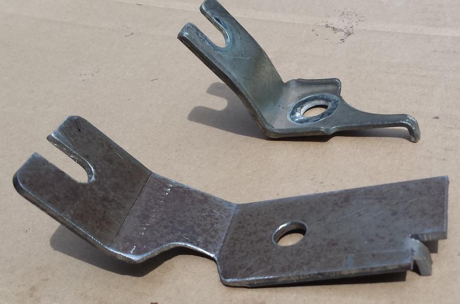

    The later body has all the linkages on the butterfly shaft instead of using an auxillary shaft. Consequently I had to make a new throttle cable bracket to move the cable closer to the butterfly shaft.
    The cruise control cable is also now too long so I will make a new bracket for that later.
    Just a heads up for 1996 owners.
      Attached is a fabricated throttle cable bracket for 1996 models to use later throttle bodies.
