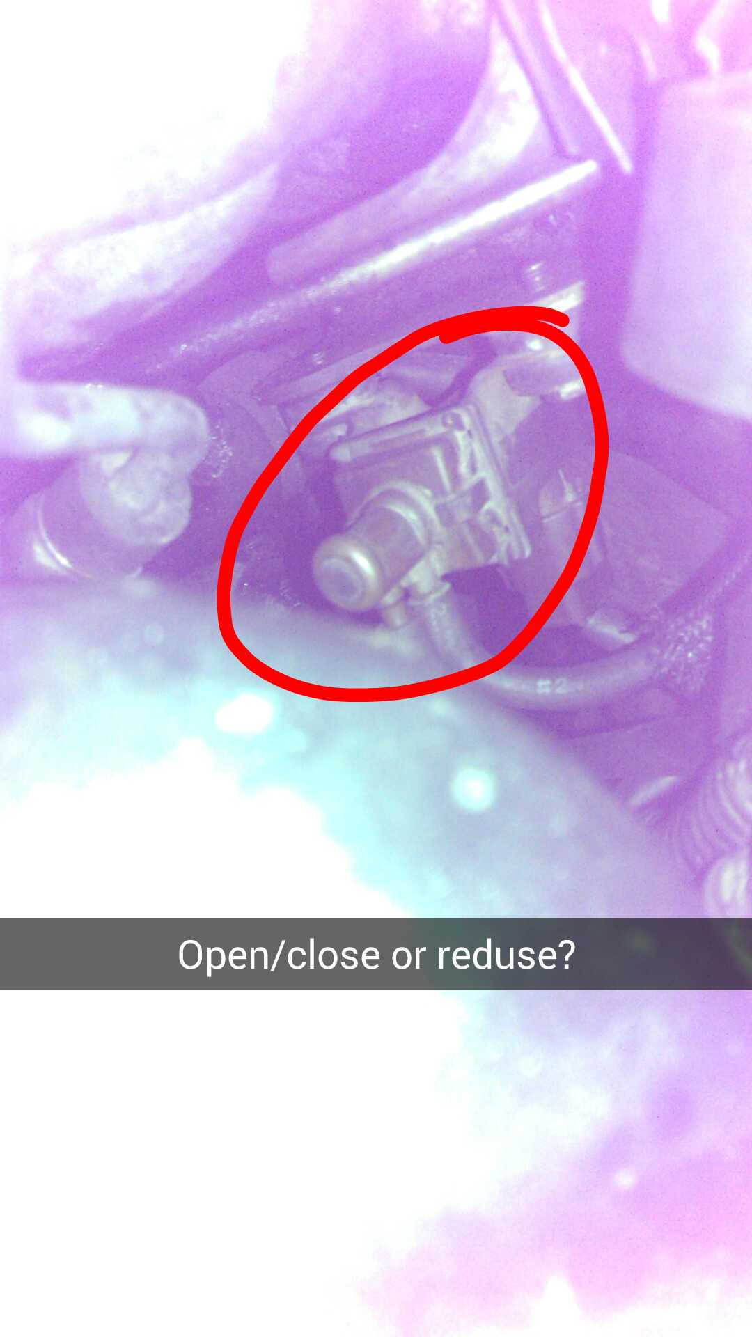

                Another question. The lower valve, between EGR and Vacuum pump, will that regulate vacuum, or just open and close.
                Before that valve i got -0,8bar, but after i got -0,2 -> -0,5

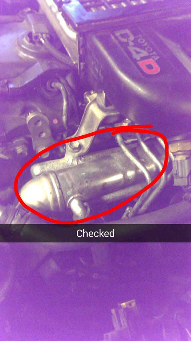

                    I have checked both. The pipe that is connected to the cylinder head, and the actual valve. Both seems open and fine. And I can stick my finger inside the cylinder head and can't feel anything wrong.

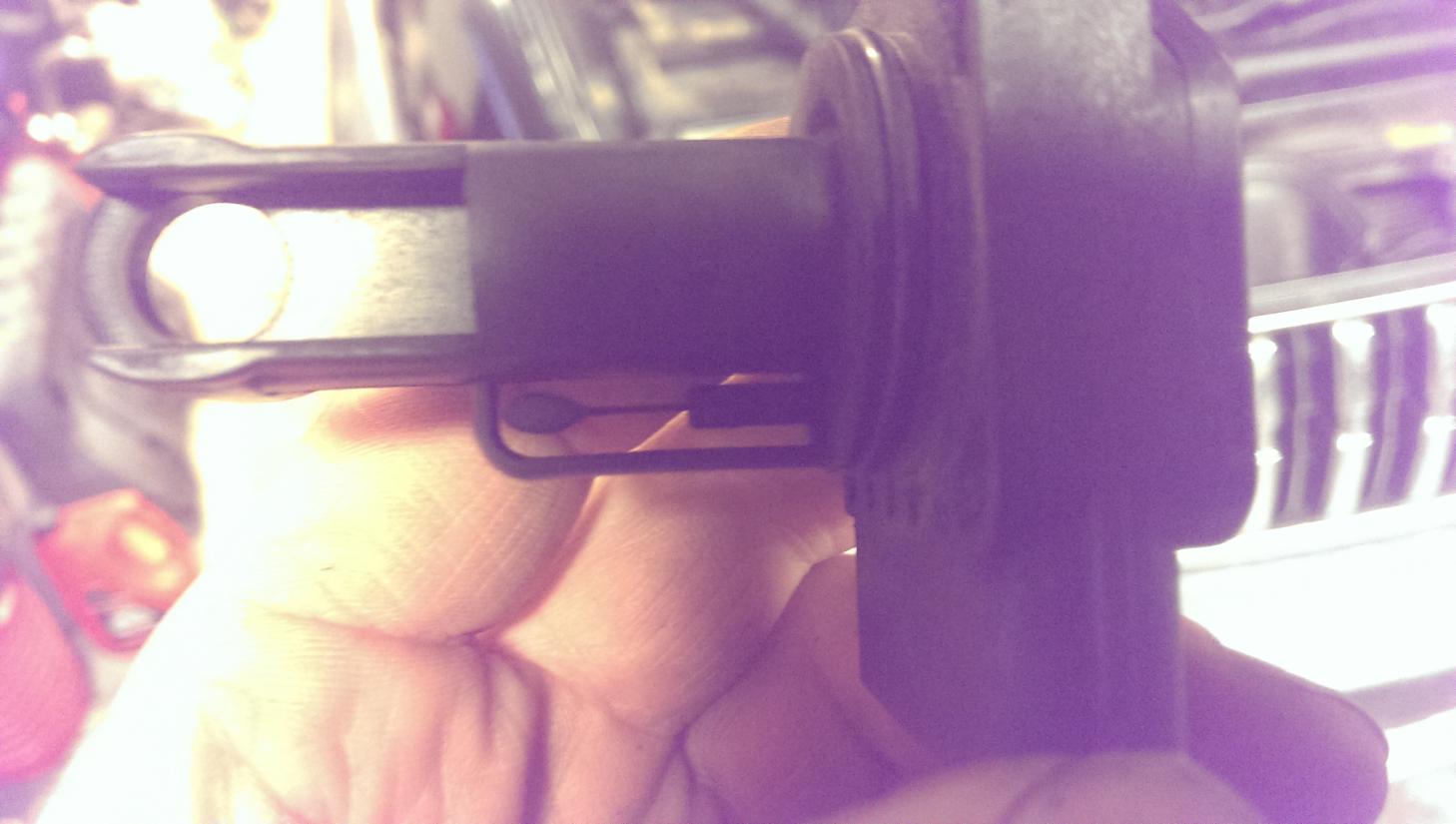

                      I just opened my MAF, and it seems clean from filter side, but it had a layer of dirt on the turbo side. Maybe that's my problem?
                        Well, it wasn't... I tried to clean it with brake cleaner, but didn't make any difference.

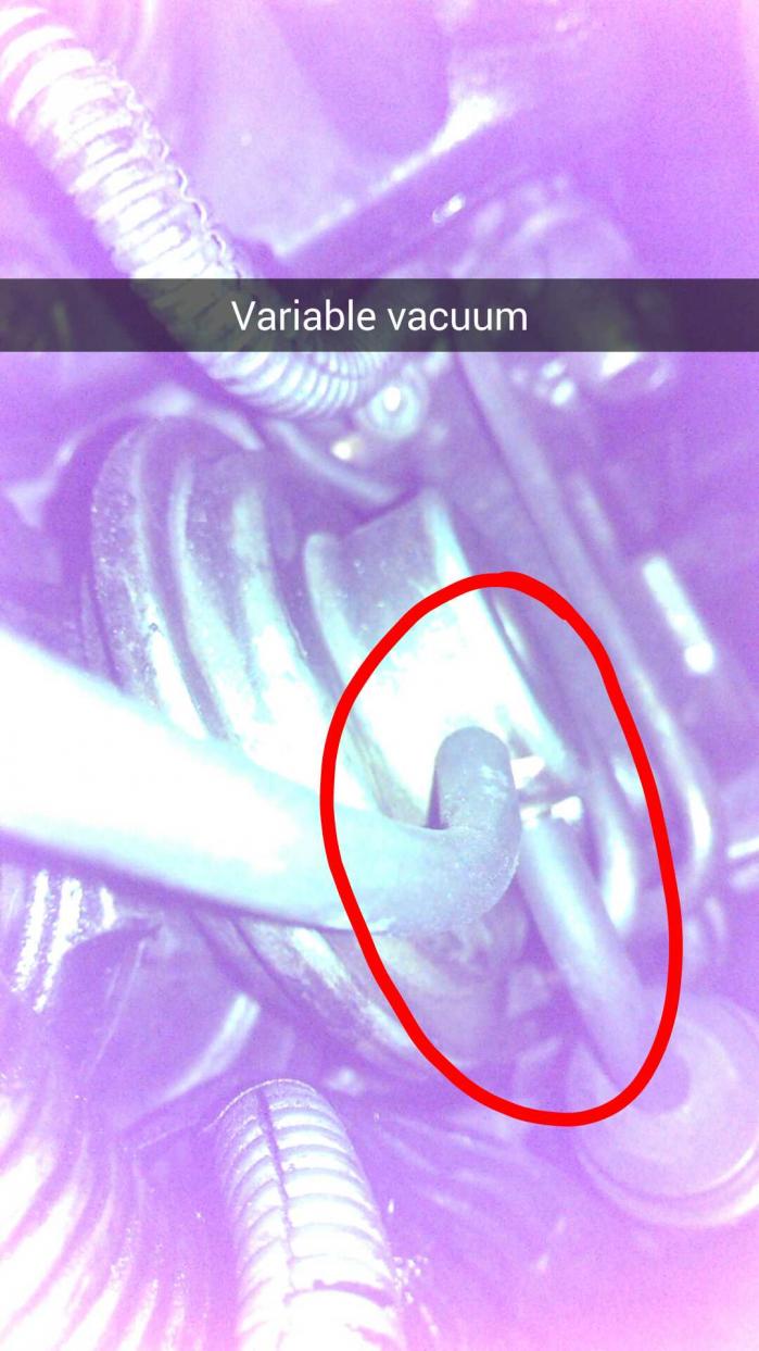

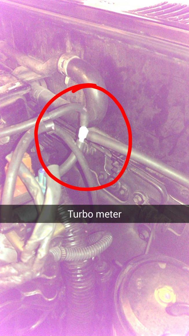

                          This is where I'm connecting the gauge
                          This heat exchanger is open, and doesnt have any plate blocking it

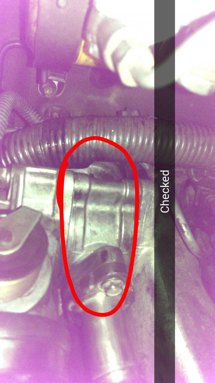

                          I have checked and cleaned the valve
                          When i check with an vacumgauge, i get various readings at the back of the EGR
                            I tried to clean this, but made no difference

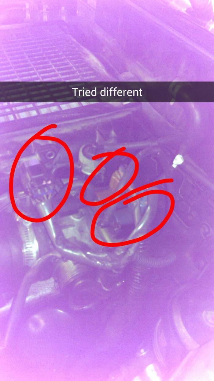

                            I have tried this from another vehicle, but with no luck.
                            Boost gauge
                            It seems to me like the boost release is working like u\it should. I can hear the turbo spinning, and when i release the trottle it doesnt stall, but slowly slows down.
                            My problem is the "boost limiter" in lack of a better word.... what is telling the turbo to stop produsing more boost, and why is it working when the engine is cold...

                              My vacuum runs like this: fom the pump, to a switch under the intake manifold, to a filter, then to the egr valve then from the egr valve to a blue switch. I think thats correct, but i dont know why there are two switches (valves)
                              The "boost lines" goes from the intake manifold, to a filter, the to a red switch (valve) then to the MAP sensor. Im not sure whate the red one does either.
