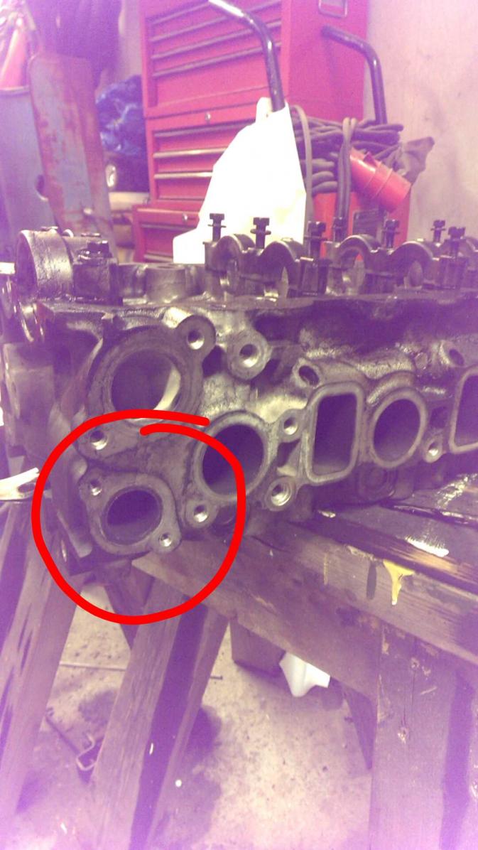

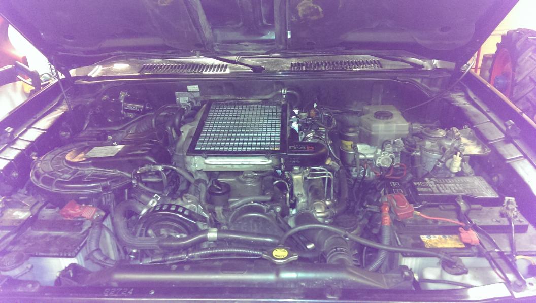

This is correct as yours does not have swirl flaps and also does not have the vacuum operated engine mounts but does have the hard rubber engine mounts!
This would help allot as there is big differences in engine metrics and configurations.

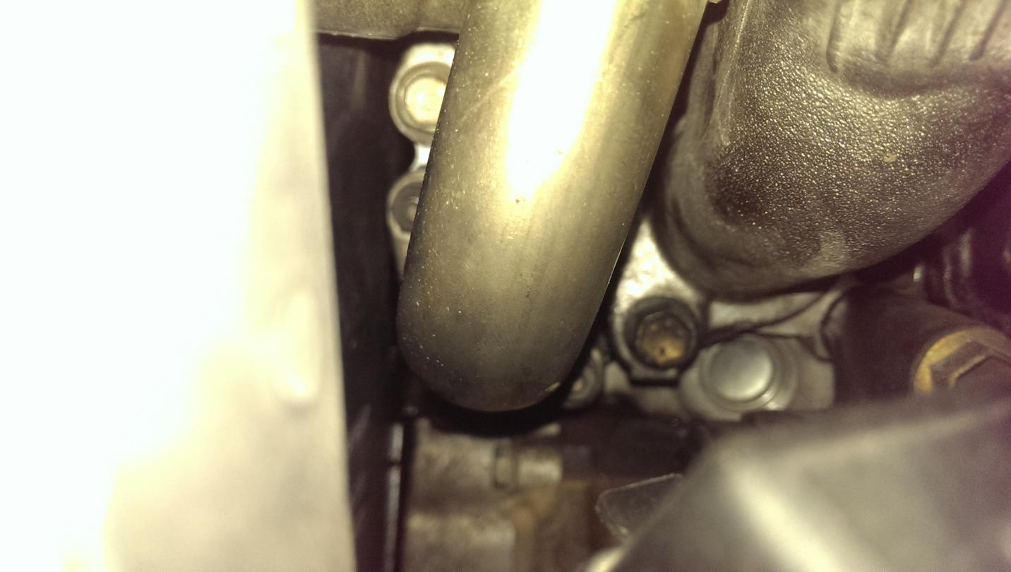

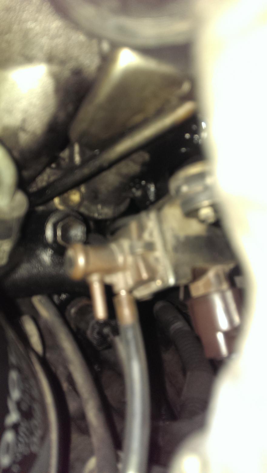

A pic of the Heat exchange bolting to the front of the cylinder head where the two 10mm bolts are so it can be confirmed we are looking at the correct part of the engine

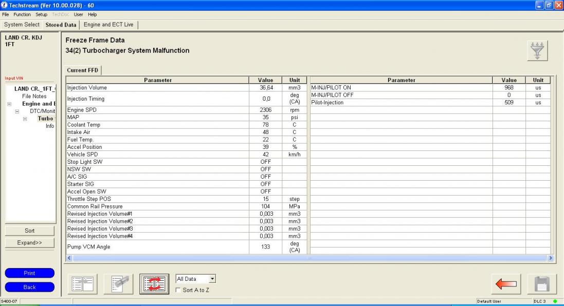

Once i am convinced that we are on the same page then we have to rule out that the vacuum solenoids (SCV & VSV) are connected and operating properly but as you have explained you have confirmed that the MAP (Manifold Absolute Pressure)/SVC (Suction Vacuum Control)/VSV (Vacuum Switching Valve) and vacuum pump are all working ok?
When looking at your boost gauge it responds very quickly (Faster than what i would call normal) and fly"s to just under 20.5psi (Should be approx 14psi max with the odd spike to 18-20 on very cold days + High altitudes).

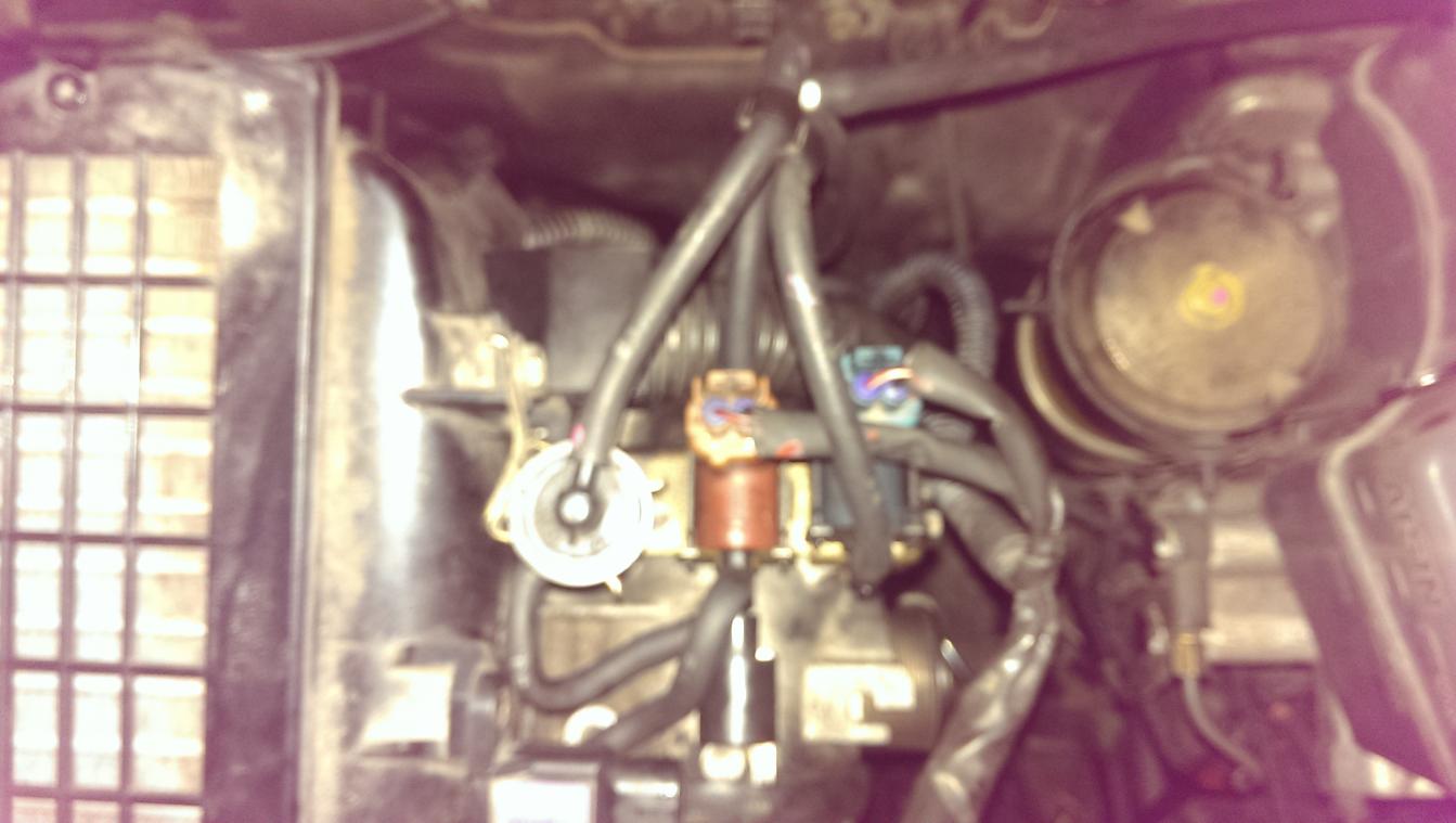

Vacuum line for the boost gauge needs to be connected directly to the intake manifold before any of the switching valves.
Example: Follow the MAP line past the delay valve canister (Fuel trap) & T into there as it goes directly into the Housing where the direct manifold pressure is after the throttle shut-off valve is so you will get absolute manifold pressure.

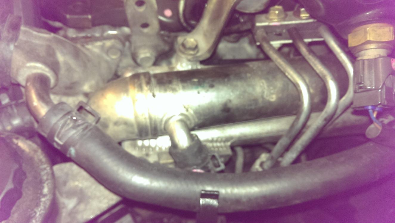

ALSO! In the second picture you definitely removed this from the engine and where this heat exchange connects directly to the cylinder head there is no restriction of any plate or anything at all on the cylinder head side?
I am still convinced that the boost is not dumping properly but under the impression that the mechanics are working properly?

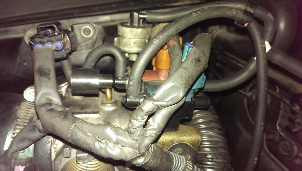

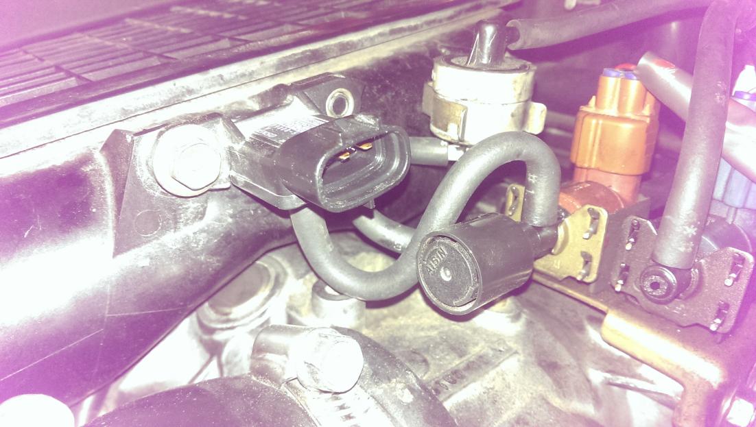

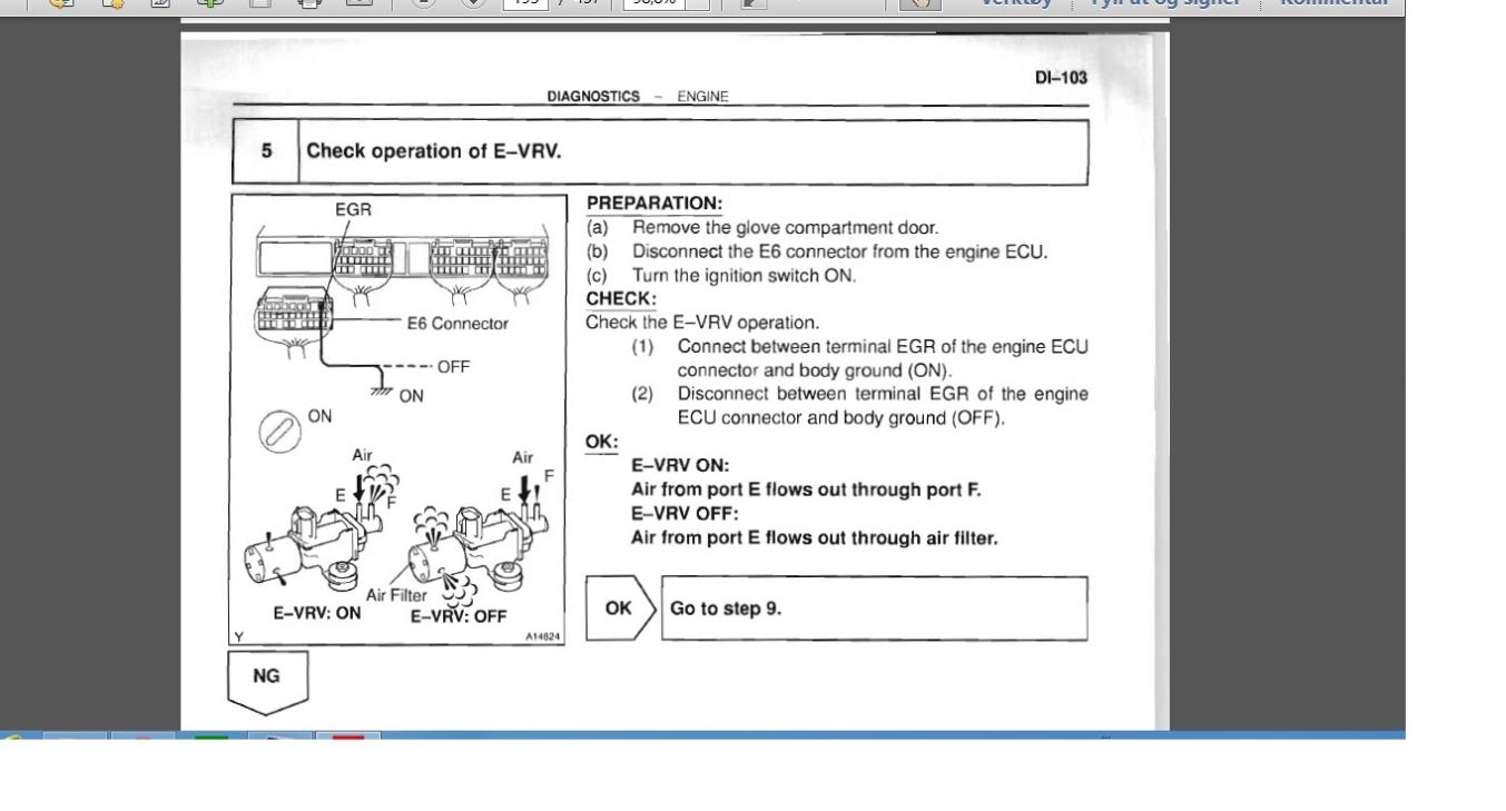

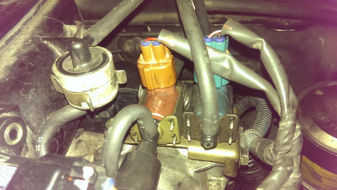

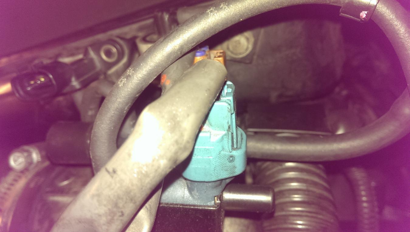

Switch is a SVC (Suction Vacuum Control)
I believe This is a one-way valve so can only suck towards the vacuume pump.
This is your VSV (VACUUM Switching Valve).
One valve provides vacumm to open the EGR valve then when that one closes the other opens and dumps the vacuum so that the EGR valve can close!
ALSO!
After the 2 x Switching solenoids (Don't know which is which as i only have a very primitive Black/White diagram) a vacuum line goes directly to another vacuum canister which is a delay valve to stop vacuum pulses and a snapping response directly from the intake manifold.
You should have your boost gauge connected to the line that goes directly to the intake manifold and before the delay valve.
I believe this is the valve that monitors the manifold pressure!....... i can't explain exactly as would need a visual as diagram i am looking at is not that explanatory?
