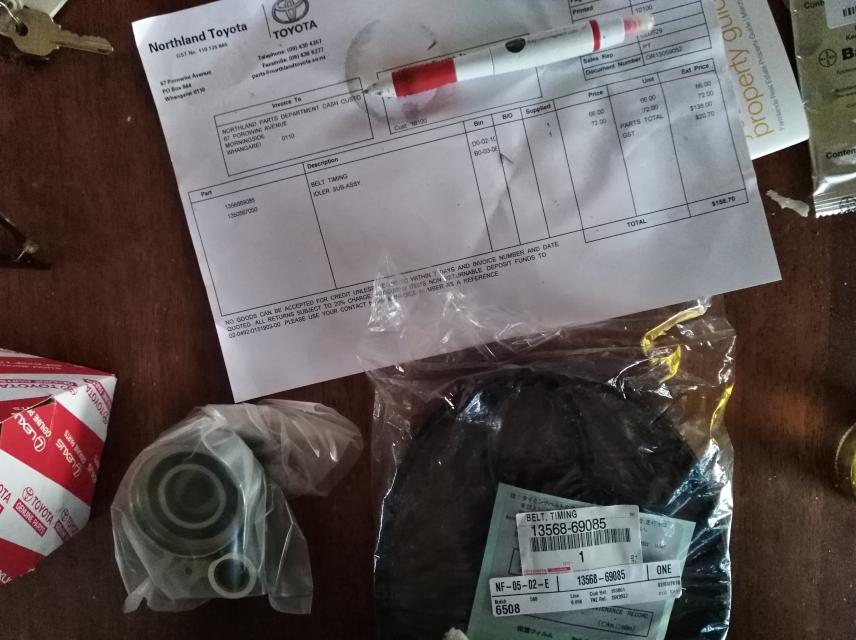

              I went to the Toyota dealer today. The cambelt was about $5 more than at a aftermarket place and the idler was actually cheaper so i was glad to buy genuine this time. I got the parts man to ask the technicians what the service interval is on the cambelt on these and he said that its now a change every 150000km. He said that this change happened in 1999. The partsman couldnt specify why and i didnt want to bother him to follow up on this but i wish i now had.
              So take from that what you each will. It means i dont need to do this straight away in my opinion so il wait til after ive gone on holiday with the girlfriend.
              Thanks for all your advice Carco, its being a good formula to follow, much better than those car repair books which a good at putting me off home repair, i will write up how i get on with this when i do do it. It wont be in the immediate future. Ive put the parts in a drawer away from vermin
