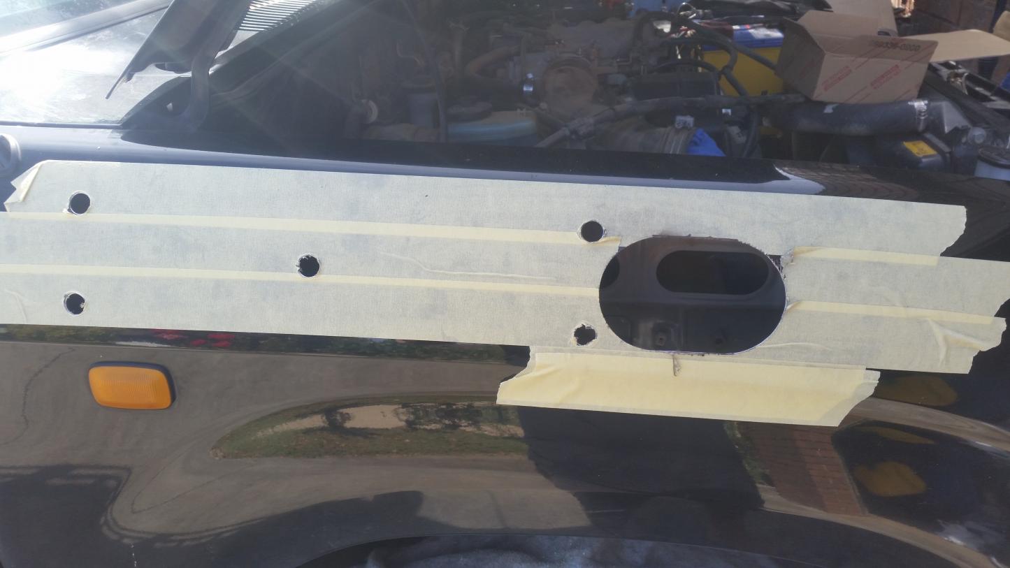

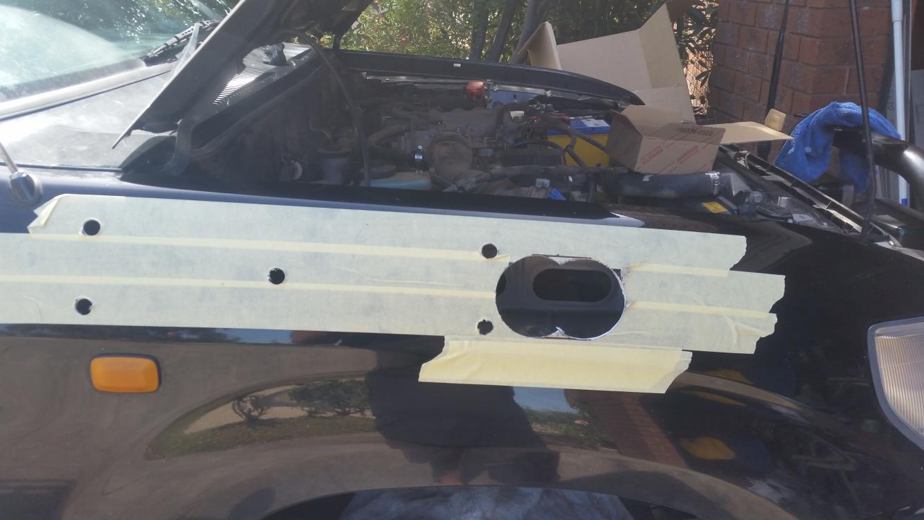

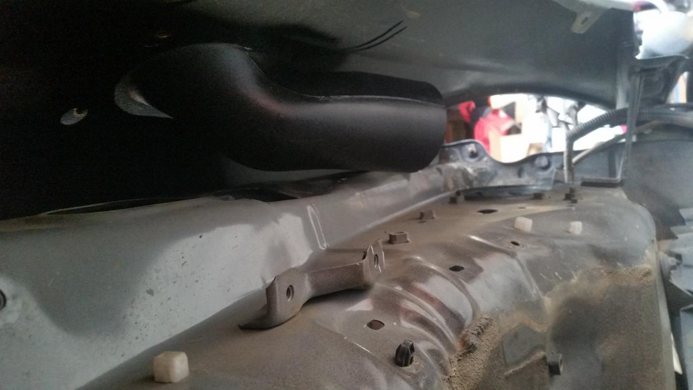

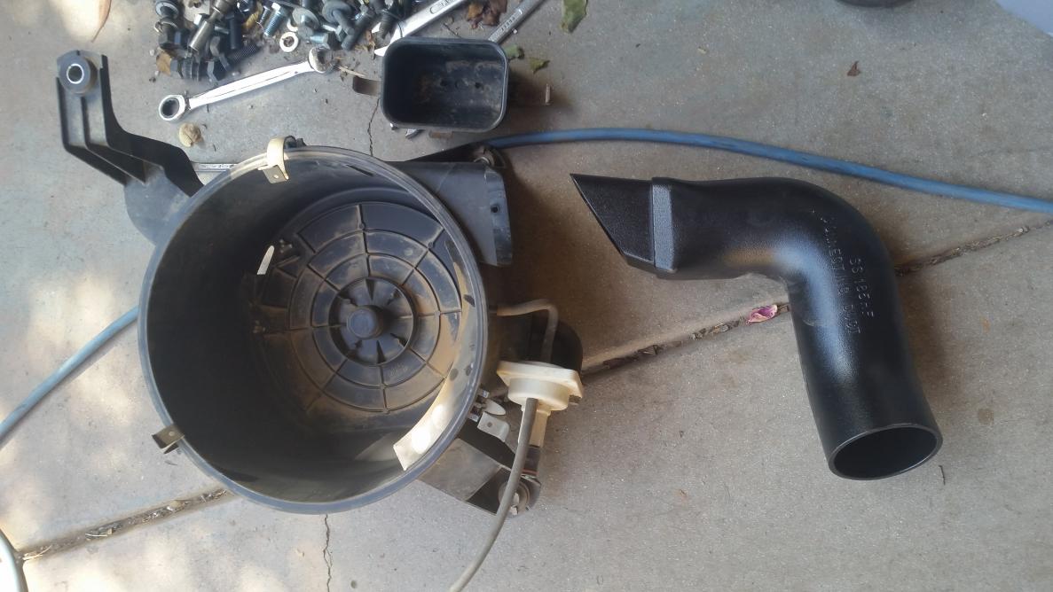

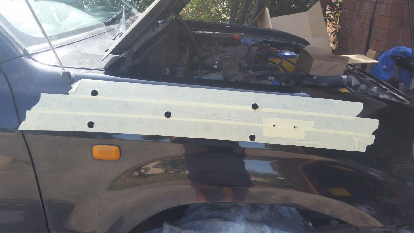

I have recently installed a snorkel from rv tek- Aussie tuff. It came with template and all instructions and all the hard ware to fit it. All you need is the tools, 83 mm hole saw 13 mm drill to fit hole saw and other general hand tools.
All in all the process was quite easy I just took my time and triple checked everything before drilling.
The snorkel coast me 65 the hole saw 70 and I had to get a new drill as mine was only a 10 mm.
If you want to know more info just ask
