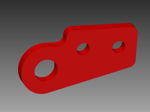

    Here it is! Im still designing it but heres a rough idea. Tell me what you think!
    [ATTACH=CONFIG]7171[/ATTACH]
    Also, must be red (or yellow) to help find in the mud...

      Question for you.
      What's the reason behind having a slot?
      The shackle pin either fits or it doesn't. Surely a round hole is all that's needed and may be cheaper. More meat around the hole = strength. If it has to be a slot then I'd rather it was angled like Lukeys. Having a vertical slot must weaken the front pulling face.

        I am being serious now. You want to set up the hooks so that they fit when you have barwork fitted. When you see a 95 in the street with a bull bar have a look, you will see what I mean. Just while you are at the design stage.
        The Roo.
        x2
        By the looks, junkie's design would be fine with an ARB bar but not with an Alloy/OEM bar. I'm pretty sure there's a few threads documenting the problems faced by 90 series owners with alloy bars.

            The slot is so that you can feed the shackle through the hole instead of the pin

                    Justan update, I have found the steel, found someone to fold it and found the laser cutters, I shall hopefully have one made soon. As for fitting on the bull bar can you guys upload some pictures of your current recovery hooks as I have a heap of space on my car.

                        Hi Malcom,
                        I have changed the design a little bit, taking into account some of the comments. The only change that I have made is where the D Shackle is mounted there is no slot. It has a hole instead so that it has its maximum strength. However I'm designing one so that the actual shackle can go through like the ones with the slots i'm also looking at one other design which should be up late tonight or tomorrow morning.
