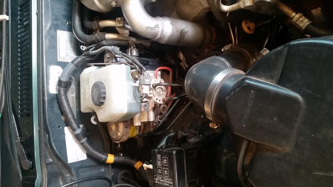

ID:	651764Chucked this in.... ABS/Trac control
            Fitted the whole kit bare in mind i never had abs before so this was a pretty big job all new brake lines diff housing hubs wiring
            Havnt got the trc working just yet as theres 3 wires that talk to the engine ECU and being a 120 ecu its not just a matter of pluging them in
            Stopping power is phenomenaly increased
            My car is a series 1 1996 one and all this was out of a series 2 abs in the late are very different
