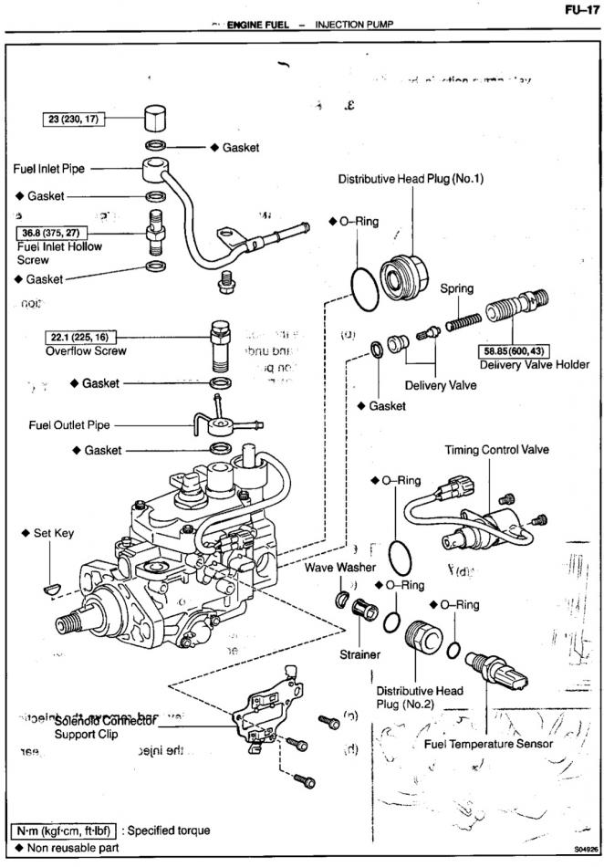

    On the 120 1KZ there's a inlet strainer inside the pump under the inlet pipe banjo bolt (I've not worked on a 95 1KZ so I'm not 100% sure they're the same), undo the bolt and carefully pry out the strainer if it has one. Give that a clean with brakeclean or solvent and blow out with compressed air. Next get a length of clear pvc hose and some barb fittings and connect it inline between the filter outlet and fuel pump, start the engine and watch for bubbles in the fuel. There should be none, if there is any you have an air leak in the system somewhere.

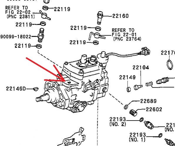

            You won't see the strainer it's down inside the pump body when you remove the banjo nut and stud on the pump. All bosch vp pumps have them and the denso pump is a copy of them
Name:	kzj95 pump 2.jpg

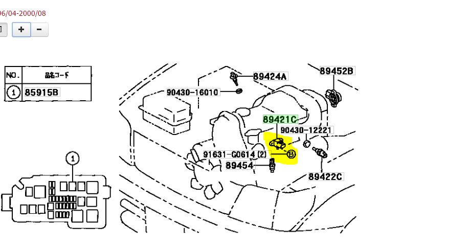

            Yours will have the map sensor, see here
Name:	map  sensor.JPG
              Thanks I will check ASAP. Is the MAP sensor the same as the boost sensor? where the hose to my boost gauge tee's off above the damper.

                    Waited for loss of power then disconnected map sensor, car immediately felt down on power when taking off and driving on flat road then felt worse going up hill so I can rule out map sensor fault.

                            Bought the proper tool and got the strainer out today but it's clean. Had trouble finding some clear hose today hope to find some tomorrow.
