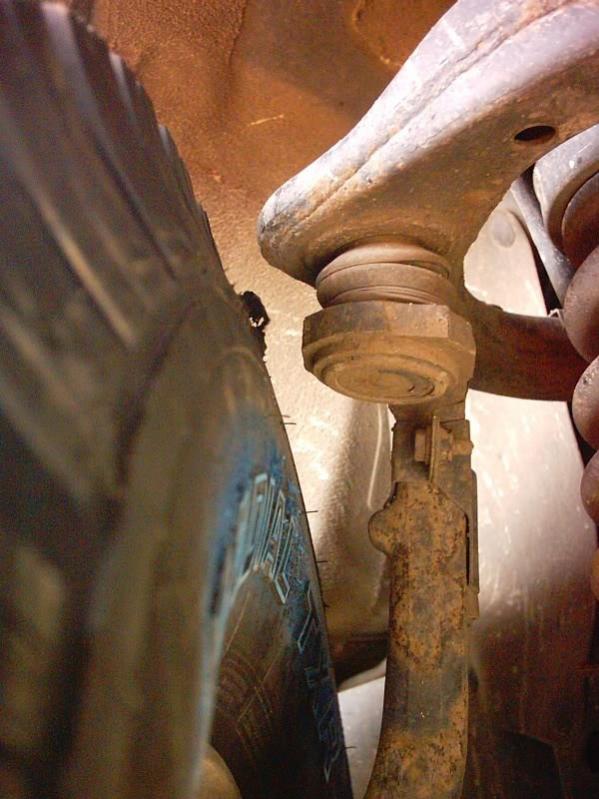

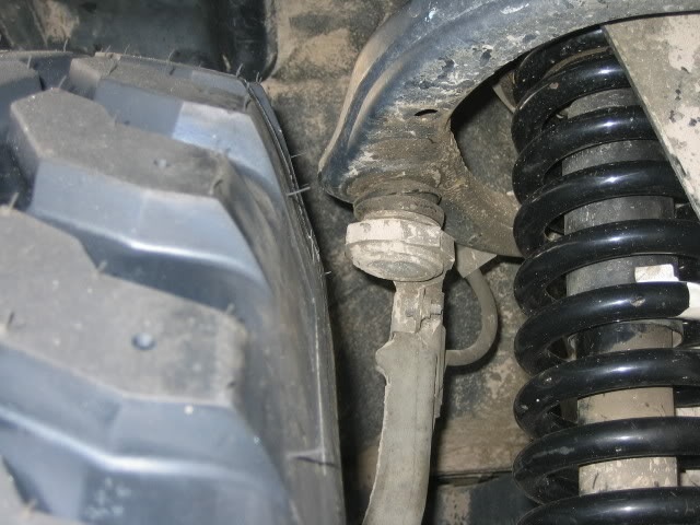

                    After having a look and doing some sums I think 285/75/16's on 8" 80 series 0 offset mags will be the go. It looks like the section width part of the tyre is where I may have clearance issues with the upper control arm and on the 80 series rims the section width for a BFG should be about 5mm better clearance than the current 265/75 +15 7" combo I have now, or at worst the same. This should give enough clearance there. Then it will be a matter of just making room in the guards which is nothing new to me or difficult.
                    • Well I've done some more research and it seems that 285/75/16's should clear the control arm on stock rims, just. I had to look on American 4runner forums but the suspension architecture is exactly the same and so are the wheels. Here are some pics I found. That wheel looks exactly the same as the one on my 98 grande and the offset is the same. Worth trying on the stock rims anyway and if it rubs I can always see if I can fix it, get new wheels or even a small spacer. Only need a few mm between the tyre and arm as it moves with the tyre.
