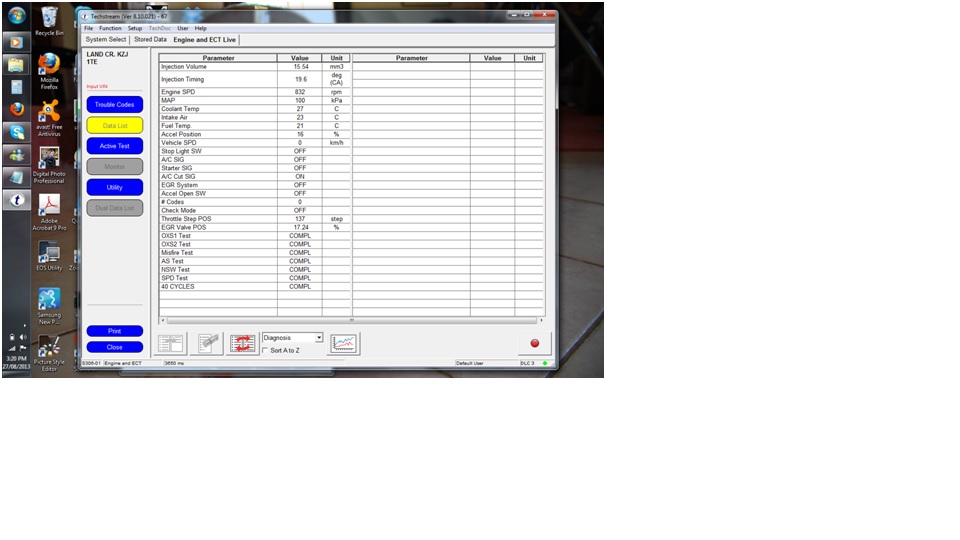

        I've just installed techstream on my laptop and it runs fine on 32bit Win7 so long as you set the .exe to XP3 compatibility first. Works great on my 1KZ-TE with M-OBD
        Not bad for $28 posted http://tinyurl.com/l9276l6
Name:	techstream screenshot.jpg
