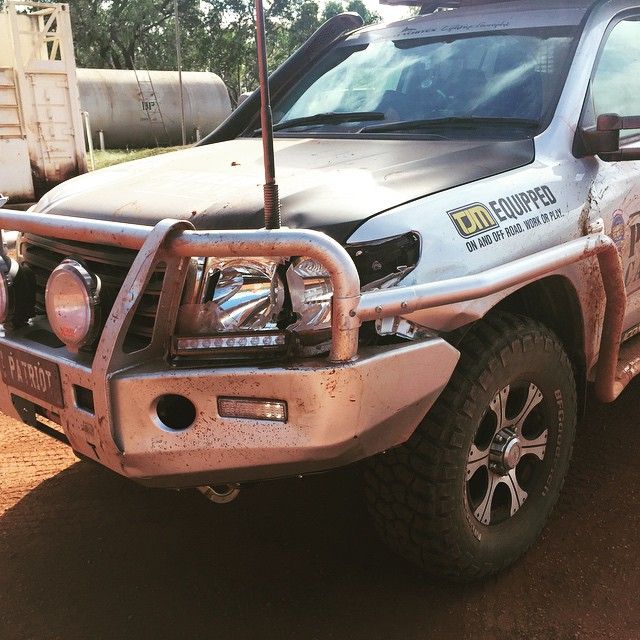

                              Having a side bar like in the photo partly by-passes the crumple zone by transferring load further down the chassis.
