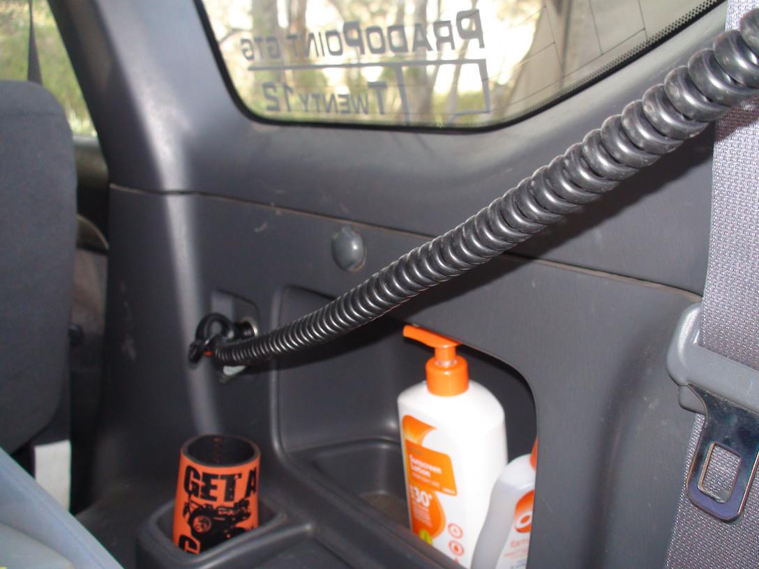

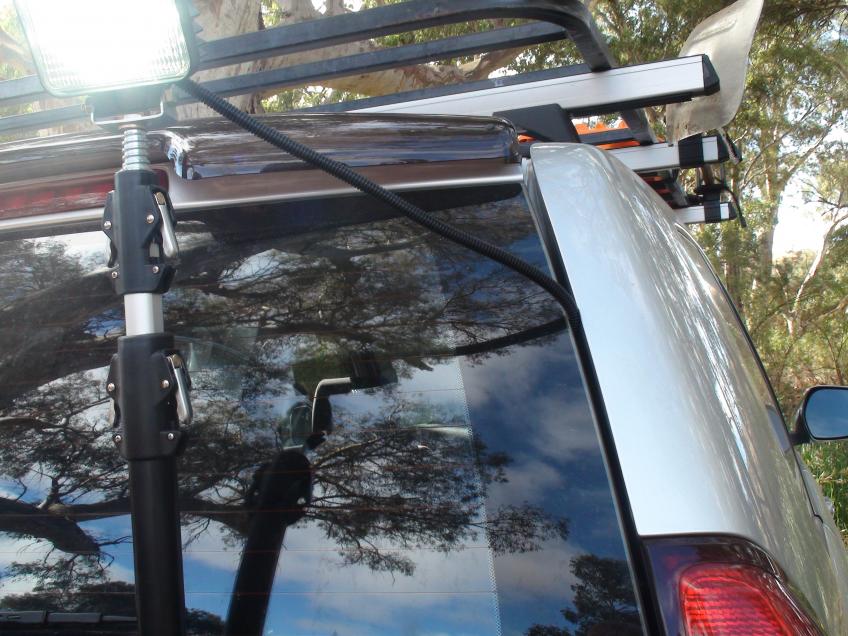

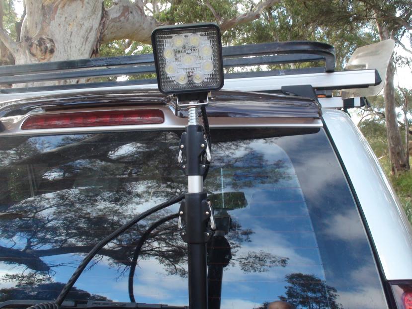

Just installed an AMTS work light bracket along with the work light I won at the GTG. A little help from the lad and it was up and running in an hour.
As the wife parks it in a public carpark all day, everything has to be able to be removed. This means installation had to be different from what Andrew intended, but it works for me.
I'll get some photos sometime over the weekend. I'm off in the morning to Burra Gorge for a night away from home with my 2 boys and their cousin so I'm not sure when I'll get to log on again.

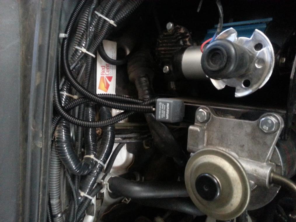

Here's where I'm up to so far:
Fan installed and wired up to the relay.Power from fuse block to relay.
Now I have to get the switch installed and work out which pin get's connected to what. I know I need to hook up to the accessories, go from the switch to the relay and find an earth in the cabin. A little more research should get me the info I need.

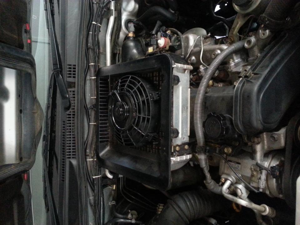

Earlier in the week a 7 inch fan arrived in the post. Bought from an eBay seller for $28. If I get a chance this weekend it'll be mounted on the intercooler. I was going to have it activated via a temp switch, but since most of the benefit will come at low speeds, a manual switch will do. Slow speed work when airflow is at it's lowest will be the only time it's turned on.
Not sure if I'll get a chance this weekend to work on the rig as it's the mrs's birthday, but when she goes off to work I might be able to grab a couple of hours. Photo's to come.
