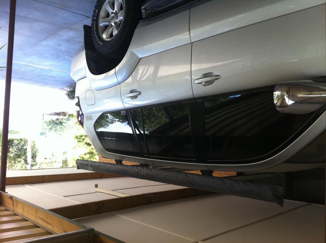

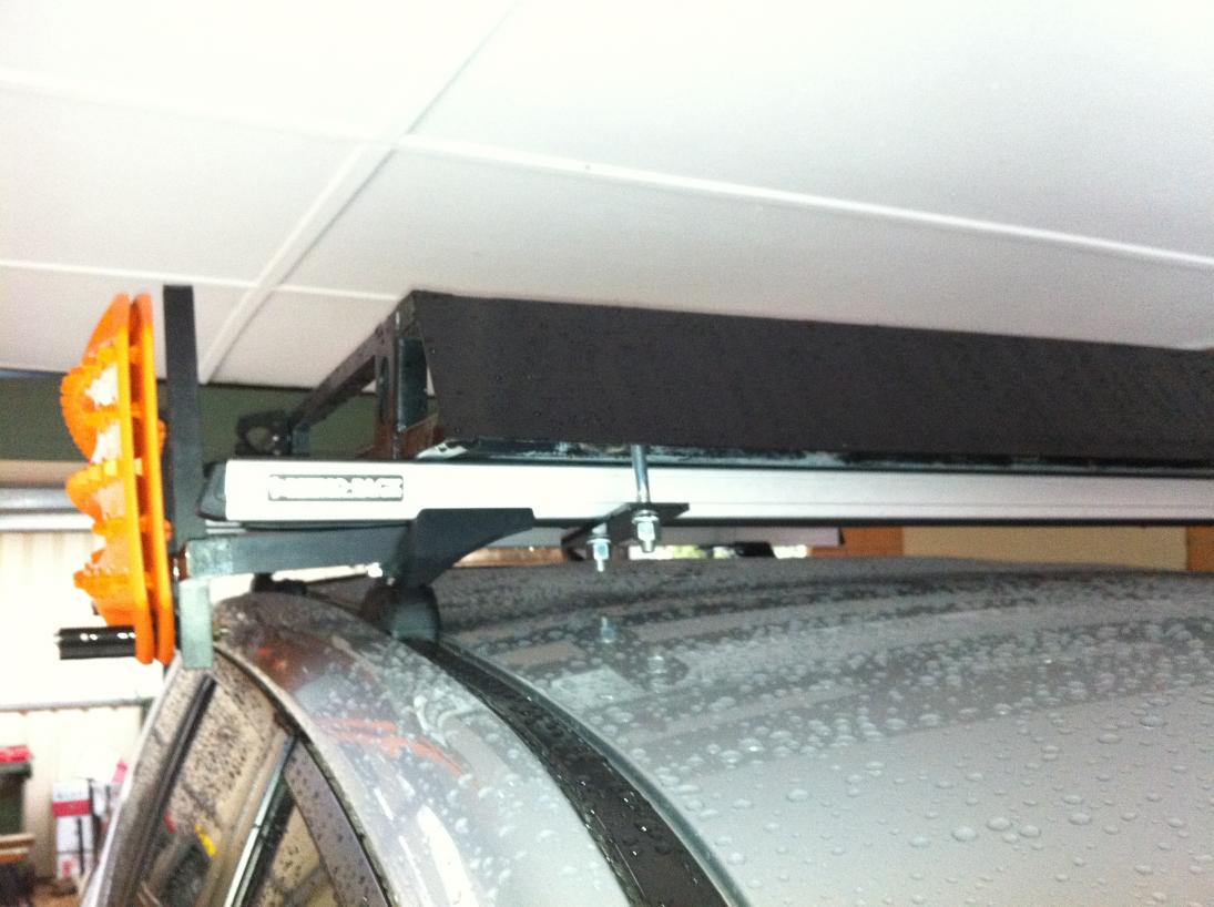

    Pretty much same brackets as mine gramps. Same method of fixing too (where did you get that idea ;p ) . I've had no probs and had the awning on for a good 18 months. My guess with the so called 'bracket failure' would be nuts coming loose. Probably didn't use nylocks etc.....

    Careful with the ol' Bunnings brackets there Gramps. I've read elsewhere that they just don't seem to have the durability of other brackets that are made for the job. On one occasion I read the front bracket had a failure, with the awning nose diving into the ground whilst the back bracket remained attached. Not good.
    Might pay to visit a roof rack specialist shop, or an ARB store. Whilst they were a bit more than Bunnings would charge, I think the cost of proper brackets was quite reasonable.

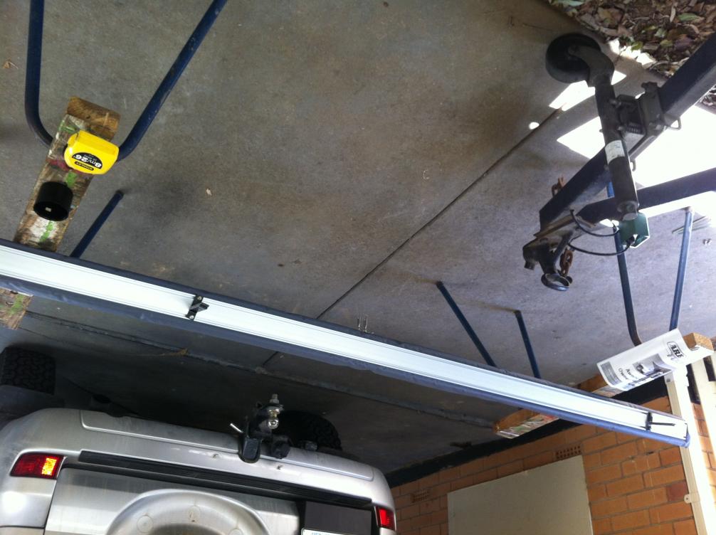

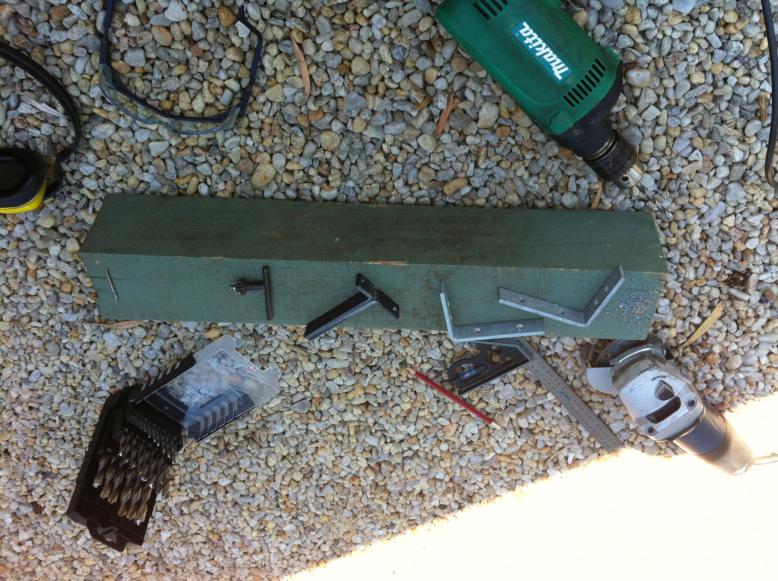

    Finding time lately has been a bit hard, but the other weekend I managed to mount the ARB awning I scored at the GTG.
    After a trip to Bunnings to grab a couple of brackets, it didn't take long to have the awning up and ready to go. A couple of holes through the HD Rhino Bars which 8mm bolts were used to hold the brackets in place along with a nyloc nut for each, and job done.
    I had wanted one of these for a while, so you can imagine how happy I was when my name was called out.
    Gramps

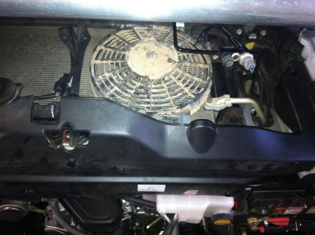

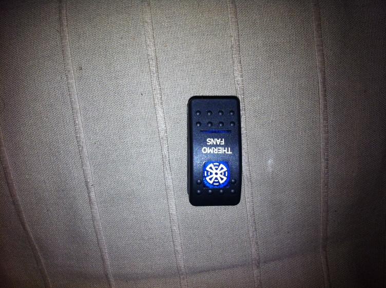

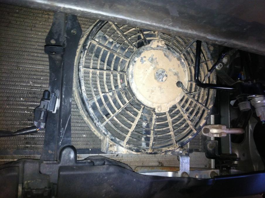

    As promised, a couple of pics of yesterday's efforts.
    This is the thermo fan Matt installed complete with custom brackets top and bottom. You'd think he'd clean the dust off before installing. Lol
    I haven't made my mind up exactly where I'll install the switch.

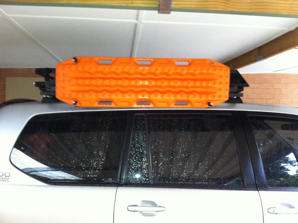

    yes sapradogxl - a second set of maxtrax is a great idea - all thanks to a heads up from a nameless mate.....
