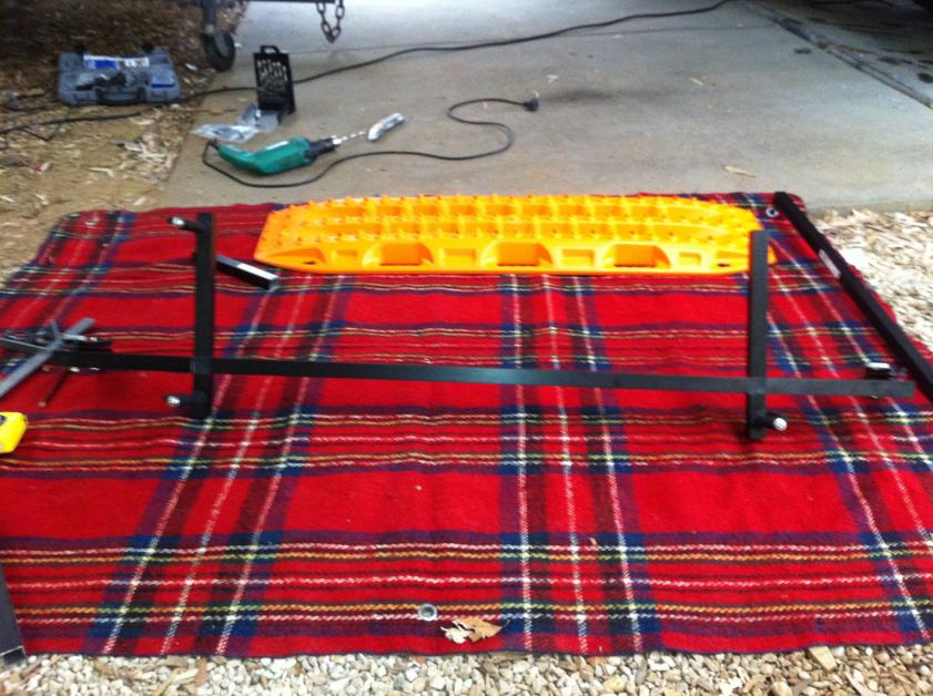

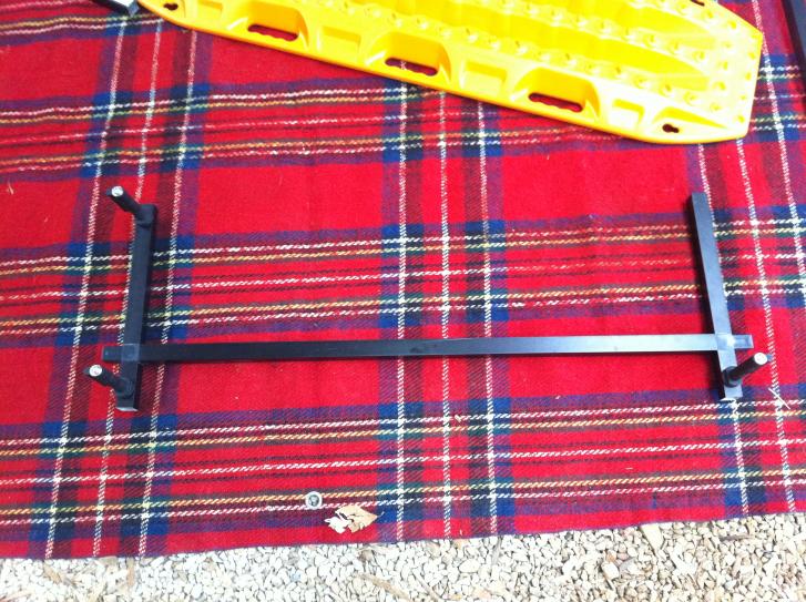

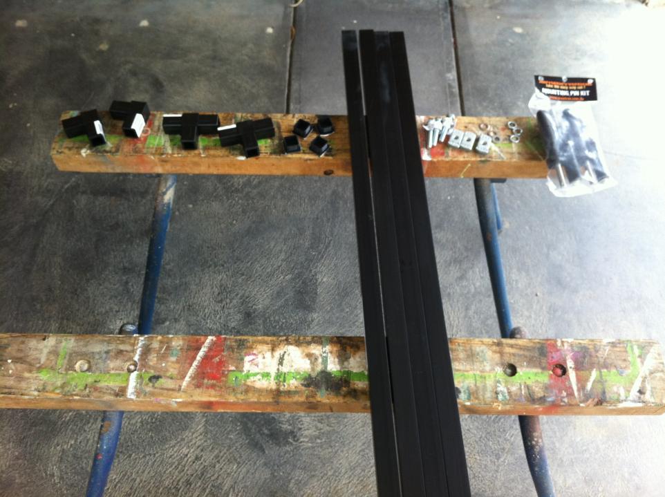

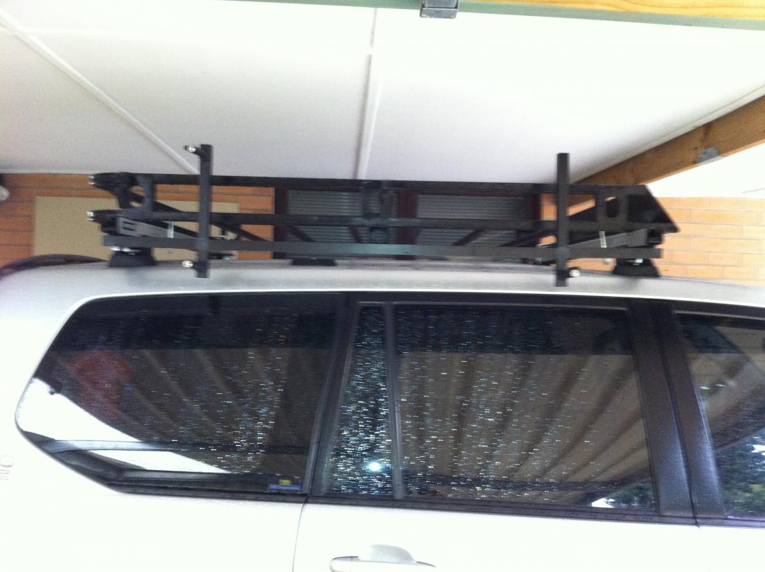

    Until I get to the GTG and win a set of max racks, I thought I'd knock a set up today. After a trip down to Bunnings for some anodised aluminium and some bolts, it was back home for some fun.
    Materials: max trax mounting pins, Rhino Rack 8mm captive nut x4, m8 x 50mm nuts x3, square aluminium tube 900mm long x3, 90 degree plastic bend x2, plastic 4 way T piece x2, plastic end cap x4. I still need to get another 8mm Rhino Rack captive nut, m8 x 50mm nut and some nylock nuts for the max trax pins.
    After working out the distance from the door to the bottom of the roof bars, cut 2x 70mm lengths and insert the 4 way T piece into each of them for the bottom max trax mounting hole. Then cut 2x 230mm lengths, connect to the 4 way T piece, top mounting hole done.
    A 830mm length of aluminium connects the 2 mounting uprights. On the outside of the 830mm length, 2x 205mm long sections are needed to connect to the 90 degree bends. These are then connected to a 150mm (rear) and 130mm (front) section of aluminium which is then bolted to the roof bars using the captive nuts.
    I have rubber inserted on the underside of my bars to stop the whistle from the wind which also stops the bars being scratched by the mounting pieces. This is the reason m8 x 50mm bolts are needed. If the rubber wasn't used, I think I could have got away with using 30mm bolts.
    So far it has cost me $60 for the Bunnings materials and $27 for the Max Trax pins. Probably have another $10 to spend to finish it off, so I'm happy with the result.

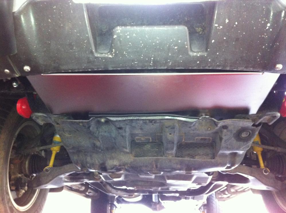

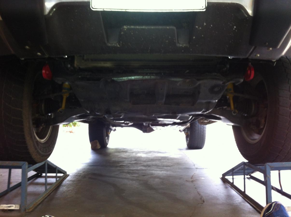

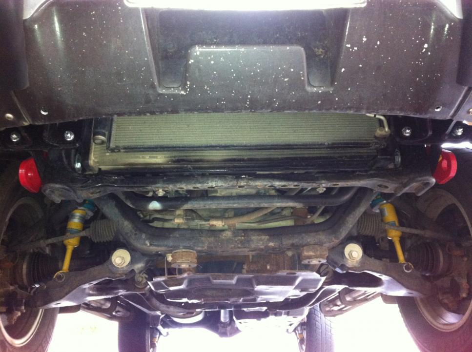

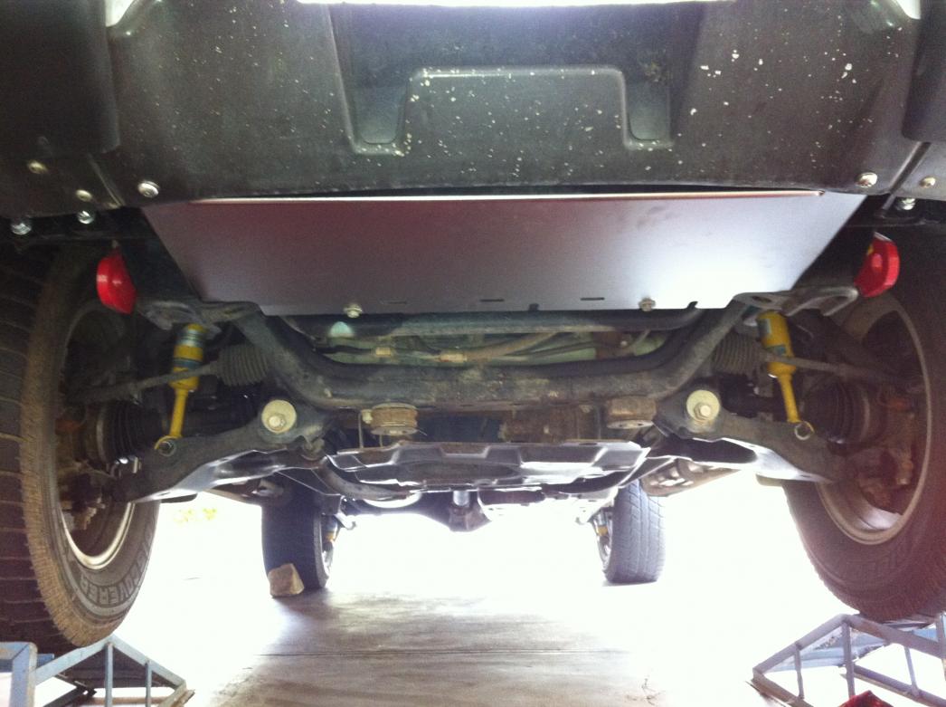

    Yesterday morning I called in to see AMTS and pick up a radiator bash plate. This sits between the factory bar and the first bash plate.
    Steps involved:
    *Cut tabs at the front of the bash plate.These tabs allow the plate to swing down from the rear but hinder the removal of the plate
    *Remove 4 screws holding bash plate as well as the plate itself
    *Re-insert front 2 screws partially to aid in marking up of holes in the base of the bar
    *Locate new bash plate on screws at the rear and hold plate up to the base of the bar
    *AMTS has designed the plate with elongated holes in the tabs at the front of the plate for those with/without a winch cradle. If you have the cradle, mark the bar using the front section of the hole. Mark at the rear of the hole if you don't have a winch cradle (this is what I did). When the winch cradle is installed, apparently the bar is push forward marginally.
    *Remove plate and drill 2 holes in the bar. I ended up using a 10.5mm drill bit for supplied bolts. Remember, measure twice and drill once.
    *Mount up new plate using the supplied bolts. Make sure the front tabs are on top of the bar and rubber washers are placed between plate and bar.
    *Re-install existing bash plate starting from rear 2 bolts
    *Screw in front 2 mounting bolts through existing and new plates. I found that the existing plate sits below the new, have to check with AMTS to see if this is what he intended.
    All up this took me about an hour and that included applying and the drying of cold gal to the cuts in the existing plate where the tabs were removed. Thanks AMTS for another great looking and useful product, and for the chat yesterday.
    Guys, for $120 this is worth the time of install and the knowledge that the radiator is well protected. Now to save for a full set of AMTS replacement bash plates.
