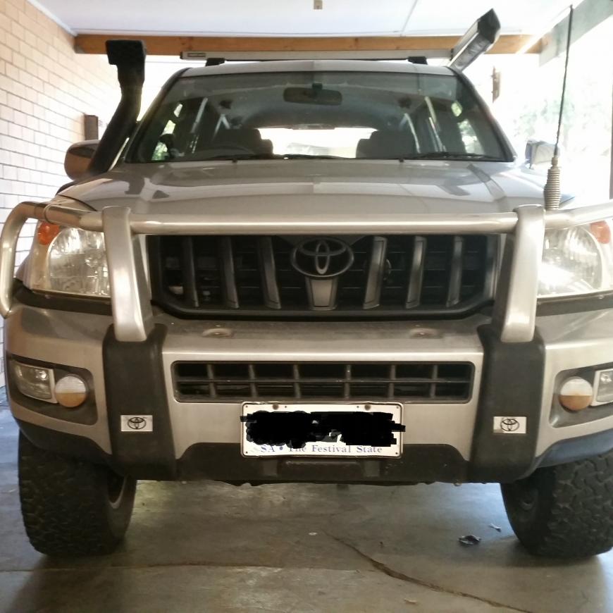

    So, I picked up a couple of cheap DRL's from Ebay the other week and got around to installing them today. At this stage they are just temporary. Famous last words.
    Working out where to put them was the 1st thing to sort out. I decided that the 'grill' above the number plate of the sovereign bar was a good spot.
    FYI this is not a legal fitting position as they need to be at least 600mm apart.

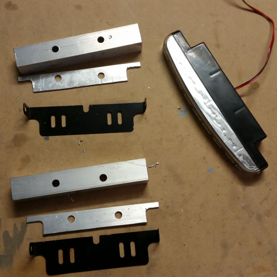

    Working out where to put them was the 1st thing to sort out. I decided that the 'grill' above the number plate of the sovereign bar was a good spot. I had to make up a couple of brackets to hold them in place and all I had was some aluminium C channel. So measure, cut and clean up the edges gives a couple of mounting brackets. The black light bracket and flat ali on the outside and C channel behind all held together with m6x40mm bolts.

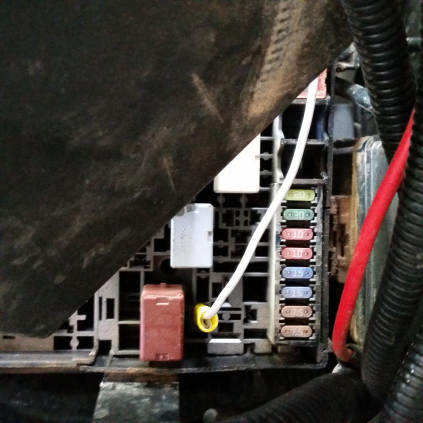

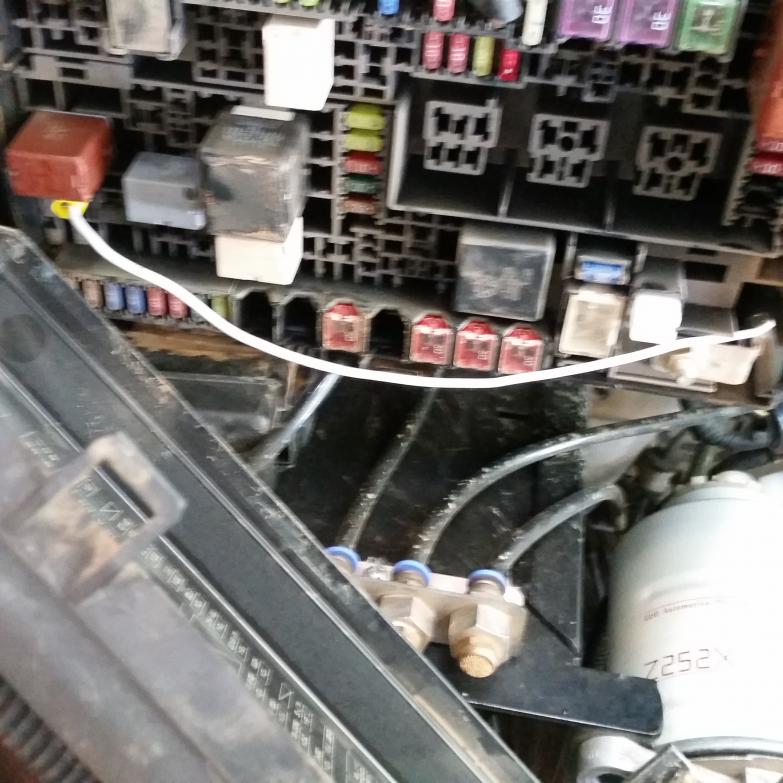

    For power, I followed AMTS' suggestion and went to the fuse box. You can see his suggestion with this link - http://www.pradopoint.com/showthread...l=1#post407602. This means that as soon as I switch ignition on, on come the DRL's. They do not turn off when the Lights are turned on though.
    Like I said, they are temporary at the moment but it may turn out that I like them. If that happens, I'll upgrade to a better set (these were only $7.30 from Hong Kong) which will stay in place until the bar is upgraded.

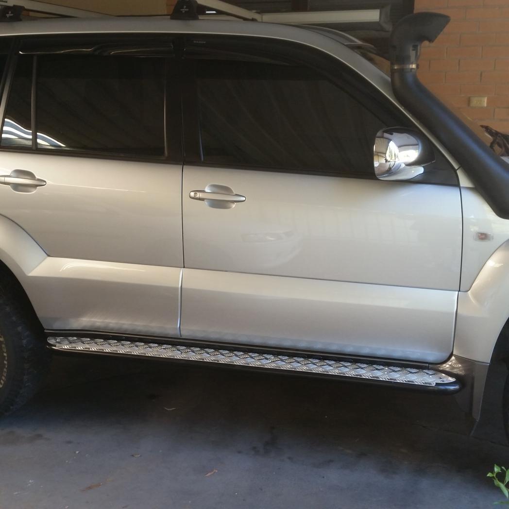

    A quick shot of the TJM side steps.

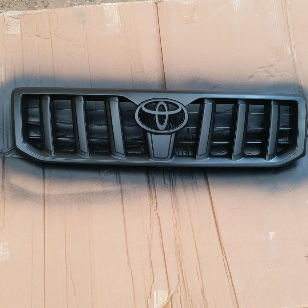

    Well my son and I had a bit of fun today. We decided that the front grill needed altering. Off to Autobarn and got a can of black Plasti-dip.
    After washing the grill and then wiping down with metho, she was ready to go. At first I wanted to peel back the logo to have a little 'bling', but it looks pretty good as it is.
    Take a look at the photos and see what you think. This is a whole can which gave me 6 coats.
    Next, I'll be buying a bonnet protector and plastidip-ing the back of it.

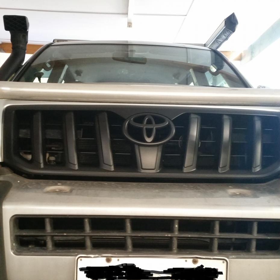

    Hi Gramps
    The grill looks good, shame that you ran out after you started the number plate.
    Leave a comment:
  • Golly
  • Golly
    replied
    Like that look! I have the bonnet protector blackened on the back. Thinking of blackening out the Flinders shiny bits also. Was even looking at getting the Sovereign bar powder coated to complete the transformation in the end. I love the grill work mate.

  • Gramps
  • Gramps
    replied
    Plasti - Dip
