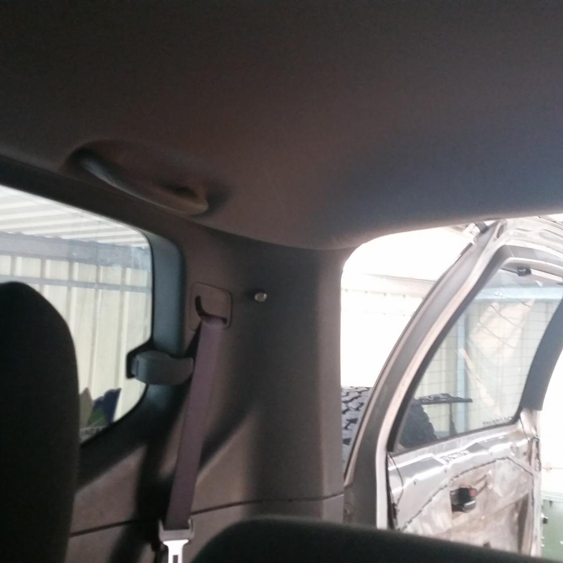

    It's easy, you just need to prise the clear cover off with a small screwdriver. There are 2 tabs on each side holding it in place. The grey housing is then leverd out with the screwdriver. Get it in under 1 end and lever it until you can get a fingertip underneath. Then work your fingers around pulling down until it pops out. If you go easy, you won't break anything.

    How did you get the cargo light out? I've done the light on the top door trim and ran the wires but the cargo light's a bit of a mystery. Had a bit of a pry with a small screwdriver here and there but no luck. I have the same 120.
    I don't want to break it.

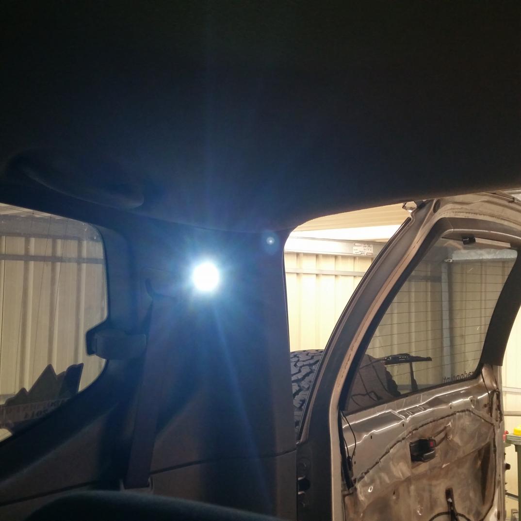

    So, I found that my rear door table was only being used every now and then, and when it was, only part of it. This meant that a redesign was called for. No pictures of the table yet, but I installed a light strip on the rear door in anticipation of the finished table.
    This time the power comes from the cargo courtesy light. I had hoped to have the door light come on whenever the door was opened, but I couldn't work out the switching so I have left the operation to the switch on the light. It's just a Jaycar LED light all of 280 lumens, but it should do the job.

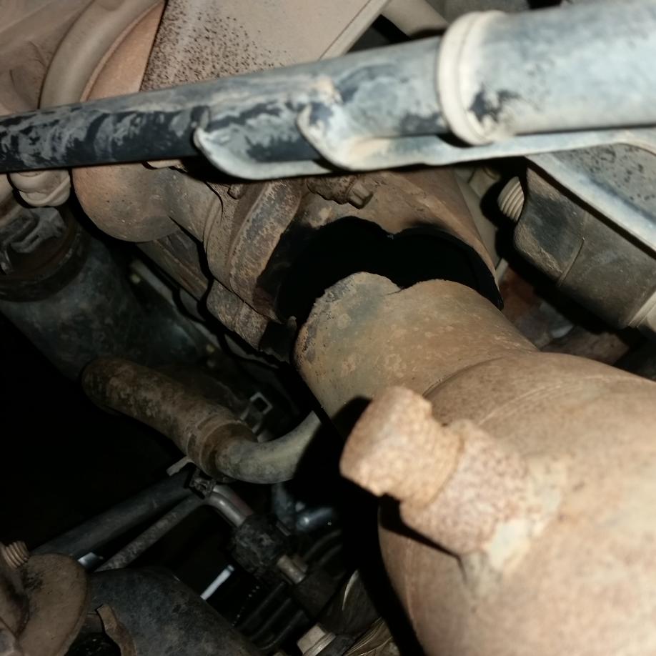

    Exhaust Broken
    I had a phone call earlier today from the wife saying that the car is making a weird noise. Apparently it happens when you accelerate and stops when you get to about 80km/h. She tried to get me to hear it over the phone but it wasn't possible. As I was in a rush to get my son to a soccer game when she got home, I just jumped in the Prado and took off. Man was it loud, but it sounded like the exhaust had a hole in it. Mind you, there was nothing wrong with it last night when I was driving to and from the movies.
    Anyway, I have just been underneath the car and found what is in the photo attached. I have never seen this happen before, but it's one serious case of metal fatigue.
    Looks like I'm up for a new section of exhaust from the dump pipe.
    Cough, cough. Since I'm suddenly not feeling well and will need to call in sick tomorrow morning, I may as well get the exhaust fixed at the same time.
