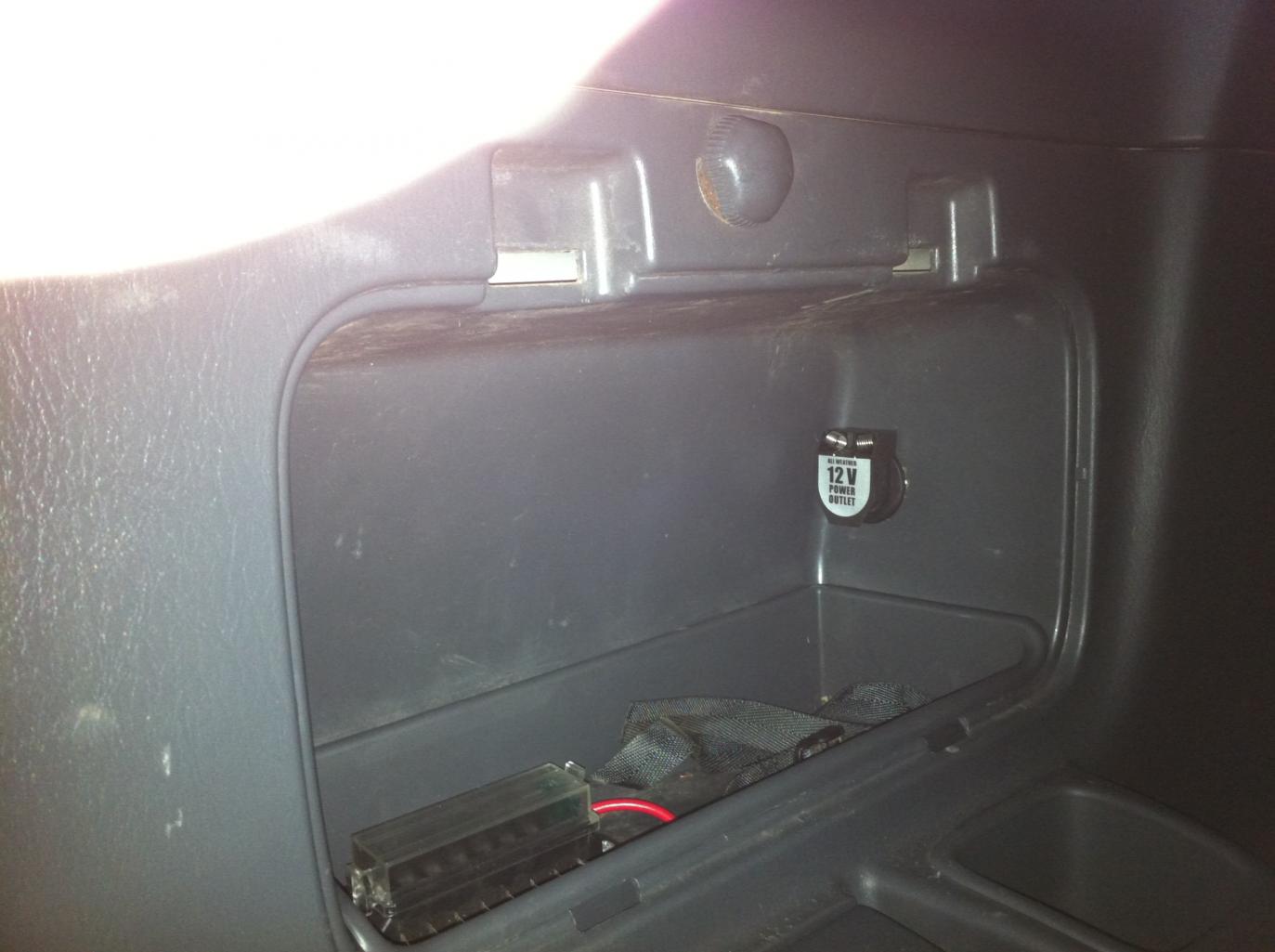

    Spent today cleaning up some wiring in the engine bay. I swear, there were that many fuses coming off the main battery it was a total joke. Not sure what the last owner had connected, but I got rid of 3 power feeds that seemed to go nowhere. I moved 2 to the new fuse block but I can't find what these power.
    The driving lights were switched to the 2nd battery. That way I'll be able to use them to help setting up camp at night. I just need to work out a way of switching between high beam and independently.
    Also managed to install a socket in the rear for my fridge. Hidden away for 90% of the time, and out of the way when in use. I plan on cutting a small slot in the bottom of the cover for the power leed.

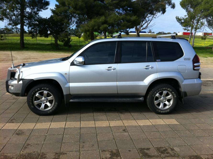

    Tomorrow, it's a trip down to BCF to get some gear to knock up a fold down table for the rear door.
    It'll be a mix of carpet for the underside and lacquer on the top. The carpet will tie in with the drawer and the lacquer side will be easy to clean up spills. All trimmed around the edges with some aluminium. The picture in my head looks damn good, let's see how the finished product turns out.

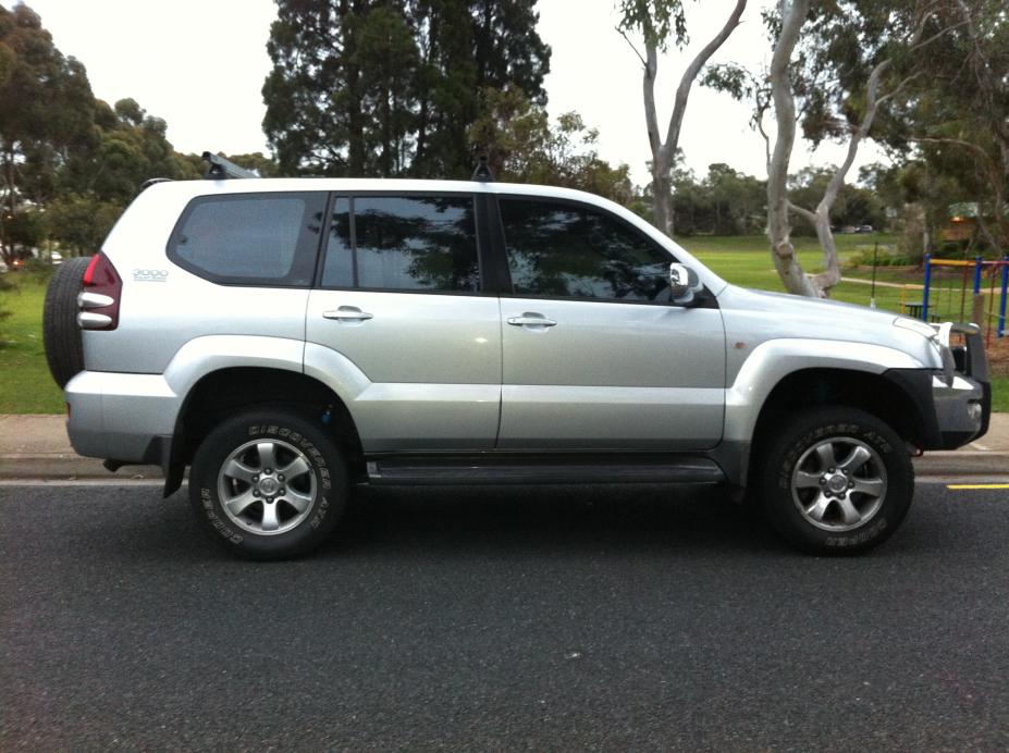

    Measurement After :
    Front Right :- BoR to Wheelarch - 810
    MoH to Wheelarch -
    Front Left :- BoR to wheelarch - 810
    MoH to Wheelarch -
    Rear Right :- BoR to Wheelarch - 825
    MoH to Wheelarch -
    Rear Left :- BoR to Wheelarch - 825
    MoH to Wheelarch -

    Measurements before:
    Front Right :- Bottom of Rim(BoR) to Wheelarch - 735
    Middle of Hub(MoH) to Wheelarch - 505
    Front Left :- BoR to Wheelarch - 735
    MoH to Wheelarch - 510
    Rear Right :- BoR to Wheelarch - 785
    MoH to Wheelarch - 555
    Rear Left :- BoR to Wheelarch - 775
    MoH to Wheelarch - 540

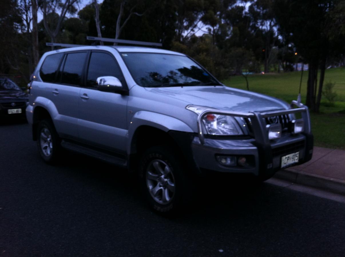

    Yeah baby! We are now that little further away from Terra Firma.
    Lift installed today, and I could tell the difference straight away. The ride was a bit firmer and cornered flatter.
    The wife only noticed the difference when getting out of the car, she slid down because the ground wasn't where she expected it to be. I had a bit of a chuckle, got a slap on the arm and told we just need a bulldog on the bonnet (Mack truck). Like F#%K........
