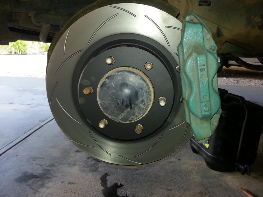

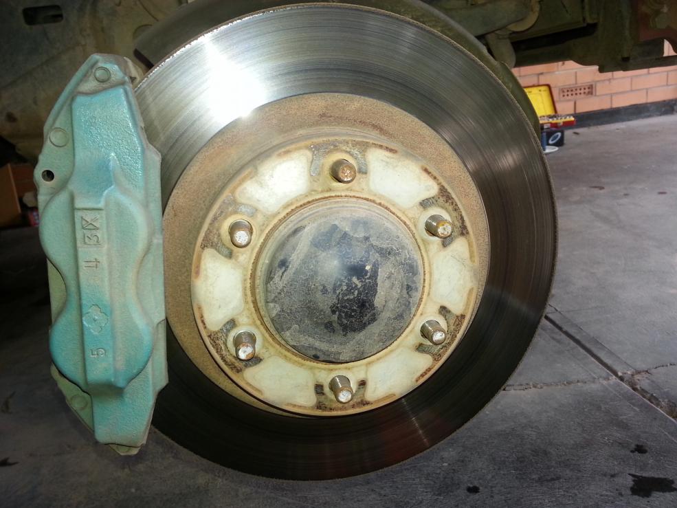

Name:	new rotor.jpg
Name:	old rotor.jpg
    Found a couple of photos of the weekends efforts.
    Leave a comment:
  • Gramps
  • Gramps
    replied
    Yeah, really simple.
    -wheel off (pretty obvious,Lol)
    -Spray liberal amounts of WD40 on 2 bolts at the back of the calipers
    -Remove split pins from brake pad locating rod
    -Slide rods out as well as spring loaded wire on bottom rod (remember path of wire)
    -Remove old brake pads. At this point I loosened the cap on the brake reserviour to release pressure on the pistons.
    -prise back front and rear brake pistons to make sliding in new pads easier
    -remove bolts from calipers and move away from rotor. I then put them on a stand so there was no bending of the brake lines
    -slide old rotor off and new rotor on
    -reinstall caliper and screw bolts back in
    -insert new pads making sure to use correct pads in their right position (there will be a description on the back of the pads to indicate position)
    -once lined up, the rods go back in with the spring loaded wire on the bottom rod
    -split pins go back in
    -wheel on and then brake fluid cap replaced
    -jump in the car and pump the brake pedal to bring the pressure back up then take for a test drive
    -doneski, finito

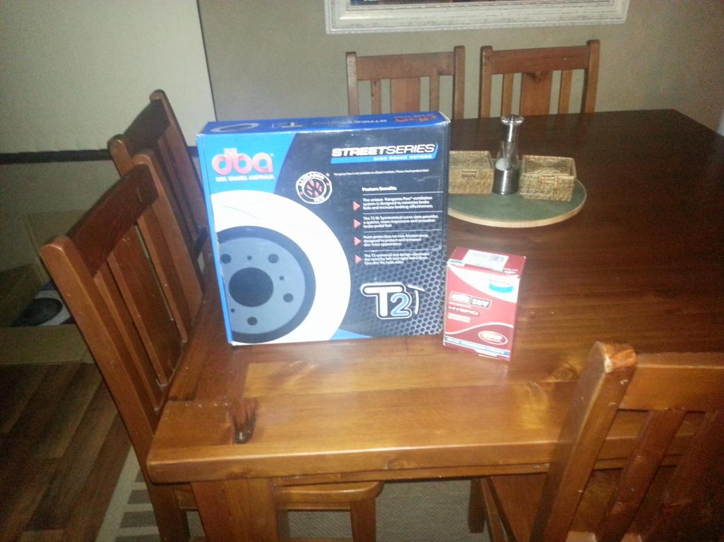

    I love it when the postie comes bearing gifts... Just the fronts this time, the rears don't need replacing at this time. Now I nne to find the time to install them.
