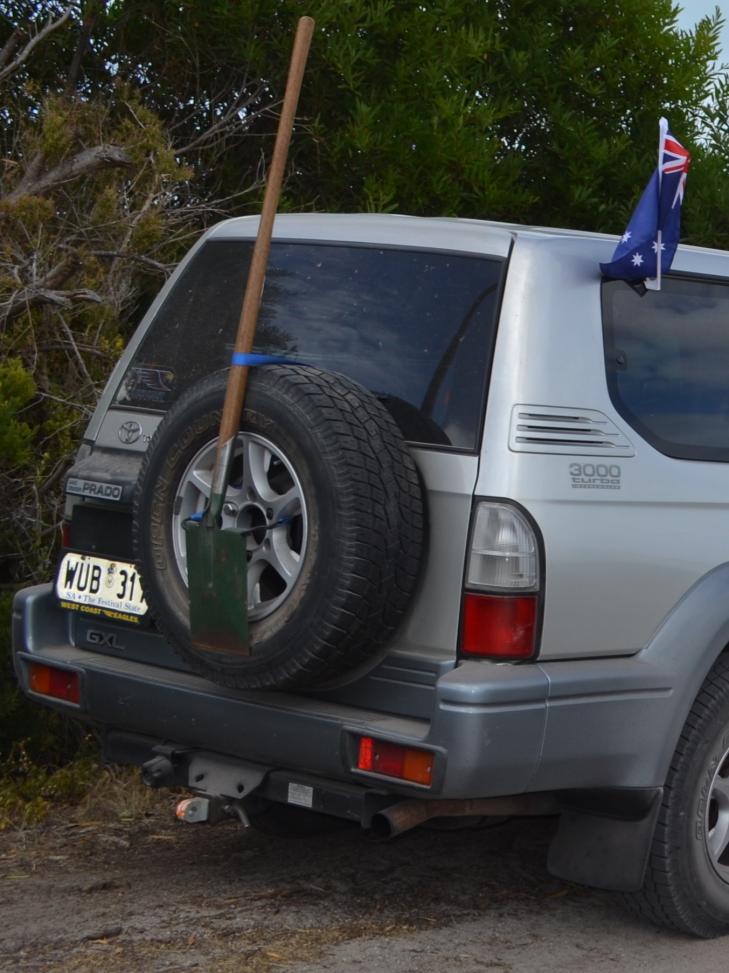

    Picture of flag being used in anger and shovel holder. Shovel holder worked a treat over 1000km on the weekend and didn't move.

      Looks good Snoopy. Good to see another 90 series getting out and about! Hope you had a good time down the south east, would be good to catch up on a trip one day.

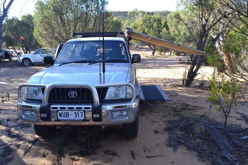

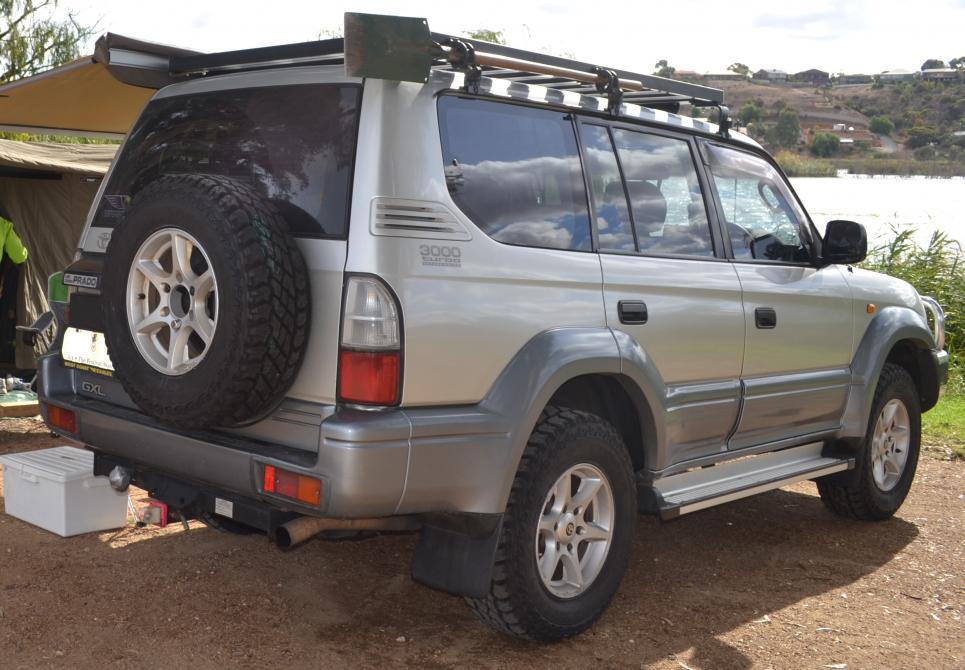

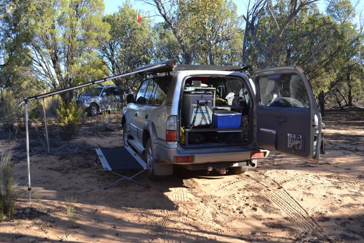

                Recently fitted a Wind Cheetah roof rack and Feather Lite 2.5x 2.1 awning. Pics attached.
                Tested them last weekend along the border track.
                Staked one of my tyres which bought forward my tyre replacement strategy by 6 months. Get 5 x Cooper ST Maxx tyres fitted Wed.
