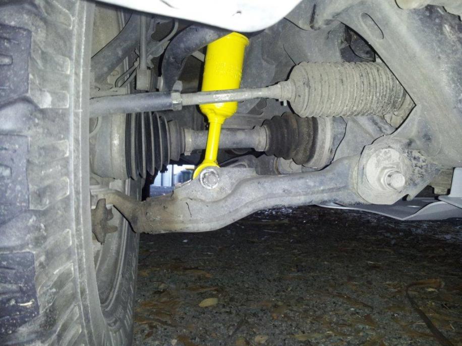

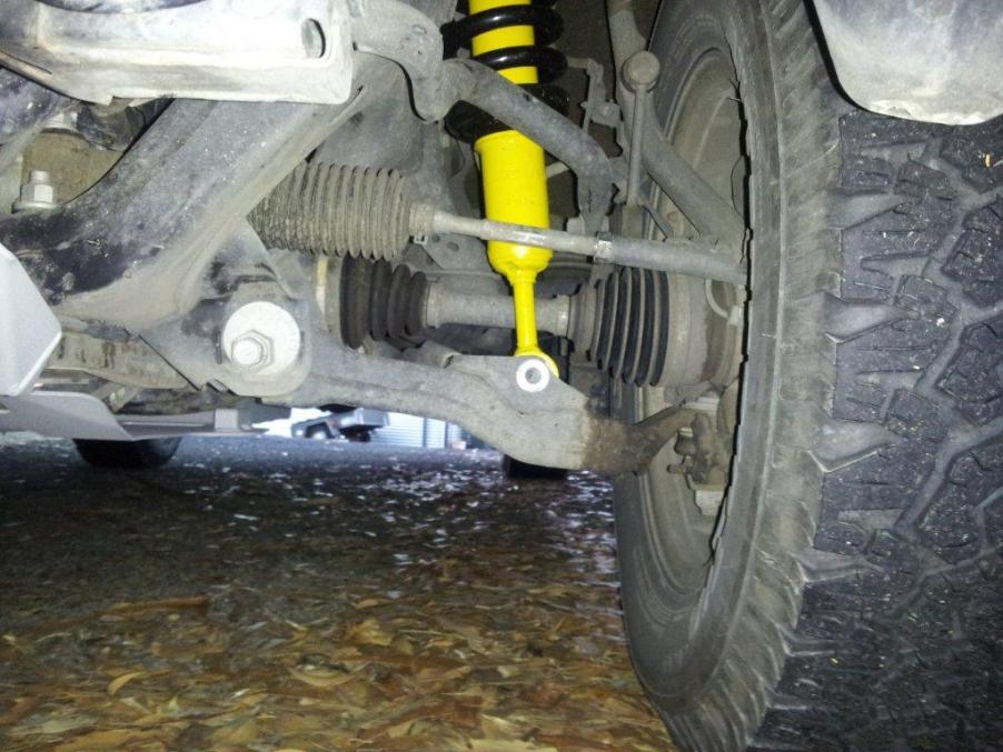

    Hey Fronty, the angle is now in the opposite direction than before the lift, as the factory setup had sagged with all my accessories, and 4 years of use. I updated my insurance cover today, and no extra charge either.
    As you can see, the angles aren't too extreme, and with 2" lift, I don't believe a diff drop is necessary either.

      Smithy, those angles look fine. In fact they're almost flat. I don't think you'll have any issues prematurely tearing boots. My original suspension has sagged so much my cv's are going up that much. Thanks for posting the pics. Really appreciate it. Cheers.

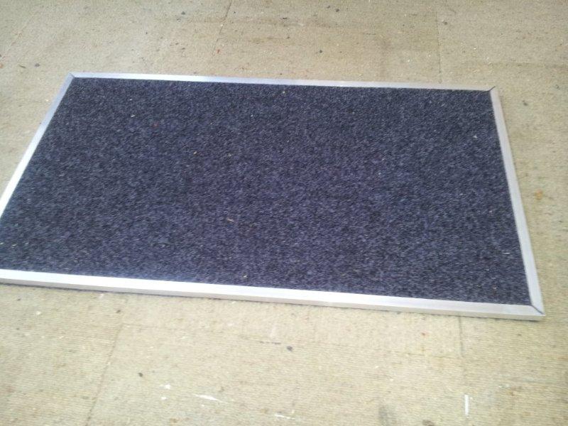

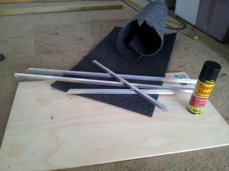

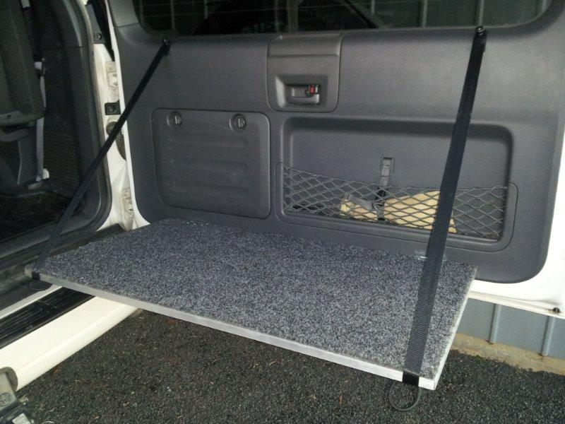

        Slowly getting organised for a rear camp table. Got half the materials (some I already had, some I had to buy) and built the table part on the weekend. Just need to source some hinges, webbing, and loopy bits for securing the table, and then I'll get into installing it. Dimensions will be 900x500 when done, using 9mm ply to minimise thickness, reinforced with aluminium channel.

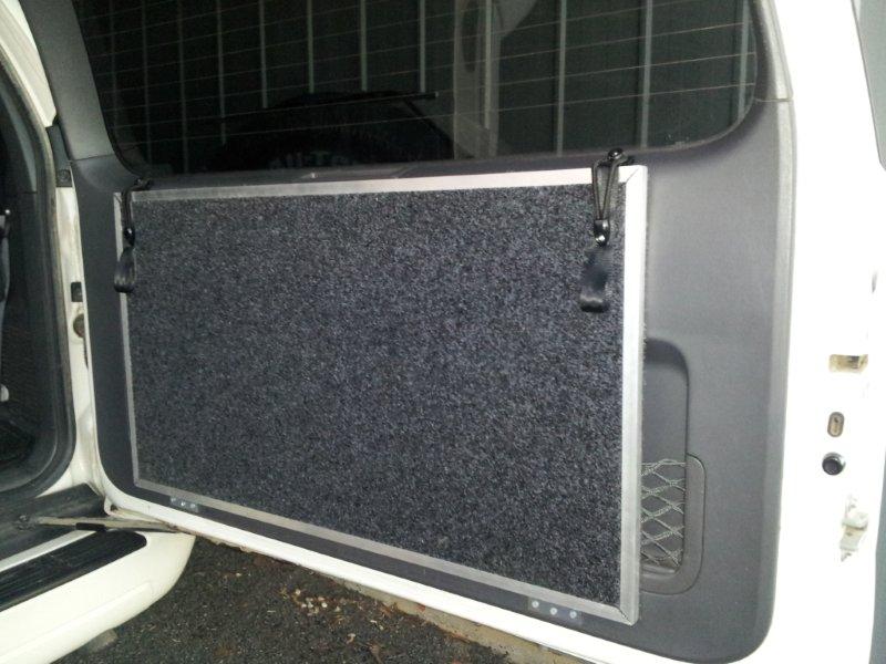

              Got around to finishing the camp table on the weekend. Very happy with the result, but did get a bit of grief from SWMBO due to coverring up the rear door catch (Prado is being used a bit as a taxi service for kids during the winter)
              The hardest part was locating where to drill for the hinges and buttons so as to contact steel, as I couldn't work out how to fully remove the rear door panel, but with a bit of guess work, I managed to achieve the required outcome.

                She will be happy when you go on a winter run, pull out the little gas burner and make her a damn hot coffee.
                Looks good.

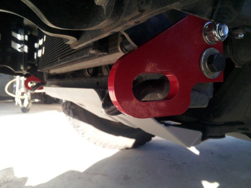

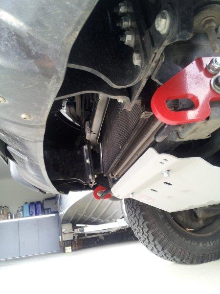

                        Recently ordered and received (thankyou mr e-bay) a pair of front recovery points, and got them on over the weekend too. What seemed like a simple job almost had me giving up, as I couldn't for the life of me work out how to remove the lower radiator bolts, but my determination to get the job done without wife and kids to distract me won over, and I finally nutted it out!
                        Waiting on receipt of another purchase - AMTS radiator protector - which will hopefully arrive today and complete my UVP requirements (for now)...

                              Glad to have them on - much safer option than the factory tie-downs, and reading some of the GTG threads, are an essential item for attendance, for safety reasons.
                              Need to test them out some time...

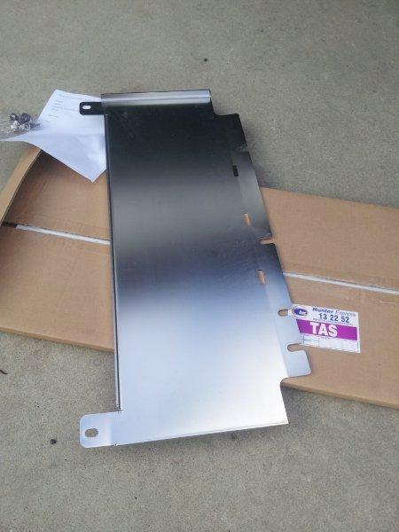

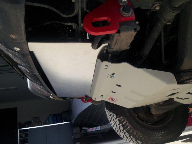

                                Received one precision engineered shiny radiator protector plate last week - Thankyou AMTS!
                                Managed to fit it on without too many dramas, which now completes the UVP requirements. Feel much safer now - Always use protection!
