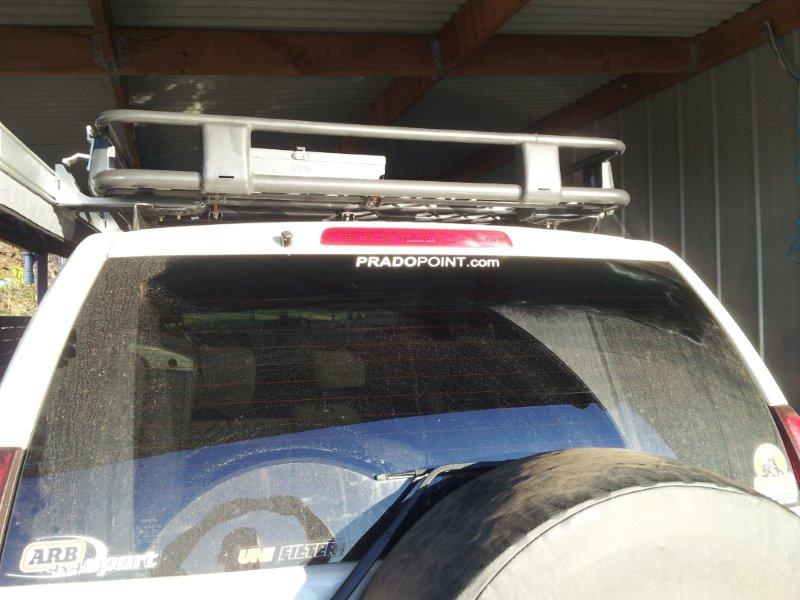

Looking good there Ben. The sticker has nearly become one of the hardest mods to get done, glad I could help out with it.
Once the weather warms up again the wekend reccies will be on, unless we do some one runs in the mean time?[B]Tasmania 2015 GTG Committee Member[/B] 2005 Prado Pilbara, Sovereign Bar, Driver & passenger weathershields, UHF TX3220, Spare wheel spaces, Lifestyle rack, Genuine front & midrow seatcovers, Genuine front & midrow rubber floor mats, ARB 47 litre fridge/freezer, Hilux washer jets, BF Goodridge A/T, Radiator protection plate, Dual battery tray and isolator, ARB 2.5m awning, Rhino heavy duty areo bars, MSA rear wheel bin, MAXTRAX

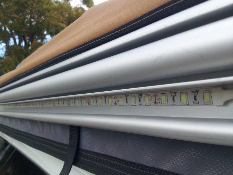

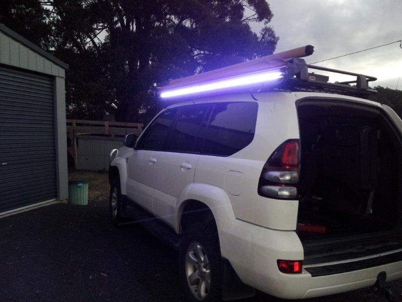

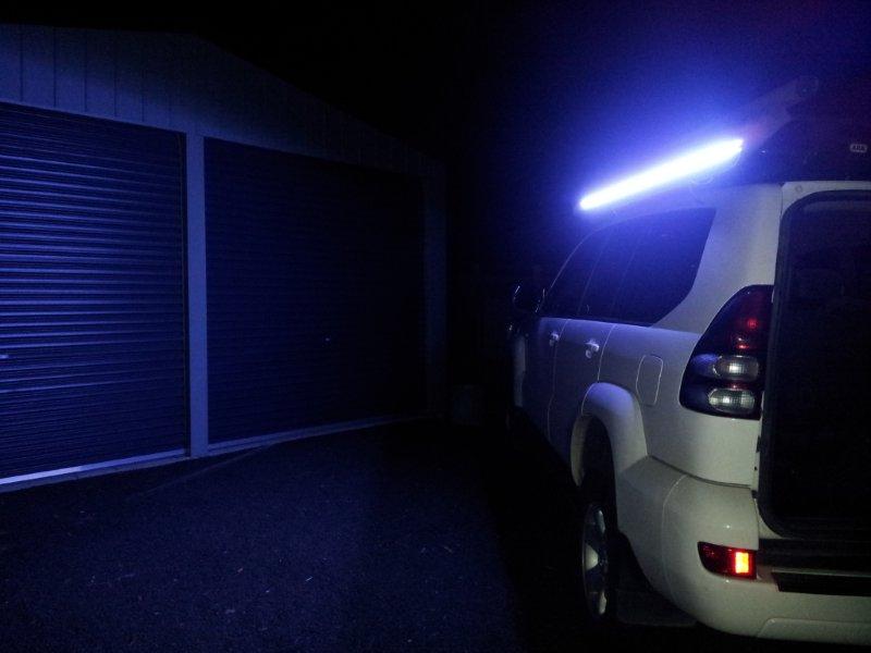

How did you ower the LED's Palmer? More pictures needed on this set up, looks bloody great. Between you and Palmer, you are costing me a small fortune after Kristy has seen what you both have.[B]Tasmania 2015 GTG Committee Member[/B] 2005 Prado Pilbara, Sovereign Bar, Driver & passenger weathershields, UHF TX3220, Spare wheel spaces, Lifestyle rack, Genuine front & midrow seatcovers, Genuine front & midrow rubber floor mats, ARB 47 litre fridge/freezer, Hilux washer jets, BF Goodridge A/T, Radiator protection plate, Dual battery tray and isolator, ARB 2.5m awning, Rhino heavy duty areo bars, MSA rear wheel bin, MAXTRAX
Keen to see how it's wired up.
I'll be calling into NorthWest OffRoad later this week to check out the Ironman plug n play LED awning light kit that they are getting in. Retailing for $35, so I might be going the quick and easy option and just getting the kit (had planned to get all the bits and wire it myself, but I won't have the time to do it before we leave).
Originally posted by Palmer View PostKeen to see how it's wired up.
I put a small fuse bank into the lhs rear quarter just near the jack. Already had power there from when i wired in the fridge power and spare accessory. I have put a switch inside the rear door to keep it out of the weather, and run the wires through the lhs taillight then up to the rack next to the rear door seal. Had to drill a hole in the awning to poke the wires through, but all good. Looking for a replacement switch though as the one i have used isn't seating properly.Last edited by Smithy - 120 D4D; 18-07-2013, 01:12 PM.2009 White KDJ120R Manual fitted out for family camping and touring - See my Rig Build at [url]http://www.pradopoint.com/showthread.php?27887-Smithy-s-Rig-Build[/url]
