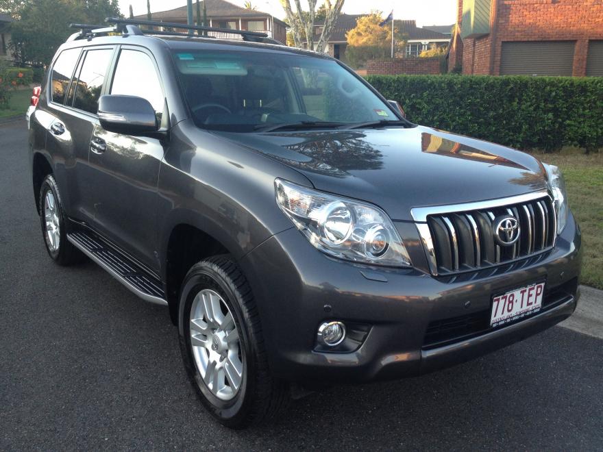

    The day I picked her up.Click image for larger version

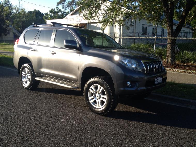

      2" lift and BFGs Click image for larger version

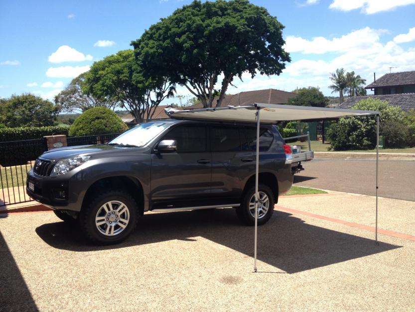

        New oztrail awning. Click image for larger version

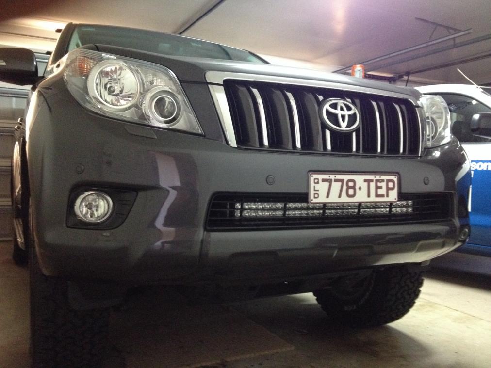

          Rigid industries light bar installed Click image for larger version

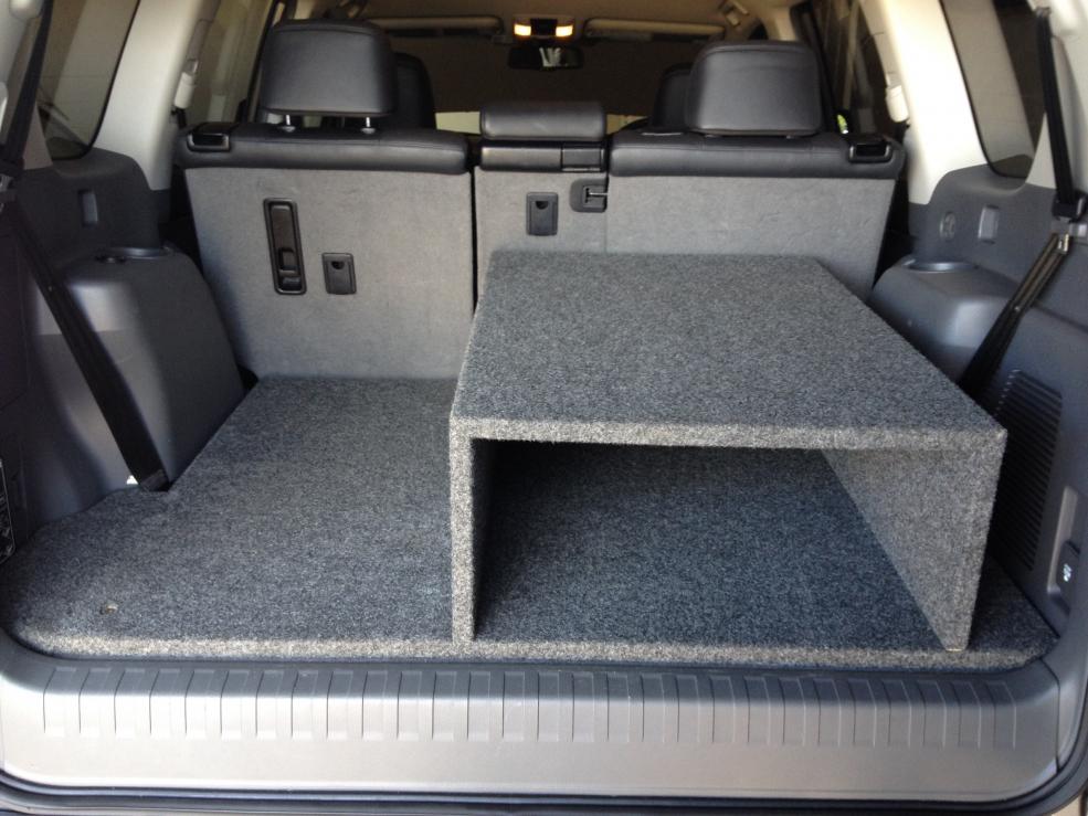

            Rear shelf built for fridge. Attaches to tie down points in back of seats. No drilling required Click image for larger version

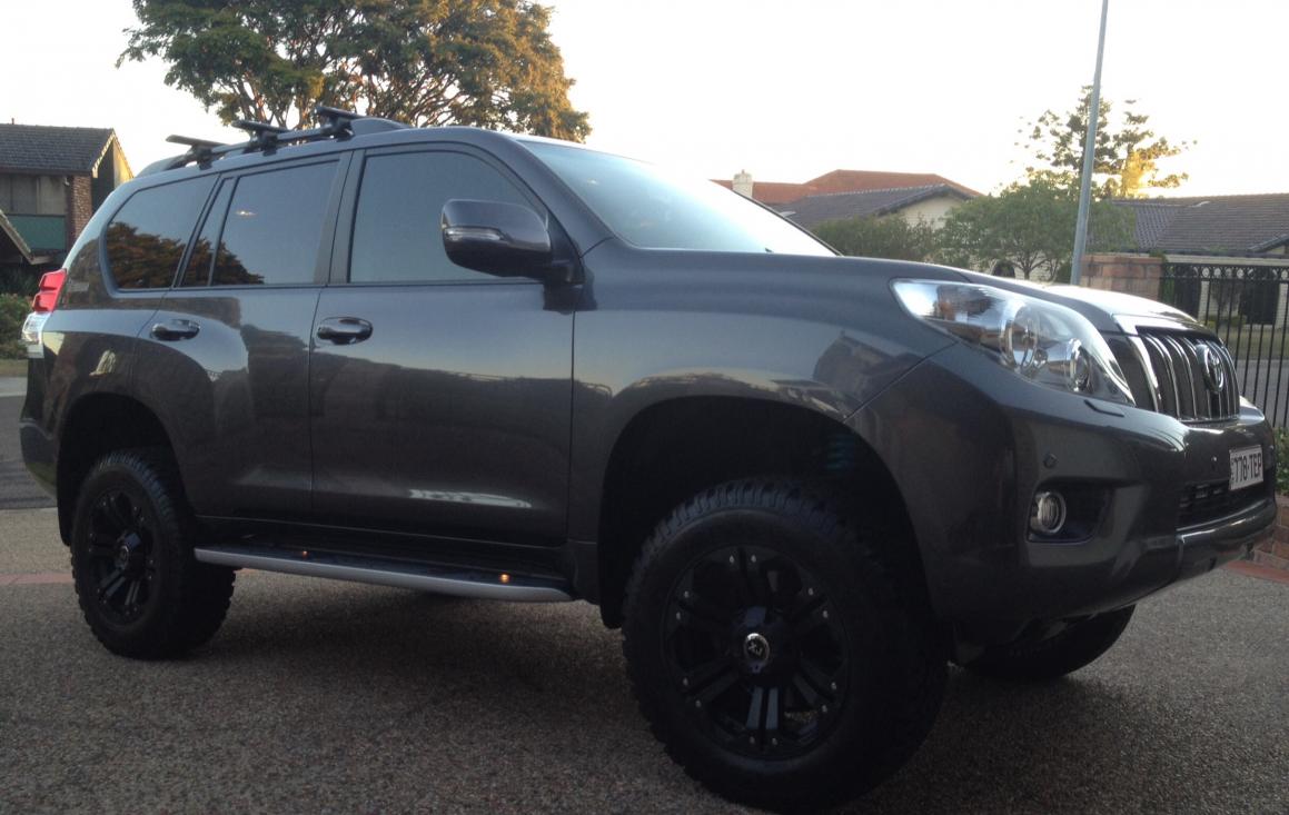

                Koya 18" matte black wheels to give her the stealth look. Click image for larger version

                  looking good mate!
                    Looks good mate, a V6 for something different. cool. welcome to the group
                      Yeah the black wheels look mint!

                        Good stuff Brendo! Is the rear shelf removable?
                          Yes it is spike69. I have mounted it to the 4 tie down channels that are in the back of the 3rd row seats. I countersunk 4 holes that line up with these channels and used 4 x m8 bolts that mount into 4 x m8 nut inserts in this channel. The 18mm base allows me to screw my fridge and slide directly to the floor without going into the back of the seats within 1-2 mins so easy to put the fridge in and out. The only downfall with my design is the shelf in the right of the picture is screwed in place from underneath the 18mm base. It is a pain in the neck to get to and needs to be removed to get the rest of the base out. I'm going to use aluminium angle to fix it from the top side for ease of removal soon. I used the rubber cargo mat as a template but just went around 5mm in from all edges to avoid rubbing on the rear plastic trims on the sides. It's a snug fit but looks really neat and even goes around the rear seat belts on the floor like the mat. Only cost around $160 to make and works a treat. I Might incorporate a drawer into the shelf In the near future but not worried for now. Make sure you measure the shelf so you can fit your beer cartons in there. That's what I did.

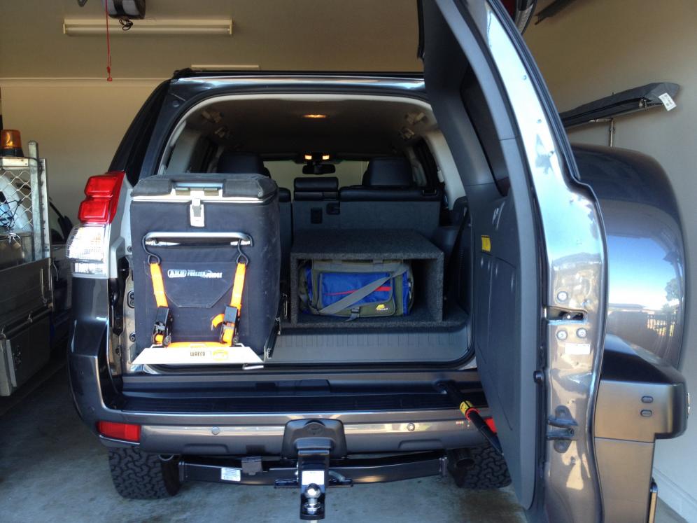

                            Here is another picture of the shelf for you.
