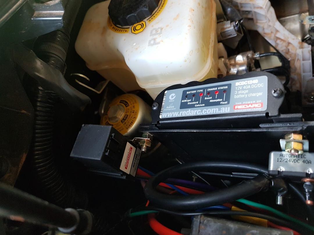

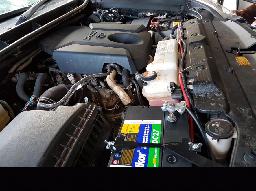

        Finally got around to install the dual battery system utilising a Piranha battery tray, Redarc 1240 LV and a 240watt folding solar panel. Spent a little time to weld up a bracket to hold the Redarc and allow airflow around the unit behind the air filter.
        Solar charging works a mint and now just have to decide on a fridge for the back.
