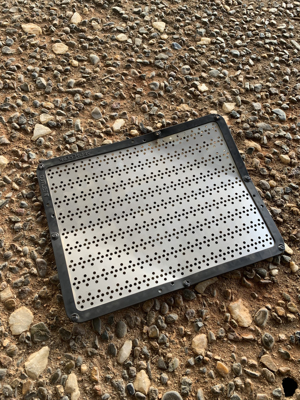

        I pulled this piece of junk from my air box today.
        https://i.postimg.cc/cHBLN8ZY/IMG-0625.jpg
        Also noticed in this video from the UK the air box lid does not have one installed.
        https://www.youtube.com/watch?v=G9ICWB5wXnY
        A simply pry with a large flat tip screwdriver does the trick. Once its done it can't be undone.
        A very slight gain in accelerator response and feels a little less of an effort to drive. It all adds up.
        Up to you, just thought id share. Would I do it again? yep.
          What’s it meant to even do ? Help filter again some how ?
          Never seen anything in a airbox like that other then in the new prados..
            No idea mate. Mine does nothing now.
            I just drove the car again, RIP IT OUT!
