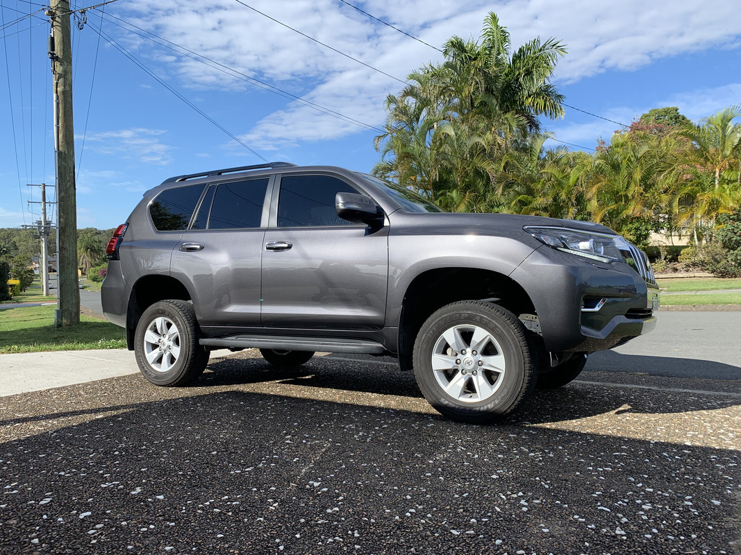

          Prado after Fox 2.0 and Kings lift
          Front height from bottom of rim to bottom of guard: 815mm
          Rear height from bottom of rim to bottom of guard fuel tank almost empty: 840mm
          Rear height from bottom of rim to bottom of guard fuel tank full: 830mm
                Looks a bit too high in the front mate. I guess a bar, lights, bash plates etc. will bring it down a bit.

                    Juz, thanks for the feedback mate. Do you mean high in the front compared to the back? Or just high in the front in general? I know everything about Hilux’s but not much about Prado’s. thanks in advance.
                      For a 2 inch lift, you want the front to sit around 790-800mm.
                        Cheers mate. The front struts are adjustable so it might just need to be adjusted down a bit. I told the installer that with a full tank of fuel I want the front and rear to be only around 20mm difference. He didn’t tell me that he had any issues with the wheel alinement. I have not seen any unusual tyre wear but the suspension has only been on the for about 10,000ks
                        ill do some research and keep an eye on it. Thanks again.

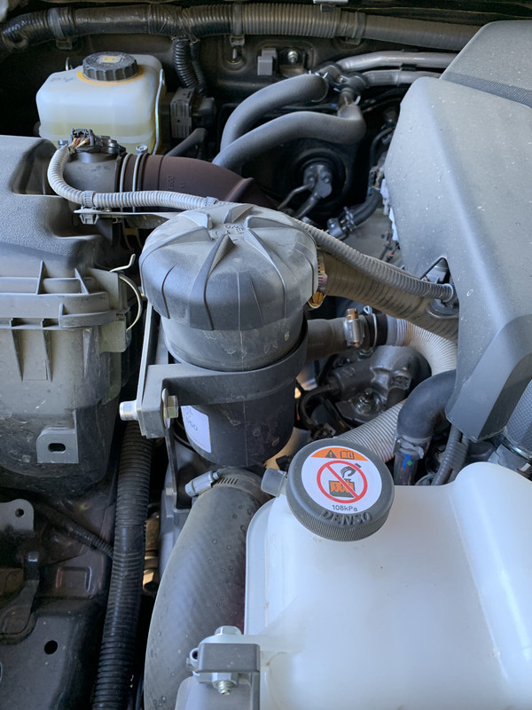

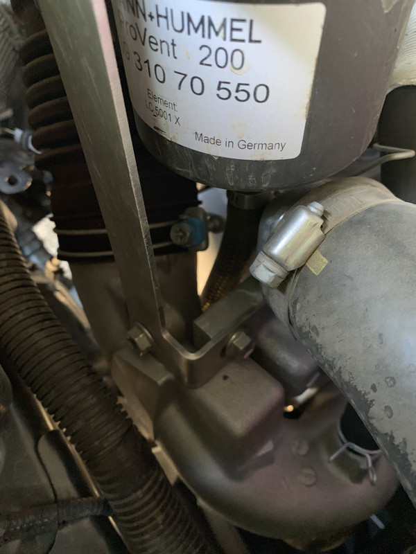

                          Hey Mate,
                          thank for posting.
                          Wich Oil Catch Can did you install? Do you have maybe a picture from the install spot? I have a little trouble fitting my Westernfilters Kit but maybe the European GDJ engine is a little different. So it would be very nice if you can make a picture.
                          Lg
                            Provent Oil Catch Can Install from Western Filters

                              How many km on your car ? Have you drained it yet ?
                              i really want to do this to my car.. but I’m afraid if anything happens and Toyota tries to blame the catch can or secondary fuel filter and refuse a warranty claim
