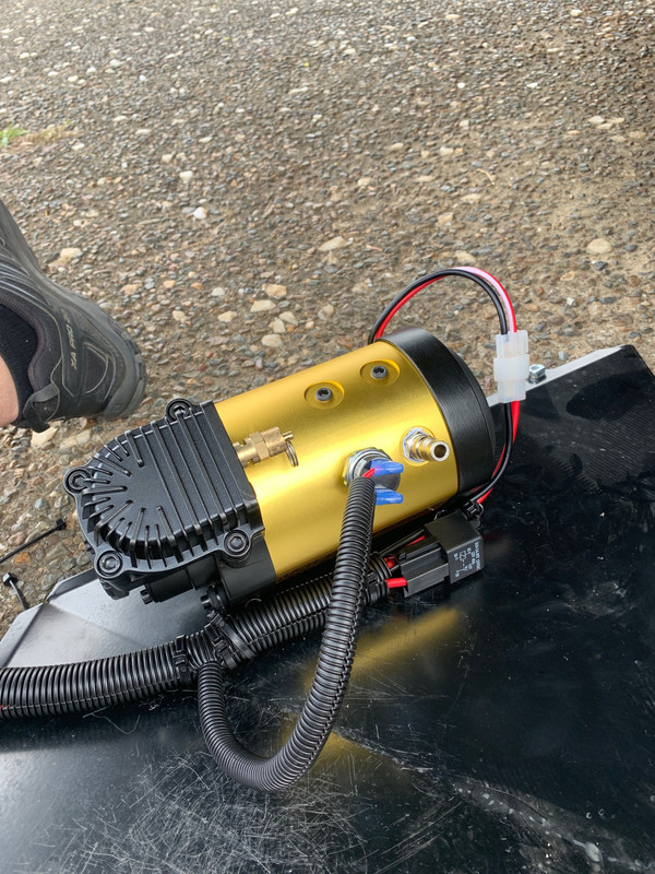

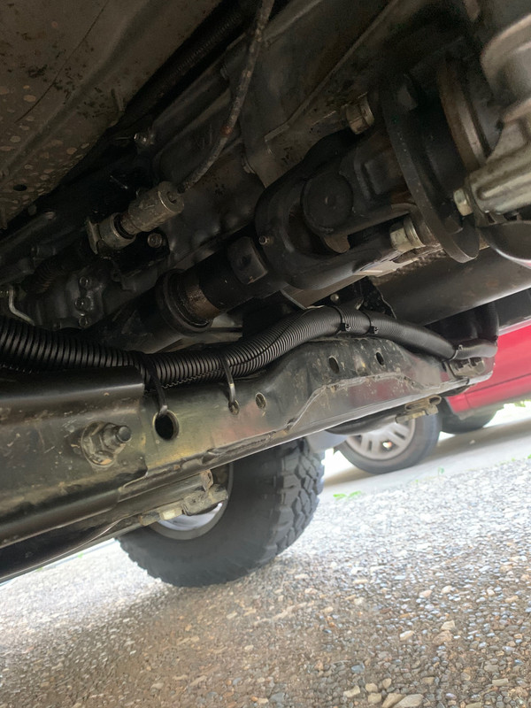

              TJM HD compressor installed. After much deliberation I installed it high as possible to the left splash guard on the ARB bull bar. I then ran a 10mm air line and nitto fittings and installed a tee fitting to run air to both sides right between the two tyres. Thus only needing to carry a small hose to air up. Used a Stedi switch and it looks at home with the factory Toyota gear.
              photos to follow.

                  My concern would be water related, not only the obvious creek or river crossing but how protected the air inlet would be in some of the rain events we get.
                  I was surprised at how wet everything was behind my ARB Summit bar after the last lot of rain, the reason I looked was my front sensors were on constantly after hitting decent water on the road. Have you fitted a remote air intake?
                  Lee
                  • #99
                    I had given the water issue a thought however I just can’t think of anywhere else to install it. I created I post and ask but I got no responses. I might have to make a splash guard around it.
                    i think a remote air intake my be a must do as well.
