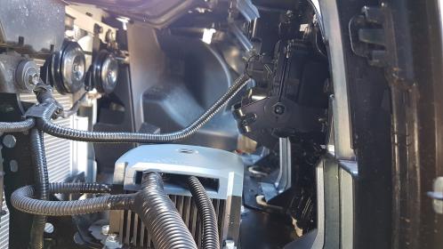

            Dual battery fitted, sits on a Piranha tray.
            Charger is an Intervolt DCC Pro which is mounted behind the grill.
            The Intervolt comes with a remote display unit which is used for setup and displays the main/aux voltage and aux charging rate.
            A 6B&S cable runs to a rear fuse box which is tucked away inside the box above the jack.
            The fuse box will be used mainly for fridge and lighting.

                    Builds looking good mate, would like to hear your feedback in the future regarding the inter volt dcdc,
                    what size circuit breakers are those?
                    I have a 70amp breaker running 6b&s to the rear with a fridge running straight off it from the aux battery.. I currently just take out the battery and charge it on the mains as I only need the fridge when we go on trips and also no money for a dcdc currently
                    with the fuse block do you just tap in to the positive and neg off the 6b&s ? And then just run smaller wiring to the other accessories ?? What size wiring and fuse would be adequate for a 50l fridge?
                    sorry I havnt wired up a car before this is the first one I’ve done just seeing how others have done it ?
                    and are you just running the earth back to the battery too? I have what a mission running those huge twin core through the grommet in the engine bay
                        50A each, one is to the Intervolt and one to the rear fuse block, both with 6B&S.
                        Only the +ve 6B&S to the fuse block. The fuse block is earthed to a point inside the hole where the jack lives.
                        All smaller wiring from the fuse block for LED lights uses 7.5A figure 8 cable, as they will only draw 1 or 2 amps each.
                        For the fridge I bought a spare 12V cable with plug and am going to hardwire it directly to the fuse block. When not in use it will fold up inside the fuse block compartment. That will save having to create a 12V socket to plug the fridge into. I had a 12V cigi socket on the old car and used 15A figure 8 cable.
                        That would be a mission! I put all my cable in split loom tubing and ran underneath the car, zip tied right up out the way, much easier. There is a grommet in the rear floor just near the jack well where you can route it into the cabin.
