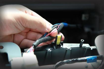

                      • Reverse camera worked no worries after reverse trigger wire was tapped, for me it was this red wire in the loom to the fuel computer. There are 2 red wires, but the other one joins up with 2 others, this one is solo all the way down the loom. Can't say the image looks amazing on screen, but it's on par with the front camera, which also worked no worries.
