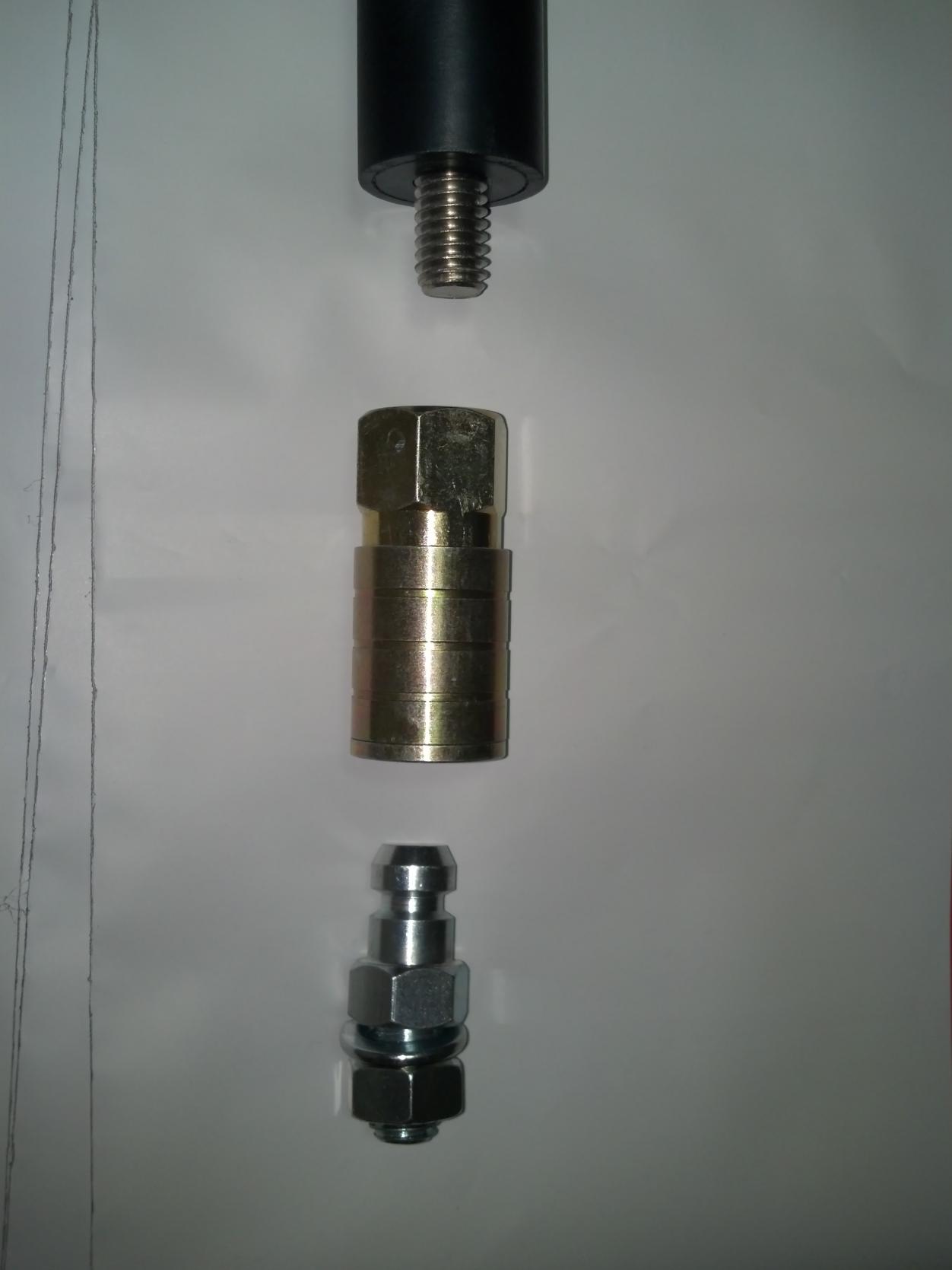

      Here is what the base of the telescopic pole looks like. It is the same quick release fitting as used on the sand flags.

        • Hi Stuart,
          Yes it can be retrofitted but there will be welding involved so the anodising around that area will be affected.
          What you need is to turn up an ally plug which will be an interference fit to the tube. You then need to tap this plug with a 1/2" BSW thread. When you insert the plug, it will cover up the existing cable entry hole in the tube. Weld through this hole to permanently secure the plug in place. Then drill a new hole higher up for the cable entry. The inner pole will now be too long and the bottom of it will need to be lopped off. I can then supply you with the quick release coupling and the 1/2" BSW stainless threaded bar to complete the assembly.

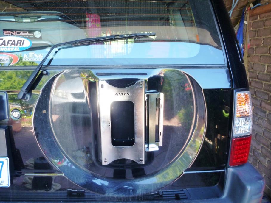

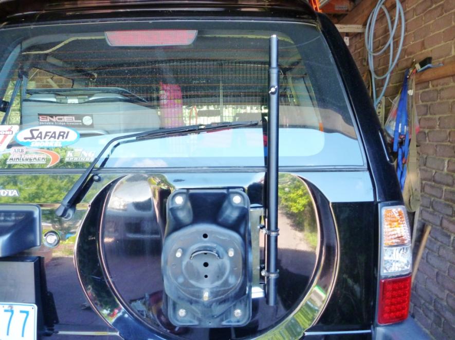

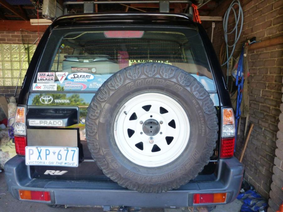

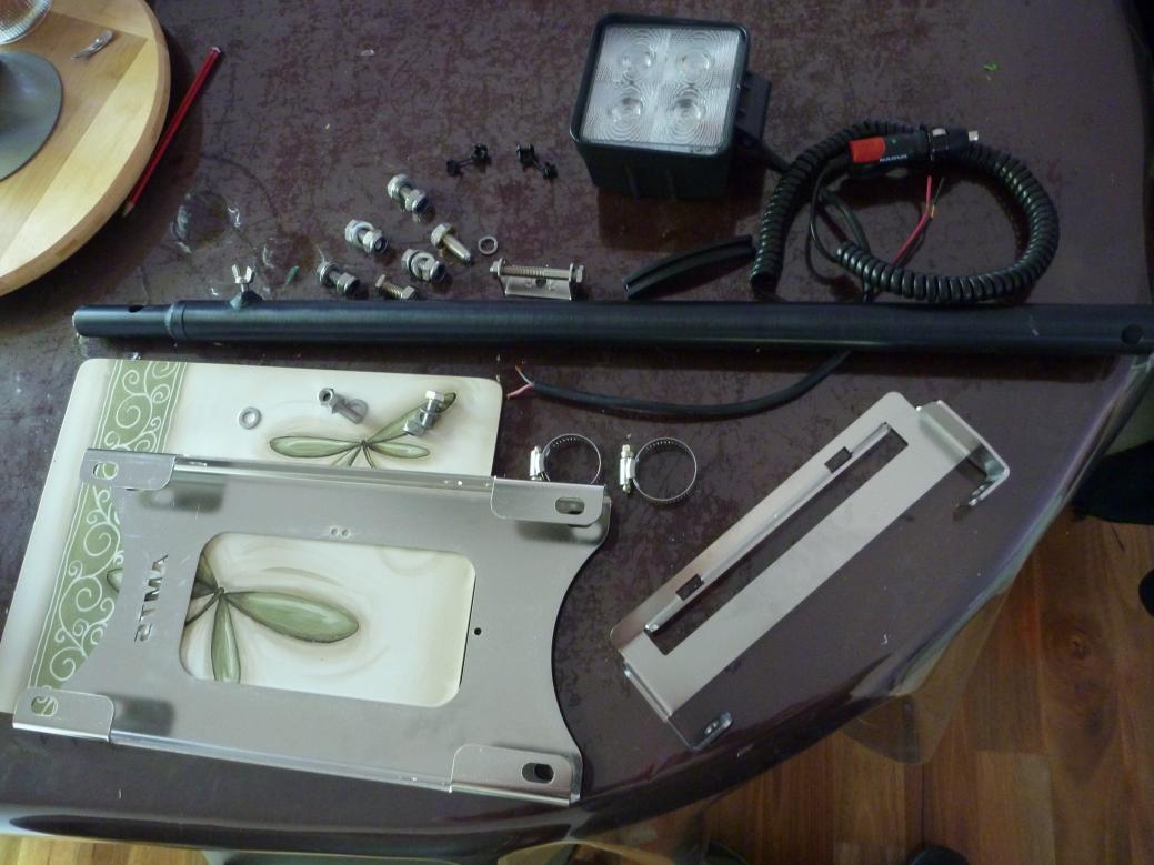

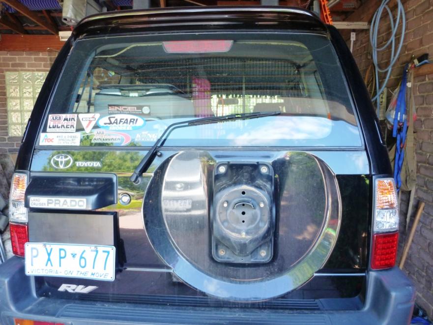

              • Hey Andrew, I got the parcel on Friday. I thought I would try and start the fitting today. I thought I would post a few photos of the fitting for you.
                Here is the kit and the back of my 90 Series.
                Dave.
                90 series prado with lots of stuff.

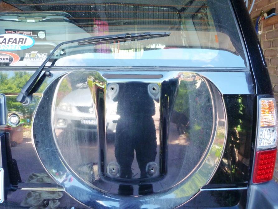

                • Now that it it is all removed now for the install.

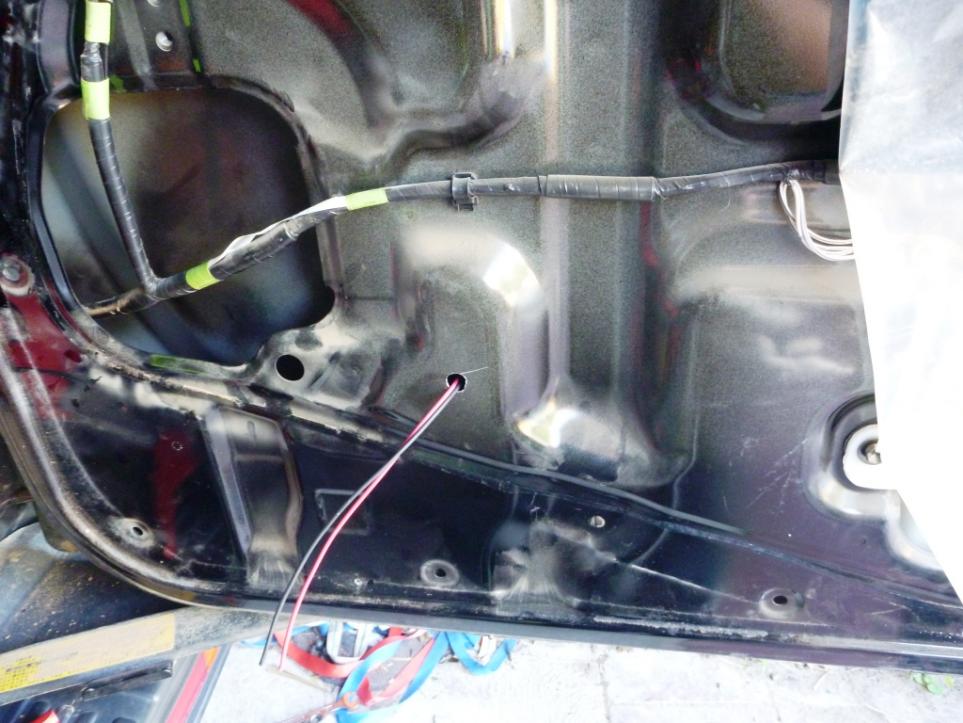

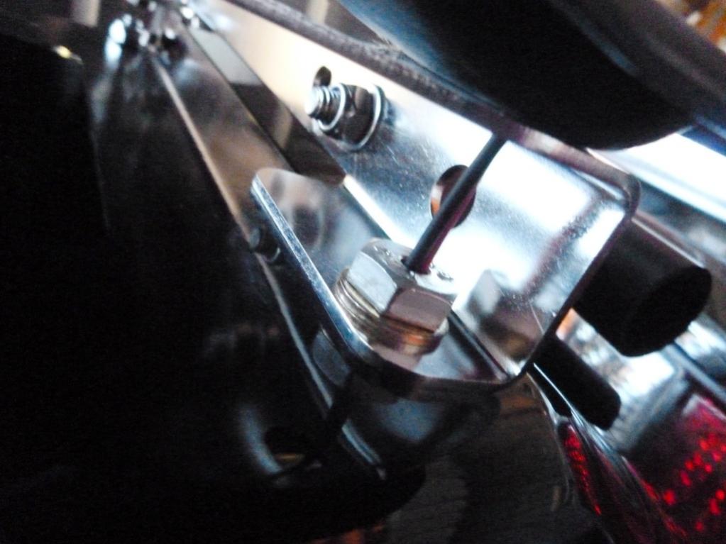

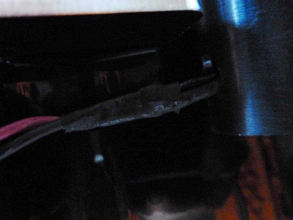

                  • The wiring was a little interesting as I needed to drill a hole in the back door to be able to get too the wires coming through the bolt that is provided.

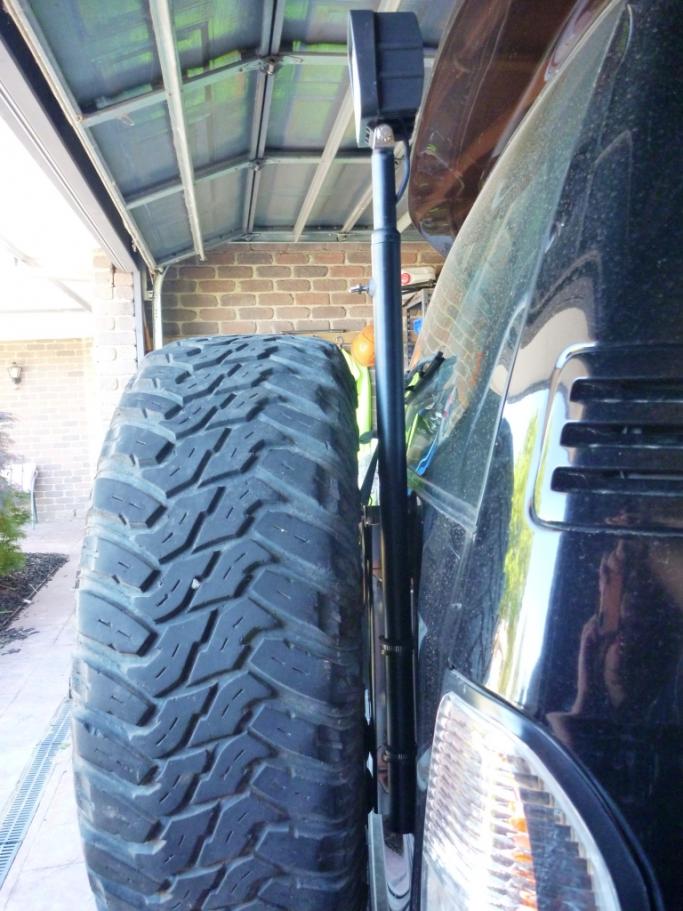

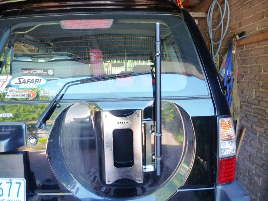

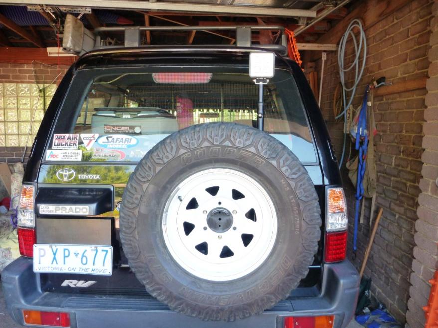

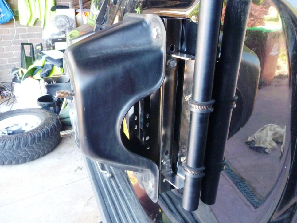

                    • And now the final finish. Looks good and the extendable pole give some good height. I have wired it all the way to the dash just need to wire up the switch tomorrow and it will be complete.
                      Thanks AMTS

                          A tip for the install is to mount the spacer and run some wiring through the supplied bolt with hole in one hit. Also make sure that the way you terminate the wiring through the door allows the spacer to be removed for crash repair purposes.
                          • Good tip Amts, that's one thing I didn't think of when I hard wired my light. Lucky I'm off to Jaycar this morning to pick up connectors for another job.
                              From memory, I used blue bullet crimp terminals just inside the door as the terminals are small enough to pass through the tapped hole in the door.

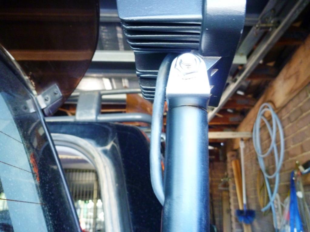

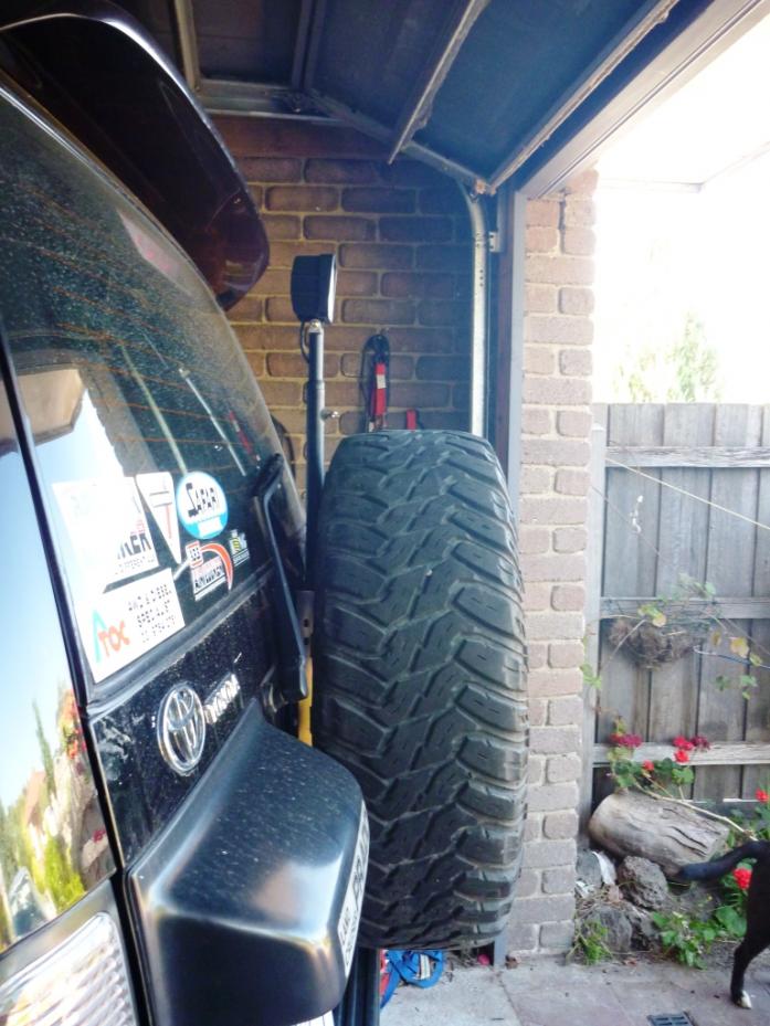

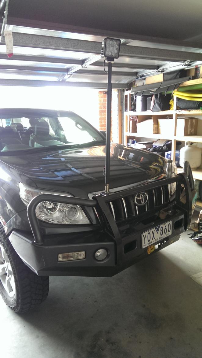

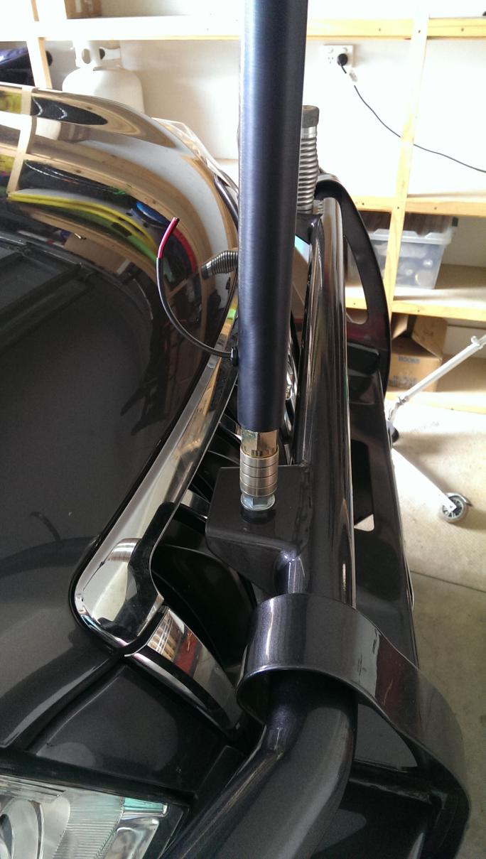

                              • Front light in action, little bit of wiring to finish off.
Name:	prado front light.jpg
ID:	645978 Click image for larger version
Name:	Prado Front Light 2.jpg
                                Good quality, bit of play in the quick release but to be expected.
                                Quick spin, starts to shack badly @ ~60KM/h but settle down @ 100KM/h and above. Would not recommend turning light on while driving as it can spin around and shine in your eyes (not good @ high speed).
                                Bernie.
