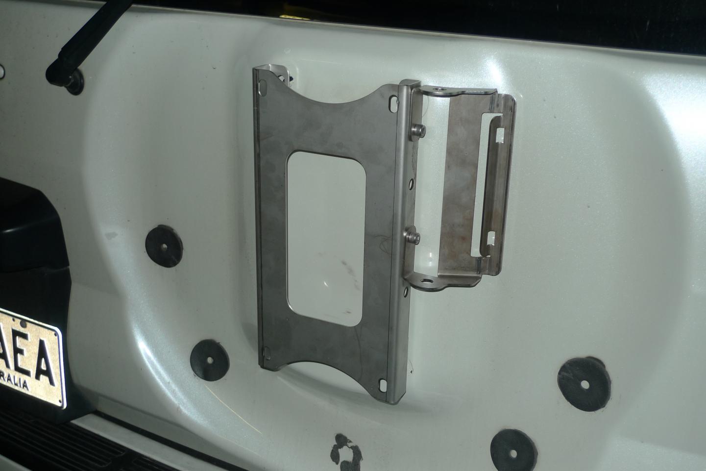

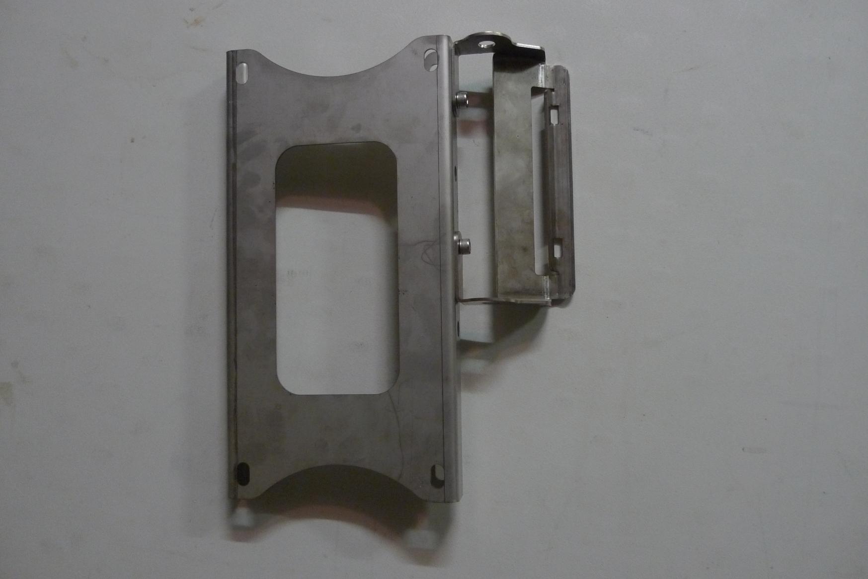

        Picked up the main bracket today and quickly put it together on the Prado. Some tweaks are needed on the main bracket to get some consistency. The light pole bracket will be slightly longer to match the tooling. The last thing is to work out the finish to hide all the tooling marks and it's done for the 120. The 95 and 150 door is slightly different and needs a different angle for the light pole bracket.

        • #64
          Looks great, keep up the good work Andrew, happy to wait a little longer.
          Maybe drop the development of the 90 / 120 mount and work on the 150 mount a little more......
          How about starting a "Pre order" list? ;-)
          Bernie.

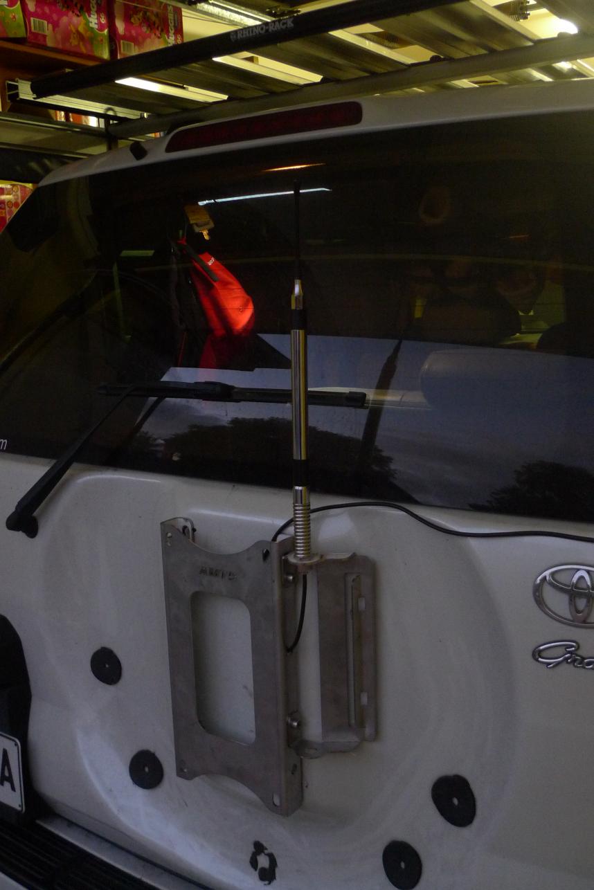

                    The 2nd prototype has been tested and the pic of it is shown here. The holes aren't quite lining up so a tweak to the folding program is required. 3rd prototype should be done mid next week.
                    The 1st prototype has been given to the glass bead cleaning company and they will do a sample and provide pricing.
                    The pic shown is with the antenna tab on the light pole bracket. Unfortunately, it is too close to the tyre so this tab will be deleted on the final run.

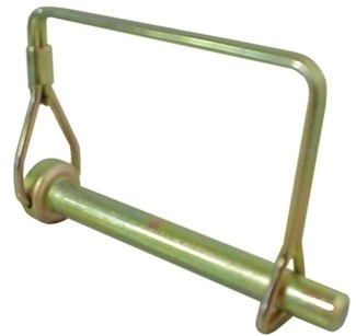

                        • #72
                          The Pin !!
                          Also, this would allow us to use a padlock if required to protect our purchase of lights.
