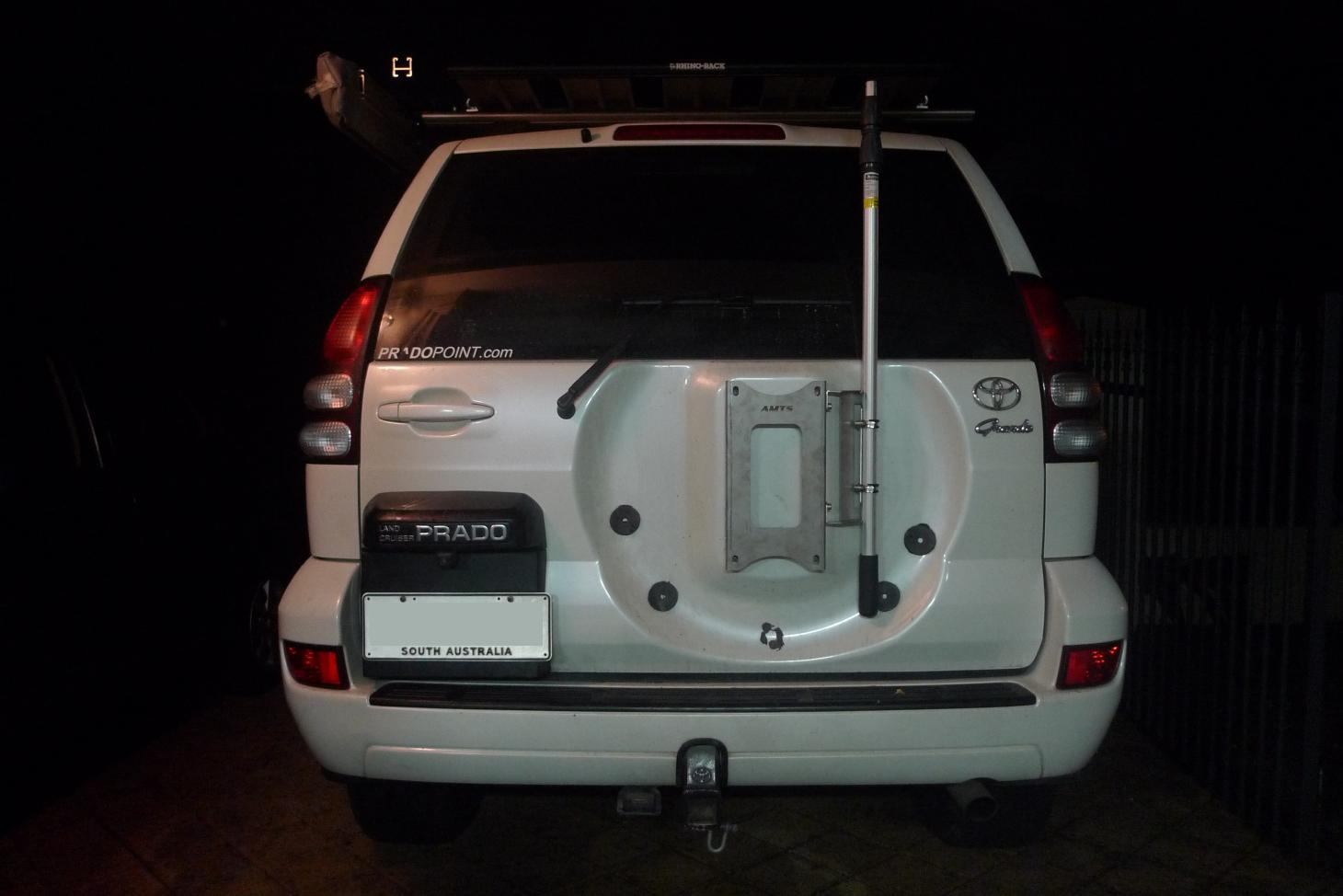

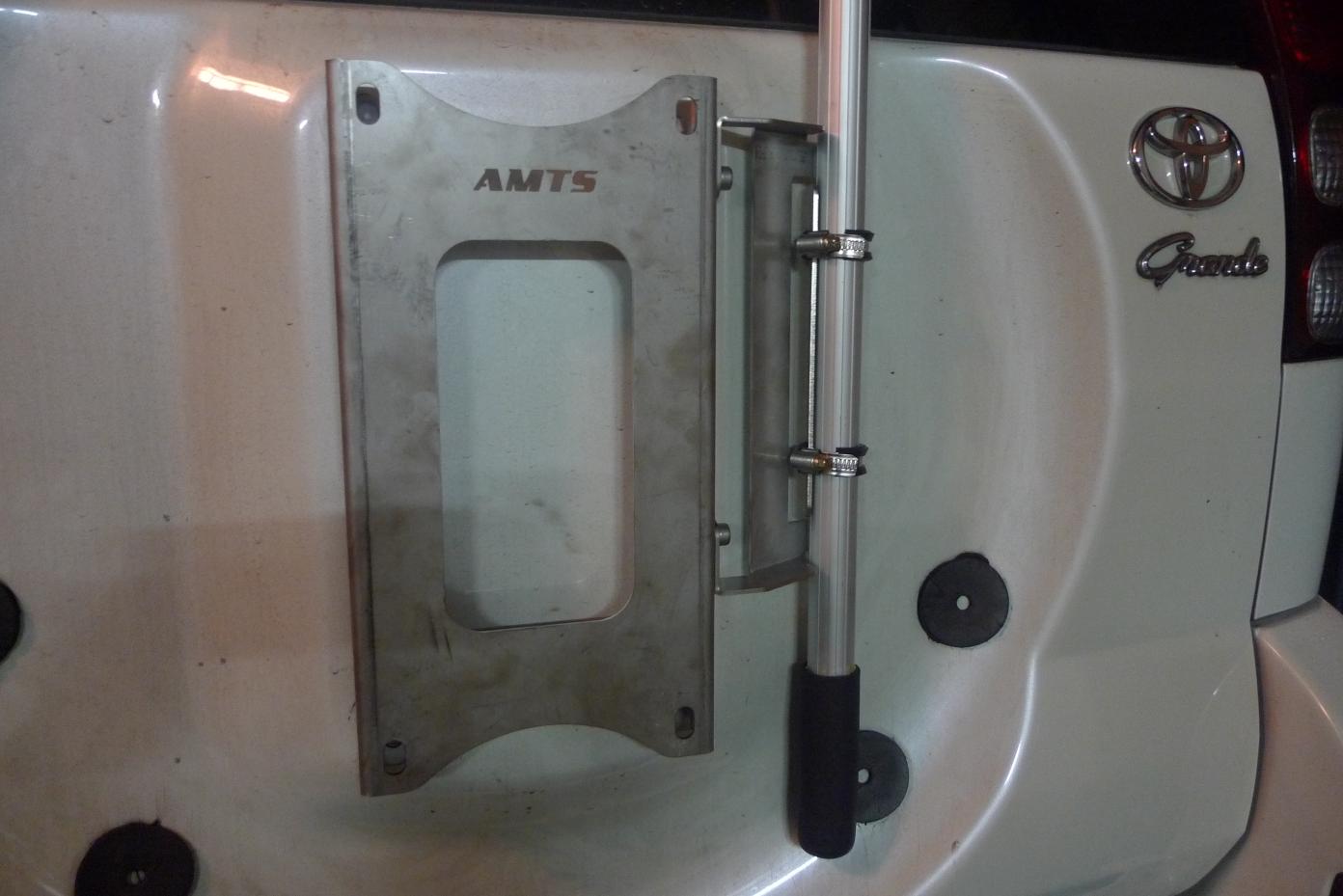

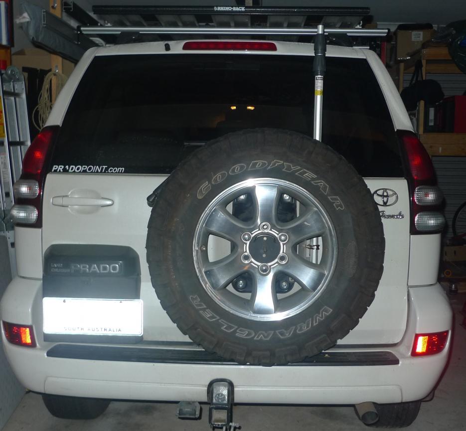

      Here are pics of the final prototype
      Pole attached to bracket

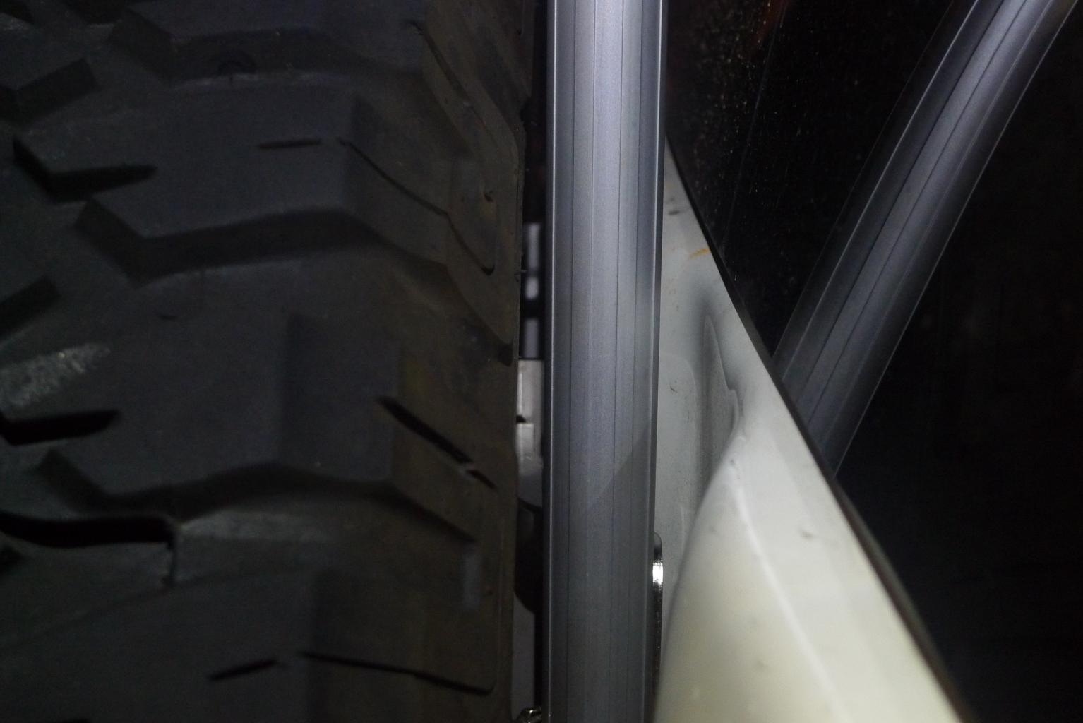

      Gap with 265/70R17 Wrangler MTR

          Jokes, they look great, amts.
          I like the little laser cut logo too

            Didn't think anyone would notice, wooley. Pity you can't see it once everything goes on.

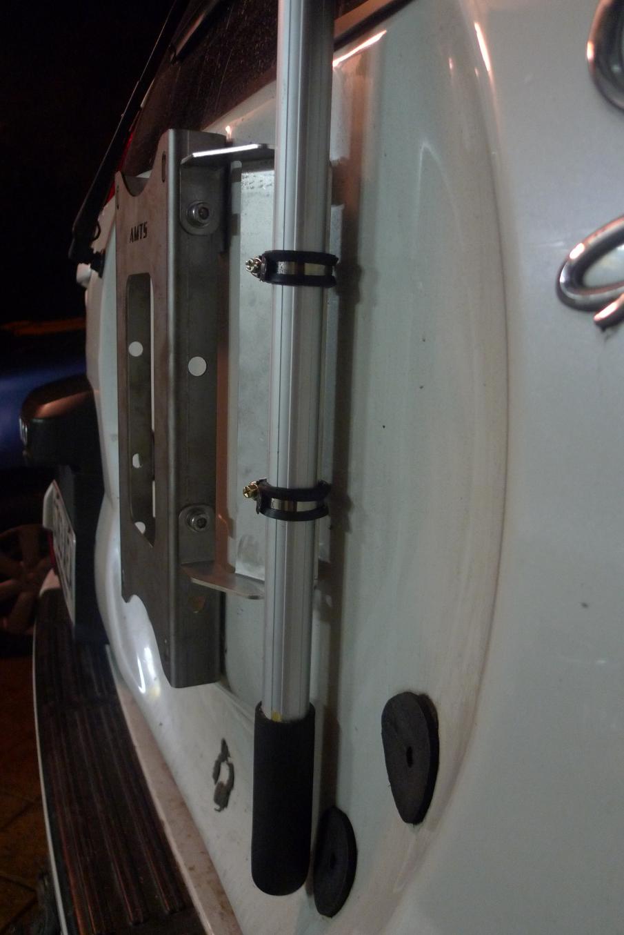

                    Can you please if possible take a photo close up of how the pole is mounted?
                    If you look at the first picture of your previous post, can you take another close up of the poll mount from the same angle?
                    or if the resolution is good, can you just zoom in and upload another shot of it from that shot?

                      Just so happens I took the pole off today in preparation for getting it cut slightly shorter and to put some extra electrical tape on the inner tube as the pole rattles a bit. I put another round of electrical tape about 1/3rd of the way up on the inner tube and this has eliminated most of the rattles.
                      But I did manage to take a closer pic yesterday when the pole was fitted.

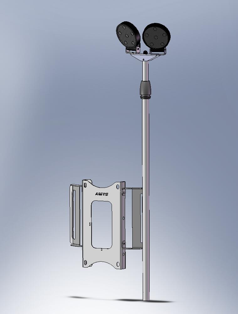

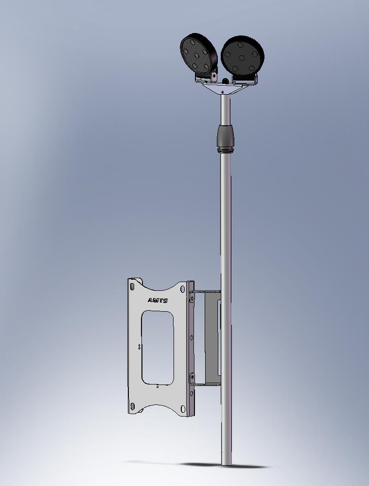

                      And this is hopefully what it will turn out to be for a twin head LED work light. Hope to pick up the T-piece from the fabricator soon.

                        possible to mount one of those pole holders on each side of it, amts?
                        so you can mount two aerials? or aerials and other things.

                          Here you go

                            perfect... how about a third bracket for a third aerial, light, 50 cal?
