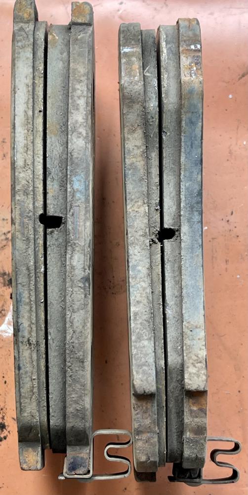

    I was inspecting the rear brakes trying to find the source of the squeal only when reversing. From the inspection port, I can still see the groove in the brake pads but upon dismantling the calipers, I found that the pads have uneven wear - thin on one end, thick on the other. Similar to this photo
    So the caliper pins needs a clean and regrease. Any recommendations on the correct grease to use?

                  Needed to replace my rear Prado 150 brake pads after 110k due to uneven wear on both sides. The guide pins were free to move although new grease seem to allow more easy movement. Interesting the worn pads on both sides were the ones without the wear guide, not very helpful. Replaced with Bendix SUV pads which came with their own anti-noise plates so did not need the factory ones.
                  So it looks like the factory guide pin grease did not go the distance and maybe needs to be replaced before the pads wear out? Easy enough to do, 5-minute job, cheaper than the $100 pads.
