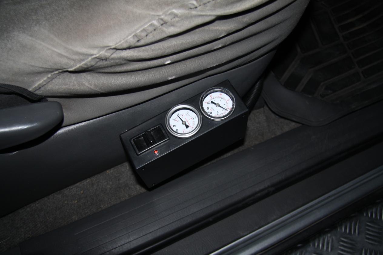

                          • Finished off a couple of projects, plumbed the polyairs to a gauge and control valve fed from the endless air to save time hooking the camper up on trips. Added a hobbs switch to activate a red led if the pressure drops below 5 psi.
                            I used a cheap ebay regulator and filter for the supply, limiting the pressure to around 50 psi. For the control valve I used an AOB paddle valve http://tinyurl.com/jxnuo5g
                            Easy now to hook up the trailer and not have to unscrew the schrader valve caps and inflate the bags, can all be done from in the cab.
